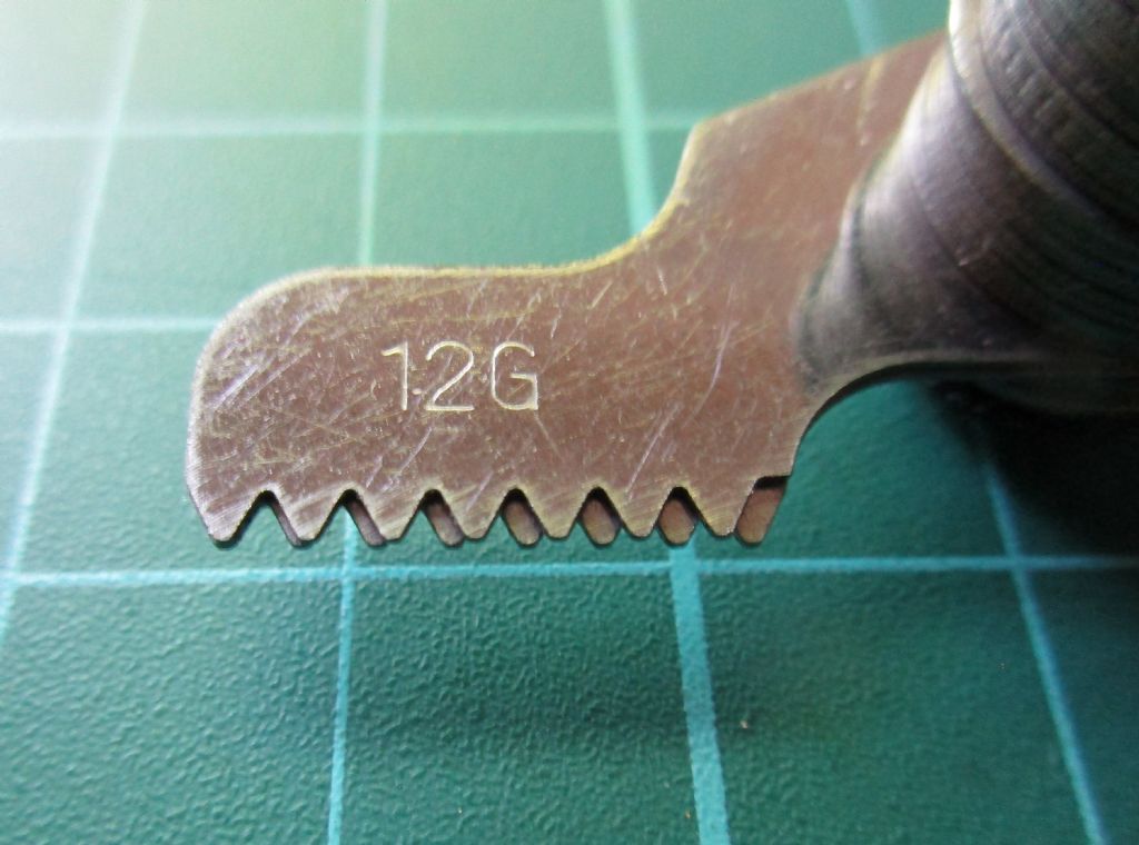

      I have a thread gauge whose Whitworth section has a thread designated 13G. What is this? I can't find any reference to it in tables of Whitworth gauge.

                              The OP doesn't say the gauge is 13tpi. The letter G usually refers to BSPP threads. Sometimes the nominal imperial size is approximated in millimetres. So I expect the gauge is for 1/2" BSPP. May be the OP can tell us if the gauge is 14tpi?

                                On Chinese-made thread pitch gauges the letter G seems to have been substituted for TPI in recent times. A sort of metrification perhaps in that it does not refer to the dreaded inches? It does not seem to refer to BSPP as the gauges come in a full range of TPI's for all threads, not just BSPP.
                                But I see on googling around that German made Whitworth thread pitch gauges are marked G also, perhaps from as pointed out above in reference to the German word for thread which starts with a G.  Link
                                Maybe the Chinese just followed suit?

                                    Hi, my M&W thread gauges don't have a G on them, but they do have thread sizes that each one is associated with and there is a 13 one in the set, but no thread size is given.
                                    As far as a 13 one being the same as a 12 on cheap gauge sets, it certainly isn't for a couple of cheapies that I have which are probably made somewhere in China, but when compared to my M&W set, no difference can be determined by eye and match up very snugly.

                                            I have a thread gauge (bought in 1959) that has 'Whitworth 55deg' stamped into the side plate. the 26 different blades (4 to 62TPI) all have 'G' after the number.
                                            As an example 12 TPI is marked 12G 1/2 9/16 but 13 TPI just has 13G (no diameter/s) as have 19G, 22G, 25G, 26G, 28G, 30G, 62G
                                            I'm not sure what the G means at all really
