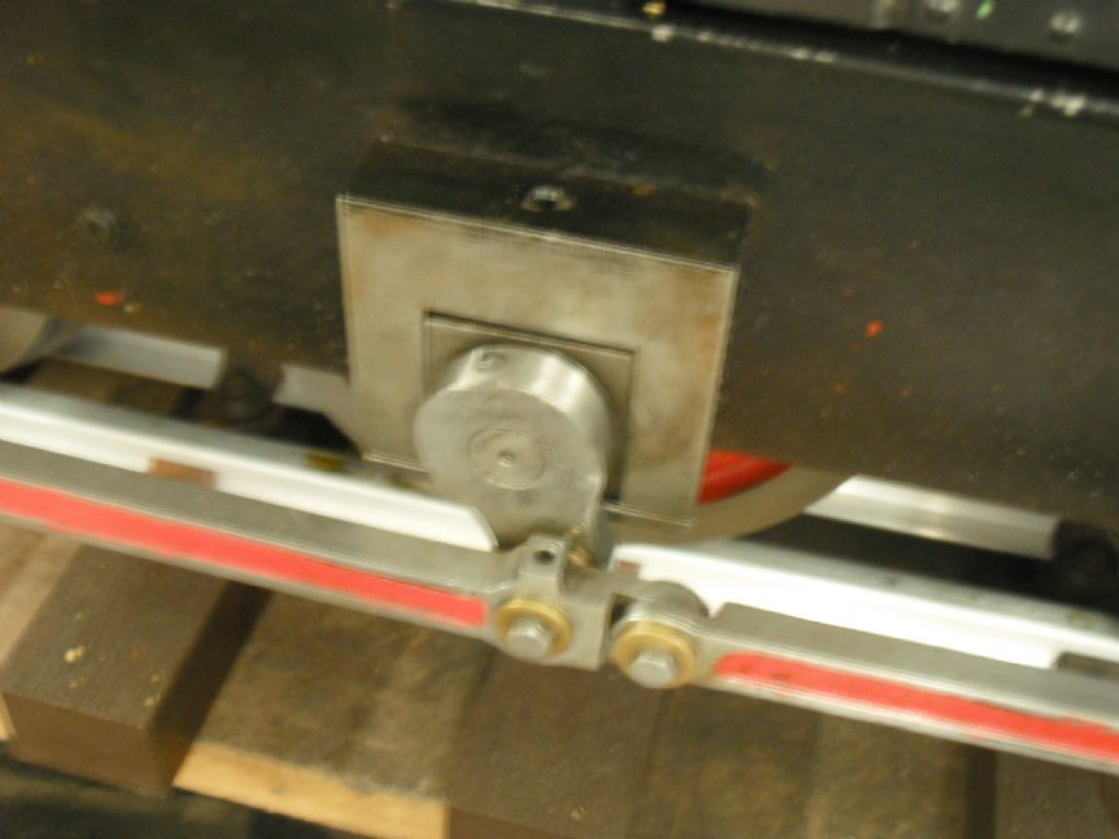

                            #145650
                              The jackshaft cranks on my shunter are split and clamped to the ends of the shaft and taper pinned for location.
                              This makes them removable (the bearings are located in holes in the frames and can't be lifted out of hornblocks).
                              These arrangements are exactly as the prototype.
                              Hudswell Clark
