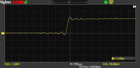

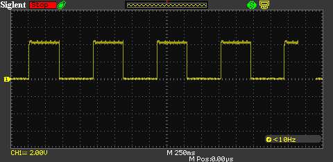

                      SK’s example may not be ideal, but opto-sensors do have limitations.  In a pendulum clock, they are much faster and less intrusive than a mechanical escapement, so taking measurements with doesn’t disturb the bob, and tiny variations of period are detected.
                      What causes tiny variations is quite interesting. Temperature, air-pressure, draughts, circular error, impulse disturbances, vibration, gravity, turbulence and others.  The accuracy, or rather speed and repeatability of the photo-sensor becomes relevant.   I’m using a Sharp GP1A53HRJ00F, typical rise time 0.01uS, fall time 0.005uS.  The device outputs a 5V logic signal:
                      mk2sqwave
                      Rise and fall look steep with the oscilloscope sweeping at 250mS, but zooming in at 250uS shows it takes 210uS to get from zero to 5V.
                      mk2sqwavezoom
                      The Sharp triggers at 1/3 supply voltage, so about 100uS late.  As Robert says doesn’t matter as long as the switch point is consistent.  But various things move the switching point slightly, causing noise, which SK’s 200nS system will see.  They include:

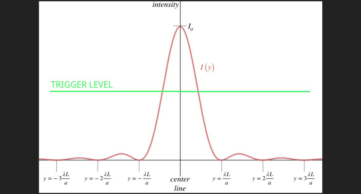

                                  I did a little math on the diffraction question for John’s case of using a slit. The result depends heavily on the slit width and the space between the slit and the sensor, and all cases are much different than turning the light on and off electronically.
                                  With 1 um light, a 10 um slit (probably smaller than John’s, but readily available for purchase), and a sensor 3 mm away, the approximate width of the diffraction pattern would be 120 um. At 0.1 m/s, it would take the flag 600 us to cross one half of this width (i.e., the time from darkness to peak brightness). This is certainly long enough to be a concern.
                                  With a 100 um slit, the diffraction pattern would be much smaller, at maybe 6 um on each side, with the center 100 um being relatively flat. At 0.1 m/s, the edge diffraction would be passed in 60 us. This is still hundreds of counts at 200-400 ns per count, and therefore deserves some consideration.
                                  For the case of a single edge, diffraction still occurs, but not interference (no light and dark bands, just a blurred edge). The math is about the same as the 100 um slit case, so it would also take ~60 us to cross the single blurred edge.
                                  A thought or two: using a narrow slit appears worse than a single edge, and a wide one is little different than a single edge. Using blue light, e.g. from a 405 nm laser, would improve the numbers by about a factor of 2.5.

                                    Though SK has me worried, I’ve never noticed anything in my experiments suggesting error due to diffraction patterns.  Is this because the electronics (comparator or Schmitt Trigger) react at a level well above the diffraction side-lobe intensity?   The sensor simply doesn’t see them, cos it’s as blind as a bat!
                                    Screenshot 2026-02-18 at 16-58-38 single_slit_intensity.png (PNG Image 1309 × 888 pixels)
                                    Trigger level normally set at 1/3rd or 1/2 supply setting, which is a strong anti-noise filter, whatever the cause.   Then the detector fires more-or-less reliably at the same point as the main lobe rises in intensity.
                                    OMG though, Schmitt triggers are affected by noise on the supply and aren’t linear.  Is a comparator better for high-precision measurements?  I don’t know.

                                      Your mathematically-perfect plot makes things look too easy.
                                      For the diffraction with interference case, the side-lobes are lower than your threshold as you show it, which shouldn’t be difficult to dodge. For the diffraction without interference case, you will only have something similar to the central portion, the pertinent part of which would be S-shaped when using a single edge or a wide slit.
                                      Either way, it’s largely the slope of the side of the center lobe that is the concern. The problem is that crossing the width of the left half of it can take upwards of 60-600 us (with 3 mm gap), which is 300 to 3000 counts at 200 ns per count. With say a 1V signal, that’s about 0.3 to 3 mV per count. That isn’t exactly horrible, but at the very least you would want the noise of your sensor and electronics to be lower than that.

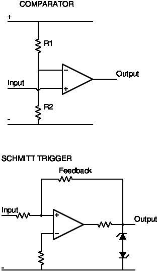

                                                  Do the same thing?  Not as I understand it.  Although both are based on comparators, the circuits are different and so is how they behave:
                                                  compschmitt
                                                  A plain comparator switches when the input signal passes the reference voltage set by R1:R2, which can be controlled accurately by the designer.   Great, unless the input wobbles noisily around the reference voltage causing the comparator to switch wildly in response.  Though the circuit responds well to clean input it has poor noise immunity.
                                                  A Schmitt trigger increases noise immunity with feedback. When the input passes the up or down reference voltages (two references, not one), output is added to the input, forcing it past the switching points even if the actual input is wobbling.  Good noise immunity, but I believe the cost is reduced time precision – the detect point is less repeatable.
                                                  Question is does hysteresis improve or degrade the detection accuracy of a swinging pendulum?
                                                  I think the answer depends on the noise level. My Mk1 clock suffered badly from what turned out to be internal reflections.   IR from the LED was bouncing off the shiny metal structure of the clock and from the moving bob.  Though I didn’t prove it, I’m fairly sure my comparator detector was confused.  Cure was to reduce the power of the LED, fit slits, put up blackened internal shields,  and blacken the shiny surfaces.
                                                  I did prove ambient light is a major problem in that it moves the trigger point by desensitising the sensor.  Cured by enclosing the pendulum so it swings in the dark. I used a 4mm thick black PVC soil pipe, which should absorb most IR, except it warms up and re-radiates inside.  I guess the consequence is heating of the internal structure rather than disturbing the sensor, but I don’t know!

                                                    Julie Ann
                                                      @julieann
                                                      On SillyOldDuffer Said:
                                                      On Julie Ann Said:
                                                      There is no doubt that a Schmitt trigger is a comparator with hysteresis. Of course a Schmitt trigger as implemented in a logic IC, or an optocoupler, is not as well defined as a discrete circuit designed with a comparator IC, but they essentially do the same thing.
                                                      Julie
                                                      Do the same thing?  Not as I understand it.  Although both are based on comparators, the circuits are different……
                                                      SoD: As you earnestly commented recently in another thread, please read my post carefully before commenting.
                                                      I clearly said that a Schmitt trigger is a comparator with hysteresis, yet you have drawn a Schmitt trigger and a comparator without hysteresis.
                                                      In my experience it is rare to use a comparator without some hysteresis. Even a few millivolts helps to prevent spurious output transitions due to noise. Of course Schmitt triggers, as used in optocouplers, often use significantly more.
                                                      Julie
