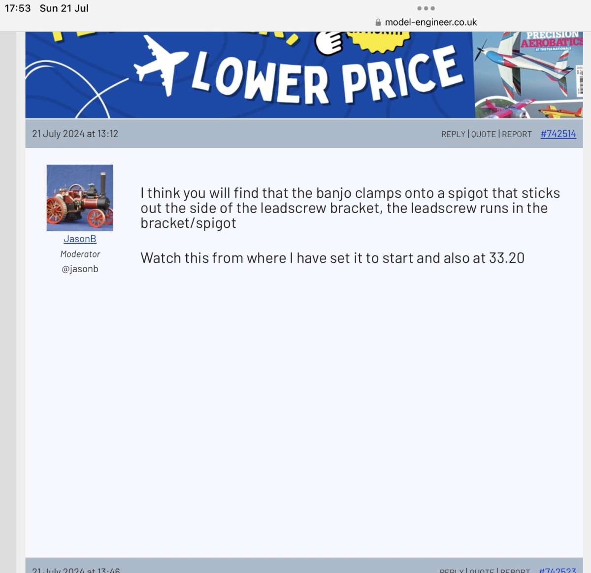

              Others have evidently watched this already, but I see white space in Jason’s post.

                        Meanwhile: __ this is how I see your previous post:
                        IMG_9942

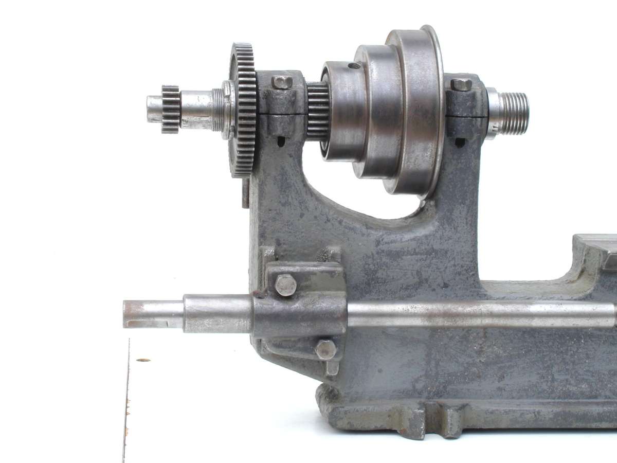

                          Hi, probably looks similar to this one on an old RandA lathe of a similar age, and I think much the same on many lathes of that era.
                          SS03
                          Regards Nick.

                            Thanks Nick, yes that’s much like it. I initially thought that the thicker section was part of the leadscrew rather than an extension from the bearing mount.
                            Just to update the above (I bet you’re all dying to know 🤣) the spacers I’ve made up have made a great difference to the gear train and the leadscrew now turns effortlessly by hand. I’ve still got to make up the gear retaining screws but it’s 100% better already.
