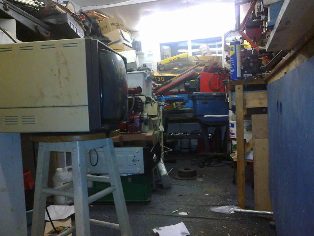

                        You're worried about dust? Look what I've got to sort out after our flood scare earlier this week! And only a week after a good tidy up too.
                        P.S. I use sheepskins to guard my tools, dressed witha combination of goosegrease, lanolin and whale oil it works a treat
                        Flood Ready?

                                        Posted by Stub Mandrel on 01/12/2012 13:36:23:
                                        Flood Ready?
