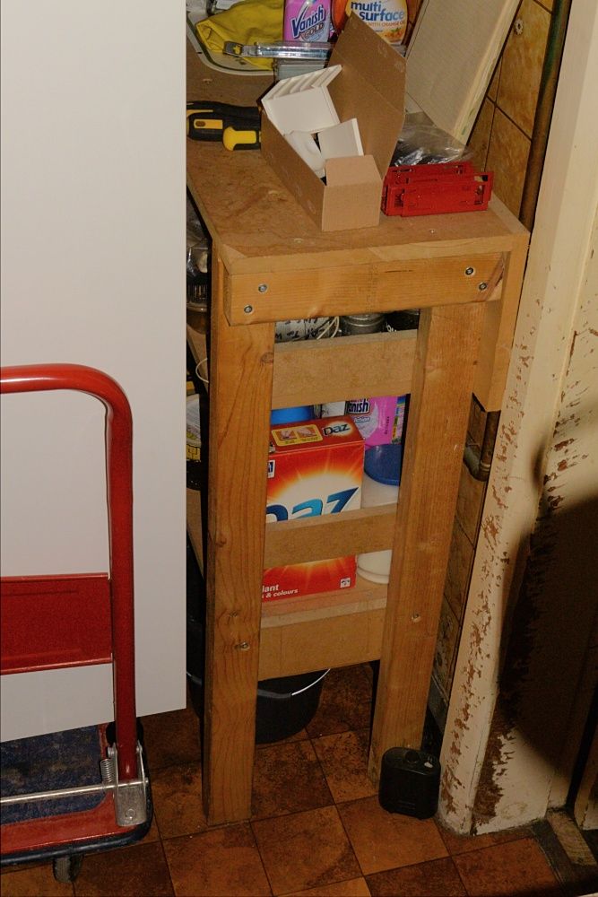

                              Thanks for all the ideas guys, I may bolt it to my existing workbench for the time being as it's pretty sturdy wooden structure with a sheet of 25mm marine plywood for a worktop,used currently for motorbike maintenance,until I can sort something else out.img_0492.jpg

                                #267819
                                Bazyle
                                  @bazyle
                                  The front leg of that wooden bench looks like it is held by a couple of dinky little screws and neither horizontal rail is over the leg. Definitely need a welded version…….
                                  #267827

                                      @ajohnw51620
                                      Posted by fishy-steve on 21/11/2016 19:04:11:
                                      Take a look at Unistrut.
                                      I've made a bench using it and it's as solid as a rock.
                                      Steve.
                                      Interesting stuff and worth remembering – dexion on steroids.
                                      The problem with the wooden bench is bracing the legs against side to side movement of the bench. A shelf or two with a fairly deep support all screwed in place can fix that in the same way as I did on the one I posted a shot of.
                                      Just sheeting in the side wont achieve the same thing unless it's extremely stiff.
                                      frownYes I under hung the top shelf. Most have been feeling perverse. More likely couldn't get at the screws when I made it.
                                      Edited By Ajohnw on 22/11/2016 09:28:55

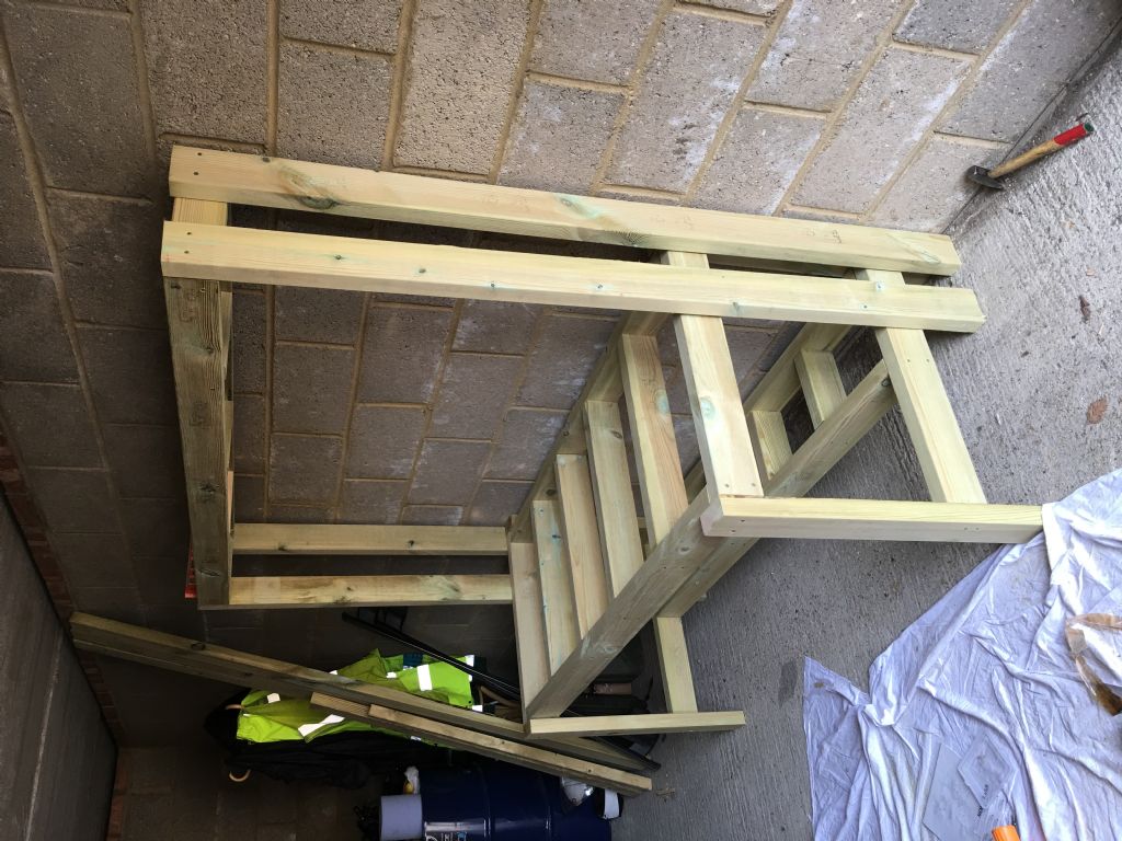

                                            My wooden workshop bench is based on Steve Ramsey's design over at WoodWorking for Mere Mortals
                                            Details of my workbench build are here, all made from 2×4 PAR timber. Legs are 4×4, 2 x 2x4s glued and screwed, the end braces are also glued and screwed, the side braces are coach bolted through the entire leg, then 2 layers of 18mm marine ply glued and screwed for the worktop.
                                            It was built in-situ around the compressor and probably weighs nearly as much as a metal Myford stand – it does'nt move
                                            Edited By Zebethyal on 22/11/2016 10:13:25
