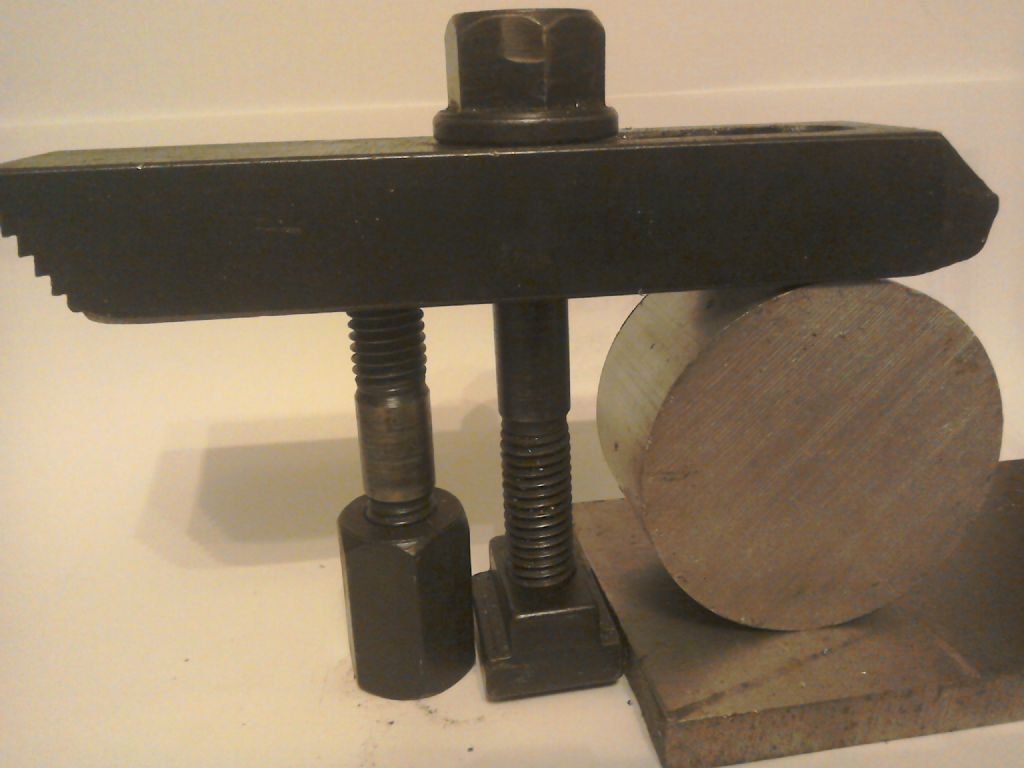

      Hello again folks, I seek your advice once more.
      I know this is ugly but is it good or bad? And should I get a bigger vise (this one 4&quot?
      70mm of 50mm aluminium bar drilled 22mm (tip of 22mm blacksmith's drill just visible on left). I've made a few of these items previously but used boring tools to dig them out from 13mm drilled holes, so the bar was held in the 4 jaw chuck. Took me absolutely ages. I couldn't stop the lathe juddering or the boring bars (in tailstock 50mm boring tool holder) nodding madly! I did try to balance the chuck with weights, hardly made a difference though.
      And one more question to our friendly experts – can I use the same method to open a hole up to 30mm in the same material, drill held by ER32 hex collet block in 3 jaw chuck or is my life in danger?

          Maybe not ideal but when needs must. I have made up a couple of clamping bars from 1/2 x 1" steel that are drilled to suit the tee slot spacings in the mill and another the lathe's cross slide slots that are good for jobs like this.
          I'd just hold the blacksmiths drill in the lathe's 3-jaw chuck and not bother with teh ER block & collet.

              Main problem you have is there is nothing directly behind the area you are cutting. You are imparting a turning motion on the fixture. Also the clamp studs have a bending force imparted. All bad with such a large intended bore.
              Place the part on the angle plate so that the intended hole is above it. Make a strap clamp to hold the part, ideally one either side of the hole. A strip clamp can be a bar with two holes in it spaced as per the tee slots. Ideally as well put a fixed stop against either end of the bar to stop it moving sideways under cut.
              If using a vice it would need to be big to have sufficient jaw depth to hold the part in at least one see. My suggestion would be to hold as above rather than in a vice.

                  It's nasty for 3 reasons:
                  i) The clamping nut is unable to act straight onto the washer and clamp across its full diameter. It would be hugely better to add an equivalent thickness of support to the clamp on the opposite side of the stud, so as to level the clamp square to the stud or thereabouts, and even out the force the nut can exert.
                  ii) The clamps should be as close as possible to the site where machining force will be applied. If the hole shown only just clears the vertical plate, the clamps should be closer to it.
                  iii) It's also undesirable to sidestress the T-nuts and studs like that. Even if there are no dramatic events, there'll likely be some damage to reduce their future usefulness.
                  For opening up, I'd use a boring head with light cuts or, failing that, a collet- or chuck-held boring bar with a manually-set toolbit to open up to about 29,6 before using the 30 drill as a reamer. Light cuts, slow feed, and sort out the clamping first.

                    It the top stud goes up a little more or the bottom stud goes down a little more you have a loose setup. Never a good idea. Put a support on the opposite side of the studs to keep the clamps level so that there is no way for the studs to go loose. A simple machinists jack (see the one made by Dr_DMJN in this thread Stuart 10V Build Log for a simple design) will allow a good solid clamping action. Alternatively have a metal bar across the workpiece with holes for both the studs.
                    I agree with old mart, you were very lucky – this time.

                      The clamps are dire, the work is trying to twist away from the drill.
                      I would mount the angle plate in line with the drill.
                      Cut a chunk of 1/2" MDF to suit the bolts between the rod and the angle plate.
                      Use a single clamp plate as Jason suggests to hold it all.
                      Stop drilling when you see MDF in the swarf

                          Rear support of the clamp bar using a clamping set hex coupler and stud as a simple jack. Keeping the clamp close to level is important to avoid side forces on the stud which will encourage it to go down the gradient and so loosen.

                            Purely my preferences, but if possible I would hold the work in the 4 jaw, with the drill in a chuck in the tailstock.
                            This should be the most rigid way of holding the work, and least likely to move under the cutting forces.
                            The method shown is not the most rigid. Martin Connelly's method is better, if you must, since it provides increased clamping forces.. (Don't like the steeply inclined clamps! )

                                Martin –
                                I realise your photo is simply to illustrate the method but with respect I would –
                                – put a nut on the top end of the jacking stud to increase the bearing surface a bit, and avoid the risk of harming the end turn of the thread; and
                                – put the jack further back so the mechanical advantage is in favour of the jack holding the work-piece rather than vice-versa. (It's about 2:1 against in the picture.)

                                                Nigel, you are correct it is just for an example, I have proper machine jacks, Wixroyd 15000.W0050 jacks and step blocks for when I do this sort of clamping. This was showing the minimum you could do to fix the issue and also the space behind the studs in the original photo was taken into account with the example shown. My preference would have been a good sturdy bar with holes for the studs going across the workpiece as has been mentioned above given the space available.
                                                There is one of these jacks in this photo from 2017 and step blocks supporting the back of the strap clamps from the kit on the wall behind the mill.
