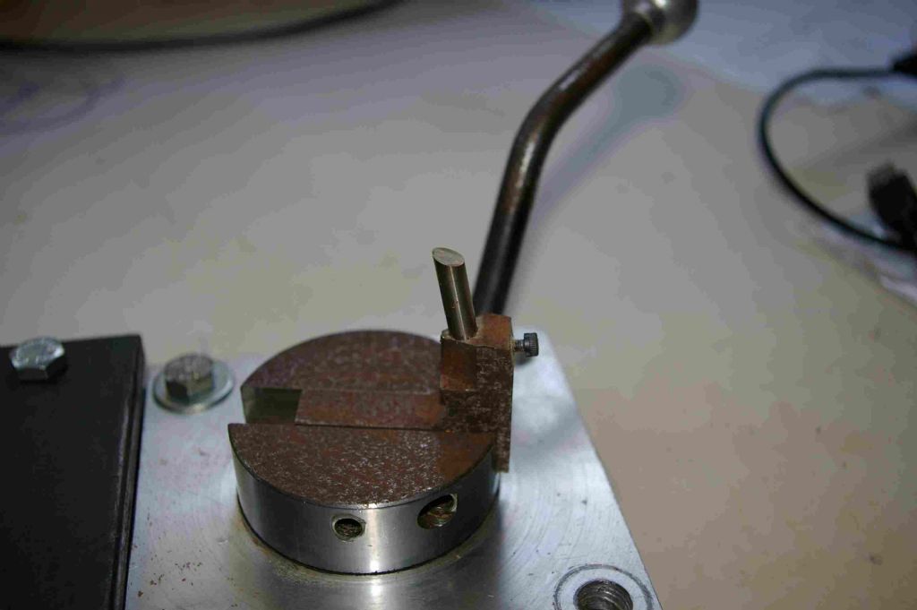

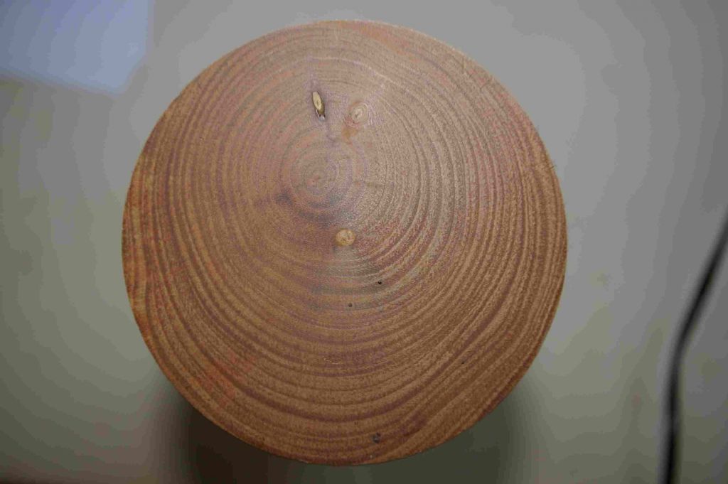

                                                    endgrain2.jpgHi Nathan,
                                                    I have found the Diamond Tool Cutter from Eccentric Engineering is excellent for turning wood, particularly if you use a round rather than a square tool. I have attached a couple of pictures showing the finish I got on the end grain of a piece of Kanuka wood. The finish is as good as that from a skew chisel but is of course dead flat. I use a similar cutter arrangement in my ball turner. There is very little sanding required after turning.endgrain1.jpgendgrain3.jpg
