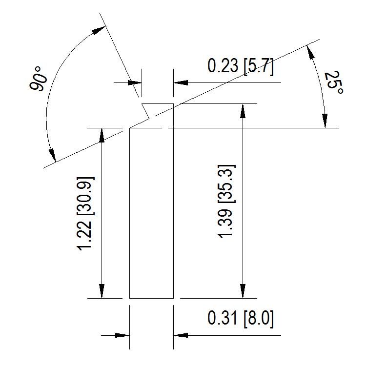

      I have been after one of these for ages, and have just managed to find one.
      However the little drill setting fixture is missing from the set, does anyone happen to have one they could measure up for me so I can make one.
      It is shown in fig 3 of the instruction sheet.
      **LINK**
      I could work it out, but thought I would ask first.
      Thanks

                    Here you are, Phil. As measured from mine in imperial [metric].
                    Cheers,
                    Rod

                      Hi Rod
                      That is exactly what I was after, thanks for taking the trouble.
                      Just out of curiosity, when the drill is in position is the wishbone frame dead parallel to the stone as was suggested earlier ?
                      Or to put it another way, does the outside of the wishbone have an angle of 118°. The 25° angle of the jig suggests a wishbone angle of 130°

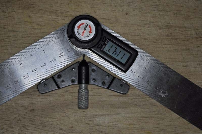

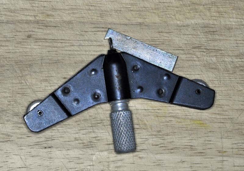

                          The gauge rests against the arm:
                          whereas the drill angle depends on the the projection of the wheel:
                          Getting close to 118 degrees – looks like I could have opened the gauge out a little more judging by the LH wheel. Anyway, according to Tubal Cain in "Drills, Taps and Dies", the angle is not that critical.

                              My wishbone sharpener arrived at work today, and just out of curiosity I borrowed a vernier protractor to measure the frame angle.
                              Guess what……..It is 118°, so you were indeed correct about having it parallel to the stone.
