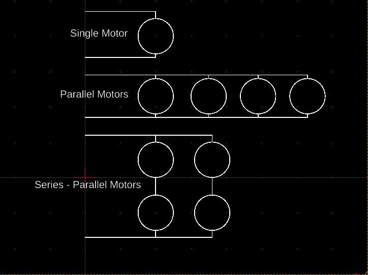

      Hi, in the wiring diagram of the 4QD DNO-10 controller it shows the two terminals for the motor. But how would you wire up 4 motors each being 12volt. Do I wire the motors In series or parallel. Or sure I split the power take off at the 4QD terminals and wire the motors in pairs as it’s two motors per bogie. Which is best.

              if you wire the motors in series you will reduce the voltage across each motor to 25% of the boards output (based on identical motors). Putting them all in parallel will put the board's output voltage on each motor but will increase the output current fourfold over one motor (same caveat). A hybrid of two parallel motors in series with another two in parallel will halve the voltage on the motors and keep the output current the same as a single motor.
              So if you have four 12 volt motors in series on a board with a maximum output voltage of 36 volts the motors would be expected to only be supplied with 9 volts. Possibly not what you want.
              If you put the 4 motors in parallel then supply them with 12 volts and they all draw 25 amps inrush current then the board, wiring and power supply would have to be able to cope with 100 amps for a short time.
              Answering "what is best? " is dependent upon what load the motors will have to overcome, the power supply being used and how much stress you are willing to subject everything to. The stress is related to how close you want to take things up to maximum rating for the system and for how long they would be subject to this stress.

                  As the 4QD site says there can be issues with motors in series. This is due to the voltage/speed current/torque charateristics of DC motors. The the voltage should split by the ratio of the speed and current by the ratio of torque. for a ideal motor but there is no ideal motor and it is difficult to get balanced torque. So in practice one motor will try to run at high speed. Worst case if you stall one motor of two 12V motors in series on a 24V the other (unloaded) motor will overspeed as it will almost all the 24V supply voltage. This will exceed its 12V rating. It's a bit like a differential on a car when one whell losses traction. If the two motors output shafts are linked it will generally help with load sharing. It will still depend on the specific motors though.
                  The easy answer (assuming the controller has enough current rating) is batteries and motors in parallel. This is a 12V system. The other option is batteries in parallel and two pairs of serial connected motors in parallel. This is a 24V system. You would have to try the 24V system and see how your motors work.

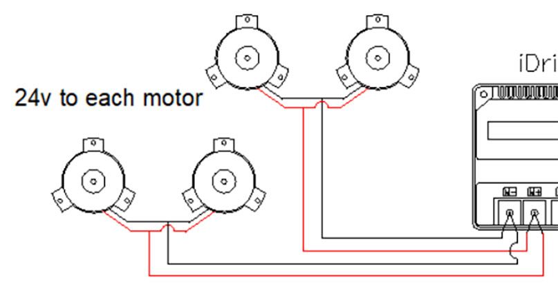

                      The controller will drive multiple motors as long as you don't exceed the current rating (As stated in previous posts). Maxitrak drive multiple motors from 4QD controllers …. The manual only shows 1 motor for simplicity.
                      Here is the wiring for a 2-Bogie loco (Each with 2 motors) – So 4 motors in Parallel
                      Please ensure that you wire the motors so they all rotate in the same direction. (You may need 1 running forward and 1 running in Reverse on each bogie if 1 drives on the left and 1 on the right!)
