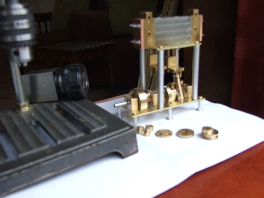

        Still got quite abit to do and tidying up,but would it be best to put rings on the pistons if so what would you use mostly using air to start with any thoughts please
        Paddleduck
        #454344
          If the air running is just for display you are unlikely to need rings, if doing work then Rings would be best. I would go with a single Viton O ring, easy to cut the grooves anyway and leave them off to start with.
