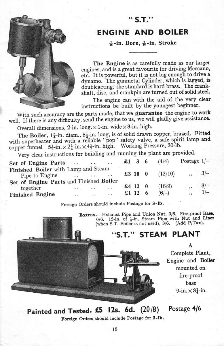

      Hi, yes the S.T. engine had a gunmetal cylinder years ago. The scan below is from my Stuart Turner Ltd. 1968 catalogue
      Scan_20260113

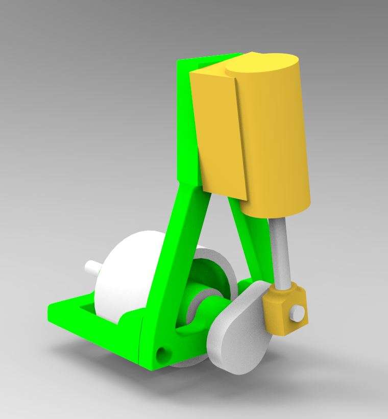

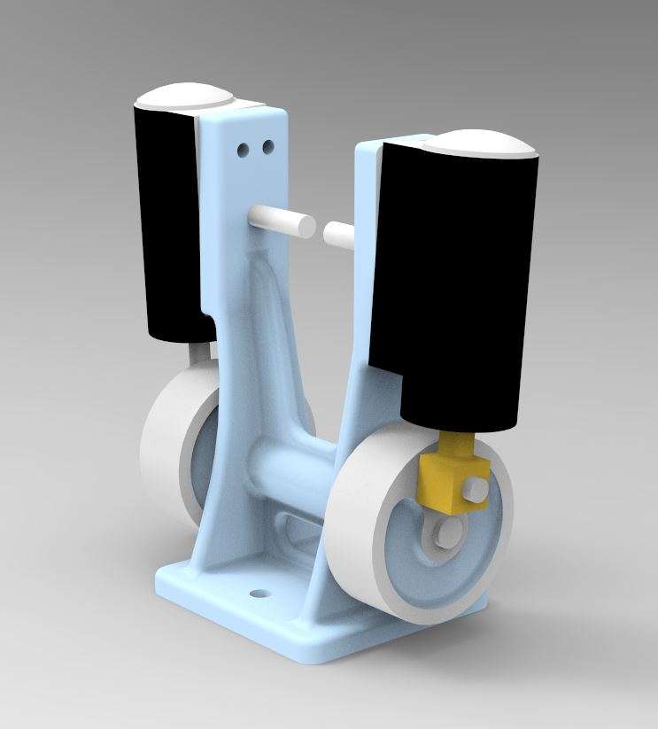

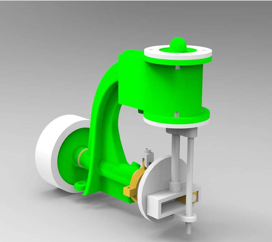

          Should be a few more to come, do you have any of these oldies in your collection? Two will be from 3D prints again and teh other more traditional fabrication & cutting from solid.
          SEL Launch Engine
          sel 3d
          Bassett-Lowke twin oscillator
          BL 3D
          Stevens Model Dockyard Direct acting Marine Screw Engine
          Steve 3D

            Thanks for those drawings Jason, the closest I have is a Maxwell Hemmens that is very similar to the SEL launch engine.
