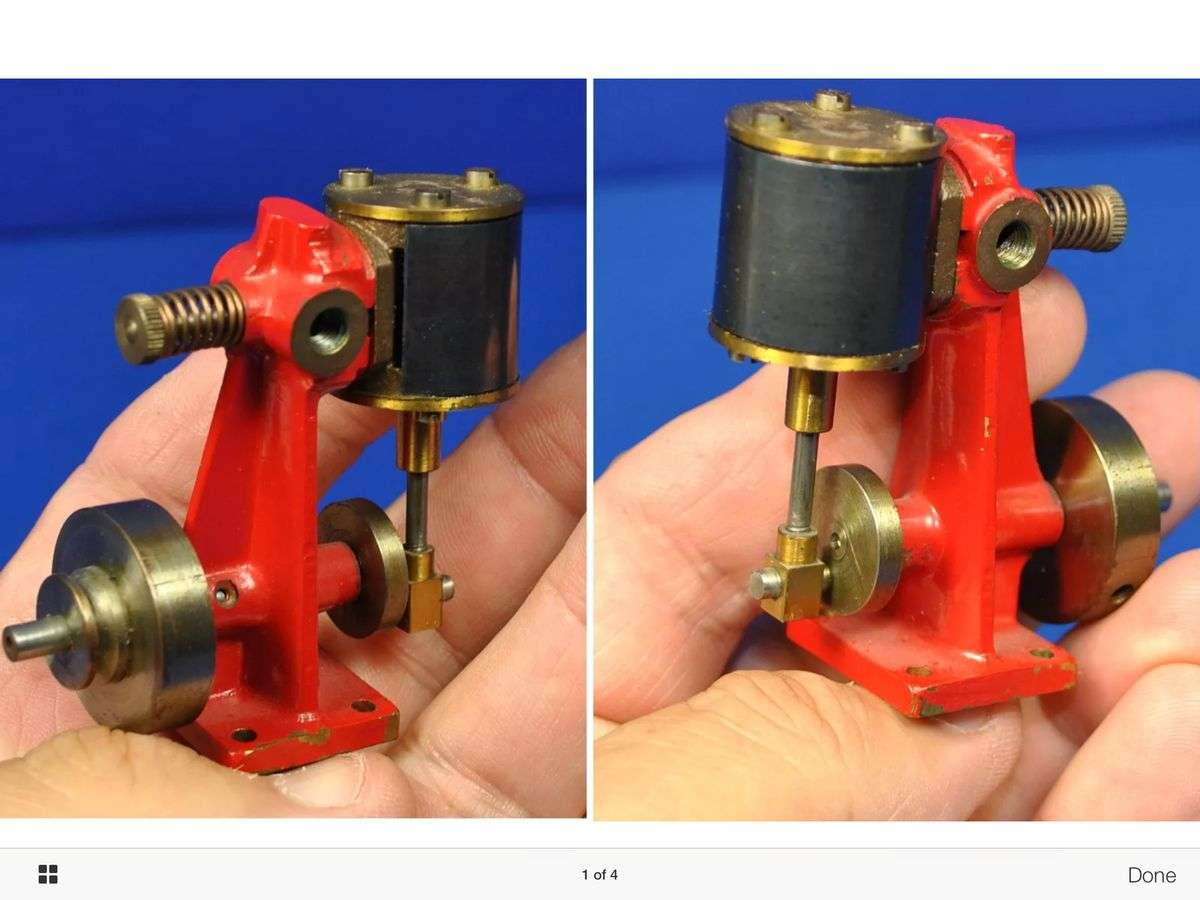

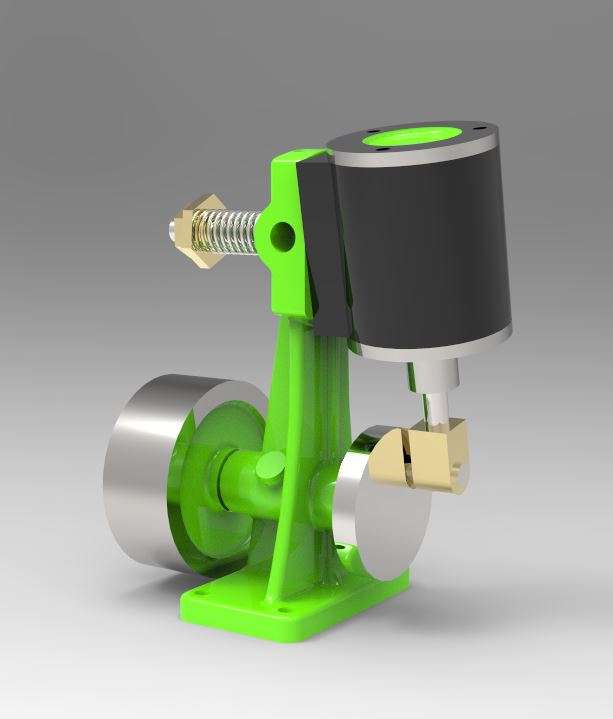

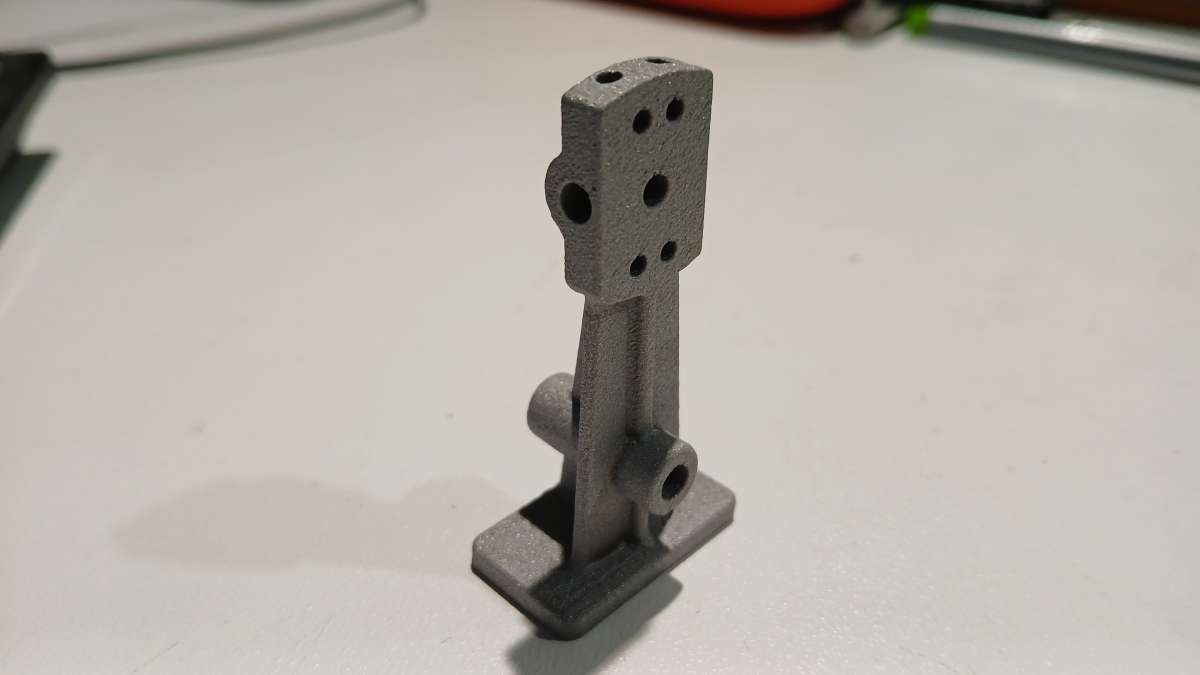

      Those that have been following my Kelsey thread will have seen that I had thoughts of a single cylinder version but was a bit put off as most of the work would just have been a repeat of the Vee Twin. However I have a large folder on my computer of “Future Projects” and one image that I have had stored away there for a couple of years is this little wobble. I think it may be an early Stuart from the days when they had cast cylinders not the current extrusion as the screws would have gone into the cylinder flanges rather than the long studs used on the extruded one.
      wobbler
      A bit of time spent on Alibre and I had a design that I was happy with and decided to upload the frame to Craftcloud just to see what a 3D metal printed one might cost as an alternative to making it by fabrication.
      frog
      The price looked reasonable, so I went back and modified the frame file to be more like a casting by suppressing all the holes and adding a small machining allowance. As mentioned earlier in the year in my A J Weed engine build a lot of the online quotes have a set “job price” that includes printing, post and tax and as this is quite a small item it easily fell within the job price. Playing about with the quantity required showed that I could actually get six frames printed for the same job price as just one so decided that was the sensible option as six frames for £37.00 seemed quite reasonable to me particularly considering that just one spare casting for the Stuart single ST would set me back about £43.00.

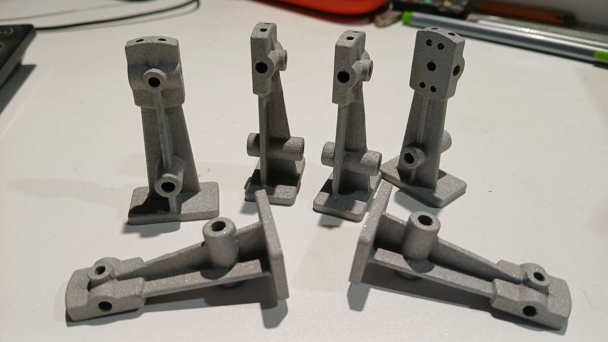

      I then did a less sensible thing and deleted the quote for the pattern instead of deleting the one for the finished standard and did not realise until the prints arrived just 10 days later. Apart from the holes and no machining allowance I was happy with the way they turned out and after poking a couple of drill bit shanks into the holes was relieved to find they were all 0-2 to 0.3mm undersize. The material is Aluminium and I opted for a bead blasted finish.
      20251229_093608
      20251229_093622

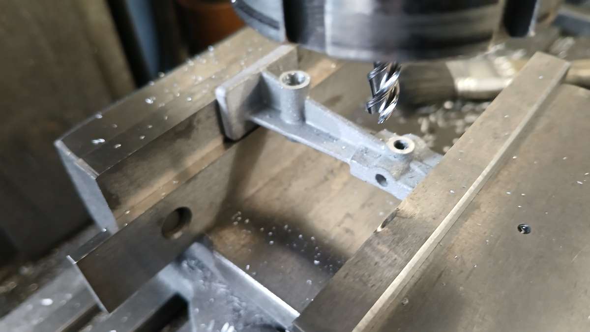

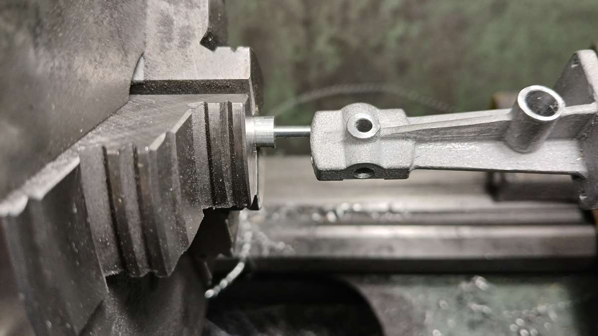

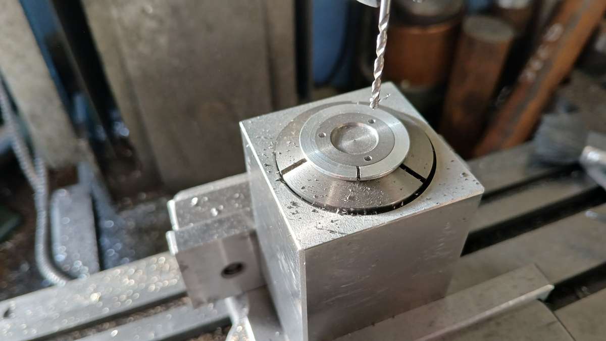

      With the prints arriving on the 29th December is set myself the task of making the engine before the end of the year so got my finger out in no particular order.
      Standard.

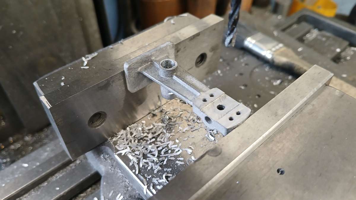

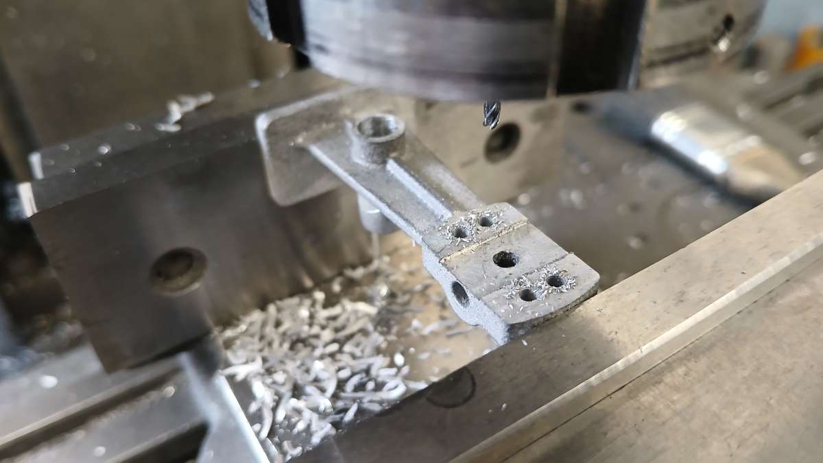

      After quickly rubbing the bottom over some Emery cloth laid on a tile I set it up in the mill vice using a close fitting drill shank to locate the crankshaft bore as my datum point. I took 1mm off the crankshaft boss and the lightest of skims off the port face plus a deeper pass through the middle to reduce port face friction.
      20251230_083726
      The crank boss was drilled out from 3.7mm  to 5.8mm then reamed 6mm to take a bronze bush and the cylinder pivot drilled 2.8mm from 2.7mm before being reamed 3mm. The ctr to ctr distance was as drawn at 31mm.
      20251230_084543

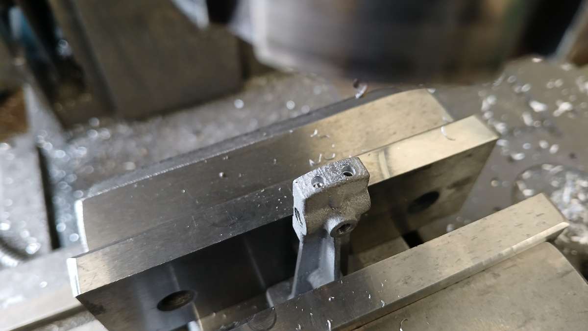

      Four plunge cuts with a 2mm milling cutter crispened up the edges of the steam/air ports.
      20251230_085012

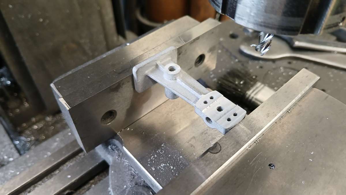

      Flipping the print the other way up the opposite ends of the crankshaft and pivot bosses were squared up.
      20251230_085442

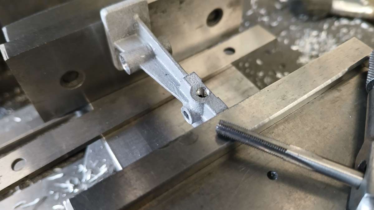

      Then onto its sides to run the 3.5mm drill in and then tap for inlet & exhaust M4 x 0.5.
      20251230_090145
      The bottom was then drilled 2mm for some fixing holes, these had not been put onto the design at the time of ordering so were not present on the print.
      20251230_091641
      Setting the casting up for the final sixth time the two linking passages were cleaned out to their 2mm diameter and then counterdrilled 2.5mm for a short depth so the plugs had something to stop against rather than block a port hole.
      20251230_091041
      A length of aluminium was turned to fit the 2.5mm holes and two pieces cut off and Loctited into position to close off the drillings.
      20251230_093916

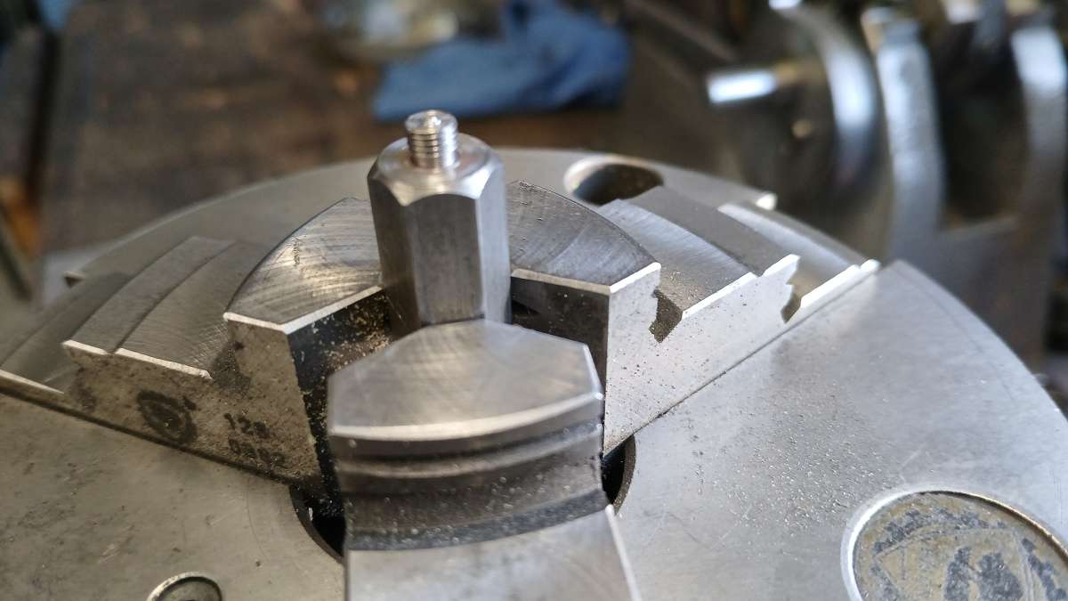

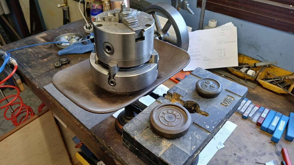

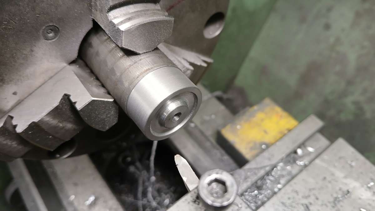

                Danni the aluminium used here and the previous stainles ssteel part I had done all machined much like a piece of solid material would.
                Neither have had any particularly loaded threads, infact the stainless was all through holes and the only ones this time are M4 x 0.5 air connections which don’t get any real pull out load. They cut without problem with traditional taps.
                However as I wa sfiddling with Willy this afternoon I thought I would do a quick test as best I could cobble together in the workshop.
                The weight of the two chucks was 10.7kg obviously it could have taken mor ebut I did not want to test to destruction
                20260102_134741
                The length of thread on the adaptor probably 3mm so 0.75D
                20260102_133257
                So if anyone reading is able to calculate the pull out load achieved I’d be interested to know what it was. The frame was printed laying on it’s side so what load there was was trying to pull the layers apart.
                Now I don’t know if it is the cold weather with snow on the ground here in Surrey or my fiddling with Willy but he is now wobbling a lot slower and will also self start if the crank is in the right position which is more to my liking. After this video I nipped back inside and got the Tacho out again and was pleased to see that he also ran faster than yesterdays video to the tune of 3685rpm and I did get a brief reading of 3702rpm😲

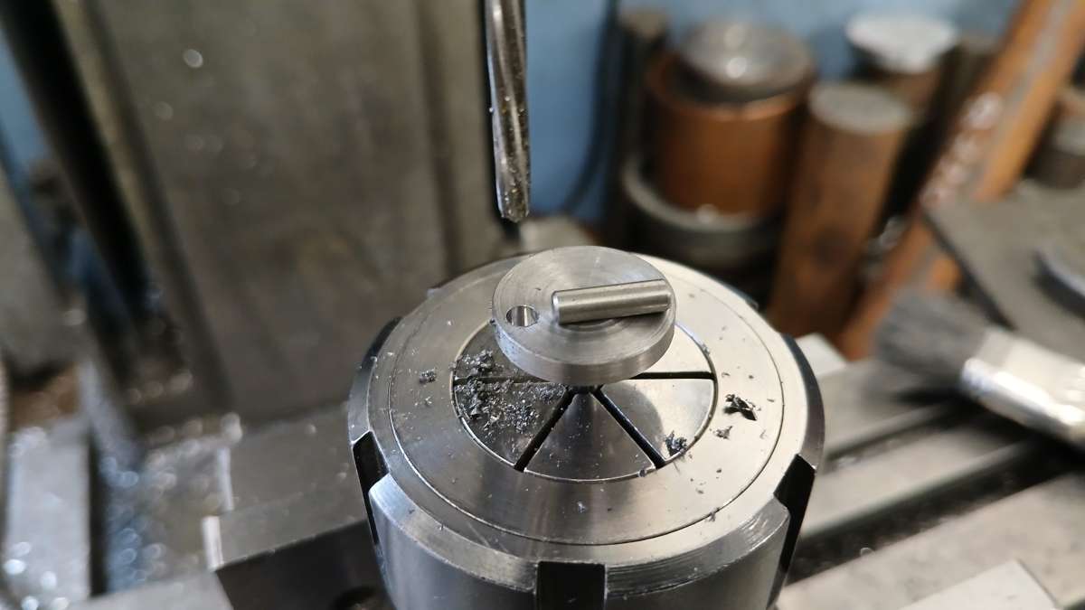

                    Crankshaft

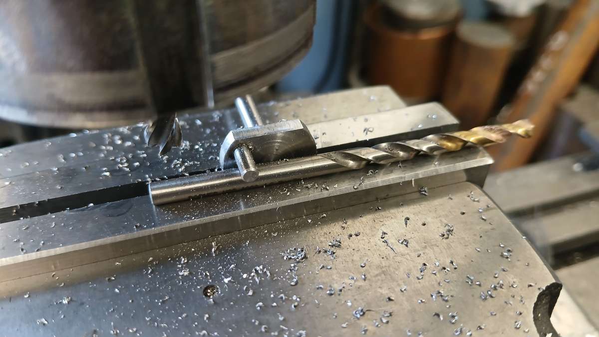

                    As this was to be of built up construction an dLoctited together I did it fairly early on. The crank disk was turned to diameter, a short 1mm spigot formed and then drilled 3.8mm followed by reaming 4mm.
                    20251228_085103
                    After sawing off it was loctited to a length of 4mm silver steel and left to go off. Once set the 4mm shaft was held in the lathe and the disc faced back to 3mm thick. Then over to the mill to drill 2.8mm and ream 3mm at a 6.5mm offset from the centre. I used a hand reamer for this (under power) and did not quite go all the way through as the taper of the reamer can be used to get a press fit. The 3mm silver steel pin was pressed in using the mill vice with a drop of Loctite for good measure.
                    20251228_140336
                    Using a drill bit as a packer to get the same angle on both sides the disc was milled to give a counterbalance to the piston & rod. Just eyeballed nothing scientific. After test running I also added a small flat  on the shaft for the flywheel grub screw.
                    20251231_092510

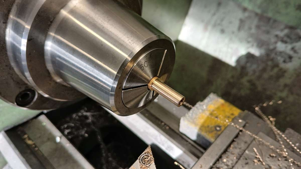

                    Crankshaft Bearing
                    A piece of 8mm bronze was turned a nice snug fit into the frame and then drilled and reamed 4mm. It was sawn off and faced to leave a 1mm thick flange at the full 8mm diameter.
                    20251230_110803

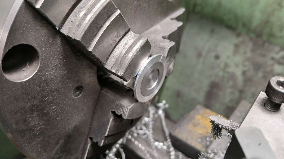

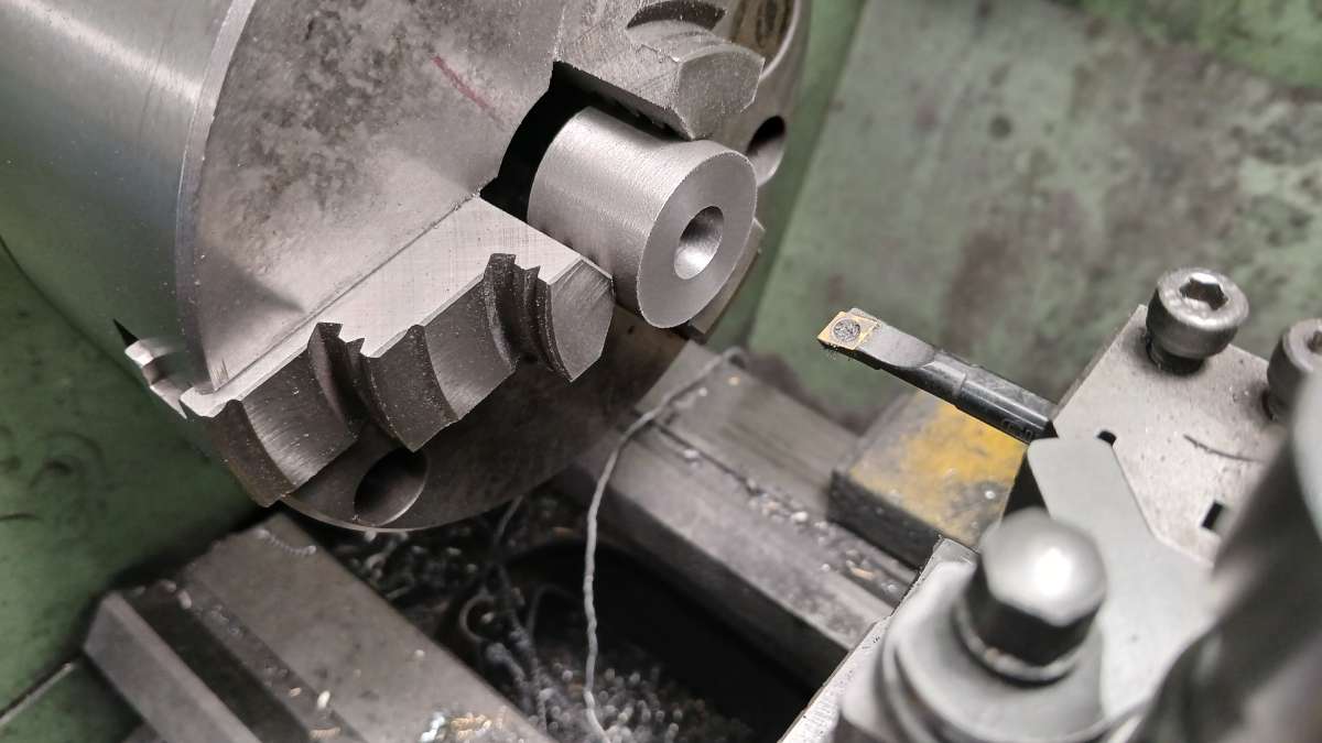

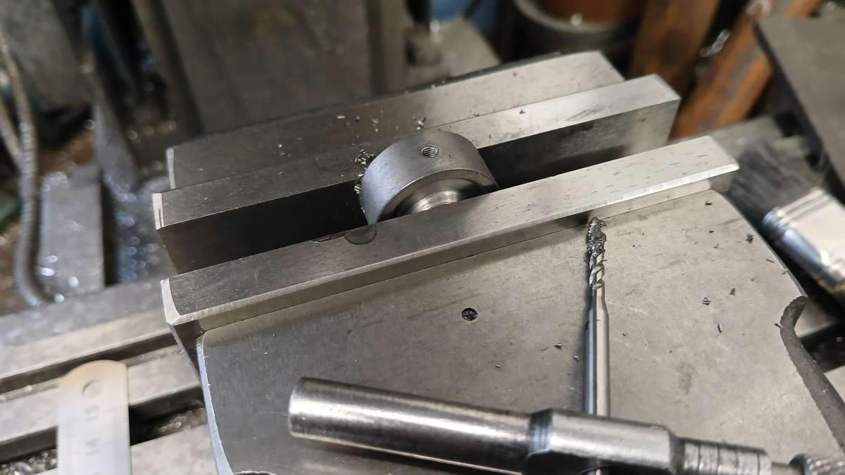

                    A piece of 25mm nominal cast iron bar was turned to 25mm diameter and faced. I then used a HSS tool with a rounded end to form the 1mm tall spigot and also the recessed face. After drilling 3.8 and reaming the other side was faced and recessed but without a spigot.
                    20251228_091636
                    Then into the mill to drill and tap M3 for a grub screw.
                    20251228_092615

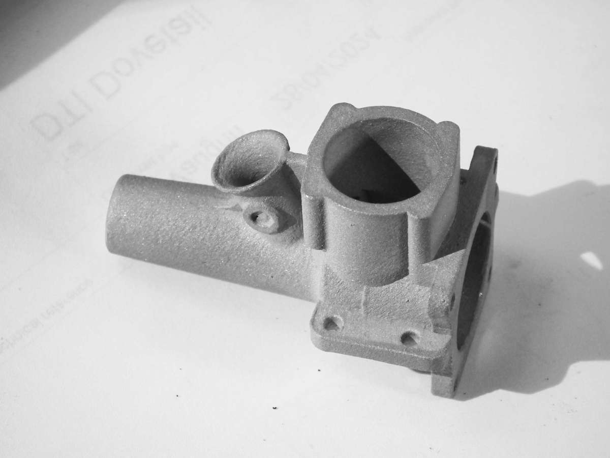

                          Costing can be a bit variable sometimes quite good other times it seems expensive when compared to casting. But a lot depends on what you are after, if it is a one off casting or a batch then pattern making costs will be higher for a single but can be spread over the cost of a batch. But can be worth it where fine detail, complex cores etc are wanted that may be hard to cast or involve more costly core boxes etc.
                          Some interesting recent posts over on MEM which go along with what David has said, the prints can attain the same strength as solid or cast metal.
                          Although the basic structure is fine in aluminium there could possibly be issues with it as a bearing surrface picking up both for the revolving crankshaft and the sliding cylinders on the port face. I went with a bronze sleeve for the crankshaft as it is not something that could be automatically oiled while running unless you go to pumped oiling which you don’t see on many small steam engines. The cylinders on the other hand can be lubricated with either displacement lubricators if using steam or inline oilers when running on air for longer periods.
                          The usual 3D printed aluminium is AlSi10Mg though you can go for 6081 which is the old HE30 and they heat treat to T6. Someone on MEM did the maths and in theory that short length of male threaded steel I had in the print should fail before the aluminium threads strip out. I’m not going to risk one of these prints trying but next time I order will just have a block of metal printed to try and pull the thread out. A simple drop of oil is enough for my <10min runs
                          At the moment there don’t seem to be that many doing 3D prints directly in bronze (or brass and iron), but they all offer a service where the model is printed in wax and then investment cast in bronze but that does put the price up
                          If you have seen my article in the current mag then there are several people using 3D metal prints to recreate old model aero engines where you can’t get the castings anymore like this Sugden Special. They don’t have problems with their heads popping off be that for compression ignition diesels or high performance competition engines. These engines would have had bearings and liners added originally so that side of things is taken care of.
                          Photo 31

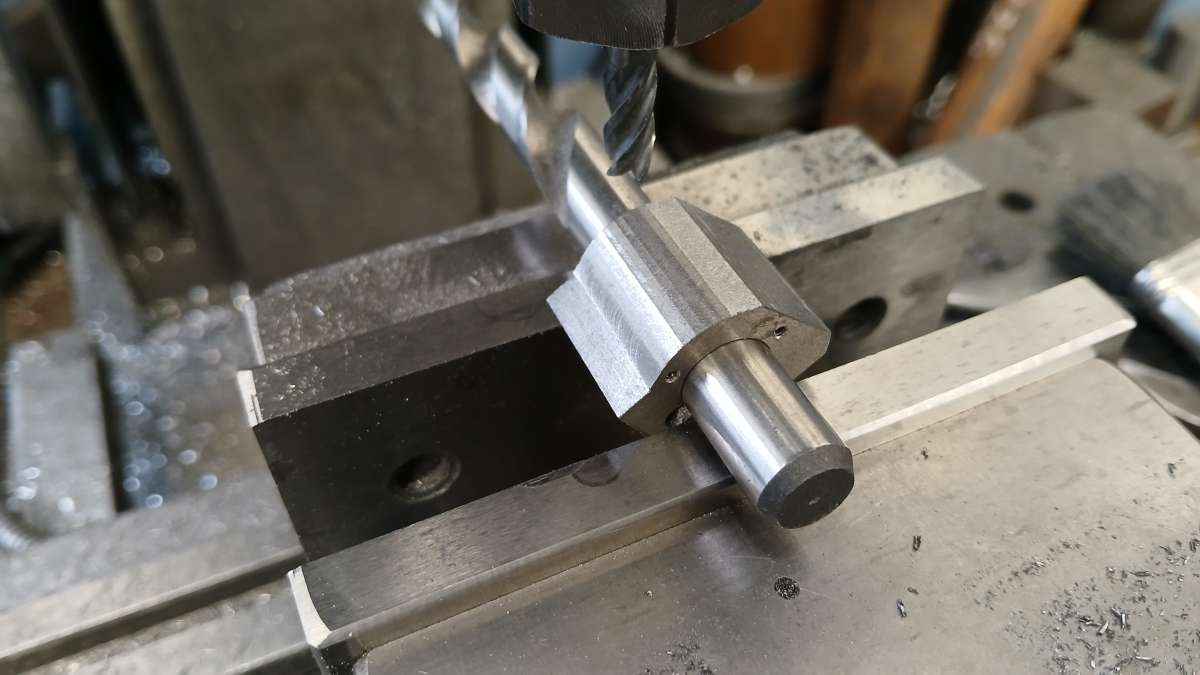

                            On the subject of costs, cast vs printing, disintermediation (cutting out the middleman, the pattern making) suggests that printing should be cheaper.  But, as Jason says, will you get what you want in terms of accuracy and finish?
                            When I retired a few years ago, it was an up and coming process and it certainly has!  Over the last 40+ years I have bought a lot of castings, mostly Aluminium.  At one time, I had the choice of 6 different foundries within a 50 mile radius of home, all but one gone now.  3D printing is just the opposite, spoilt for choice for plastic, at least two of which offer metal printing as well, with, I’m sure, more to follow.
                            As for the mechanical properties of printed metals, as I said before, some conflicting information available.  Renishaw, market leaders in the process, reckoned to work to about 80% of the properties of the wrought version of the metal.  I’ve also seen, from another business, claims that mechanical properties are better than the wrought equivalent except for fatigue.  I don’t believe this because yield and fatigue strengths are closely related.  They blame it on surface finish, if that’s true, then polish it, as would happen anyway.
                            Back to Jason’s delightful little engine.  Crank shaft lubrication.  On my Stuart Turner version of this engine, I have drilled a small hole in the web above the crank shaft bearing to direct oil on to the shaft.  I also relieved the middle third length of the bearing, by reducing shaft diameter.  No need for excess friction.  It also acts as a reservoir for oil.
                            With hindsight, a boss on the print to fit a lubricator would have been nice.  Likewise, somewhere around the port face and cylinder pivot?

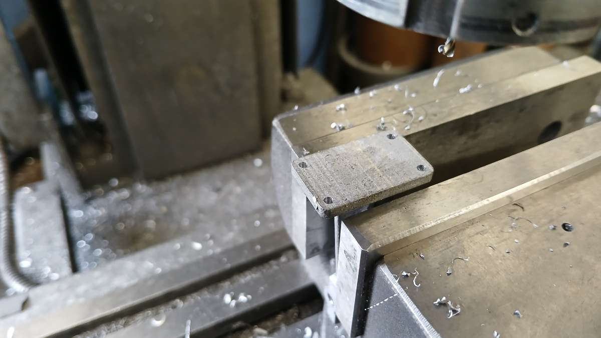

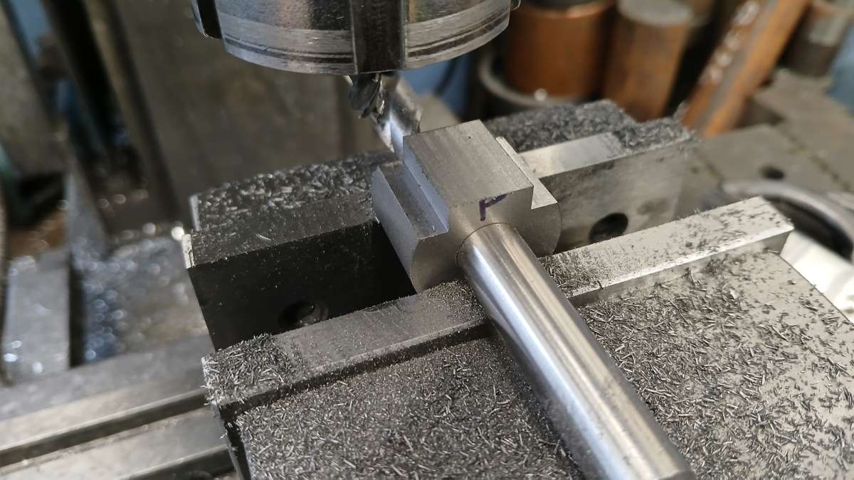

                                The cylinder follows much the same method that I used for Kelsey. It would come out of a piece of 25mm cast iron bar if the initial hole were offset but I had some 27mm material so used that without the need to offset the hole. I started by facing, drilling and then boring to 11mm diameter. That is a small 04 size insert you can see.
                                20251228_142744
                                Then over to the mill to flatten the port face taking the height off an 11mm drill placed in the bore. That was also used to find the ctr line and equal amounts taken off each side to get the finished 14mm width. I also added the two 2mm steam/air ports and the M3 tapped pivot hole making sure to stop all three short of the bore.
                                20251228_144510
                                20251228_145319

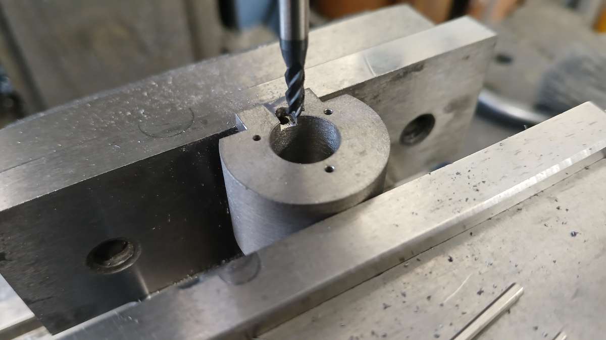

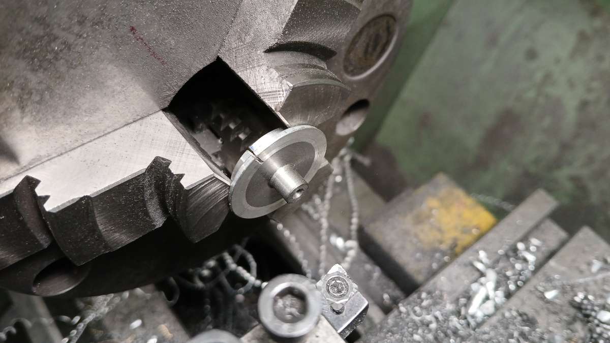

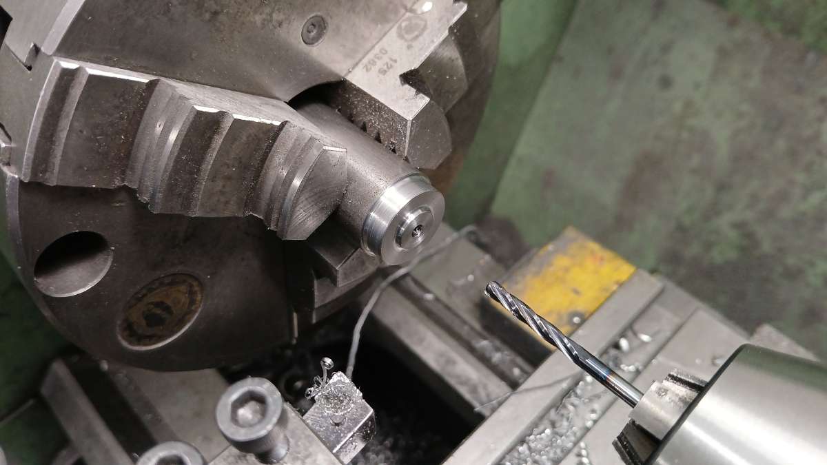

                                Both end covers were cut from 25mm CI bar and the inner face done first complete with 0.8mm long spigots, one being drilled 2.8mm and reamed 3mm for the piston rod.
                                20251229_142117
                                Rather than cut my soft jaws I went with a split bush to hold the only 1.5mm thick covers concentric and without wobble. After facing to length the top one had a decorative recess cut. I prefer a recess to a raised area as it makes painting easy with the higher bare metal surround easily cleane dup to leave the paint in the recess rather than trying to mask around a raised area.
                                20251229_143756
                                The other one which was cut off longer had a spigot formed so there is some length to guide the piston rod. The one I based mine on did not have a gland so I did the same but teh OD could be threaded and a gland nut added if desired.
                                20251229_144538

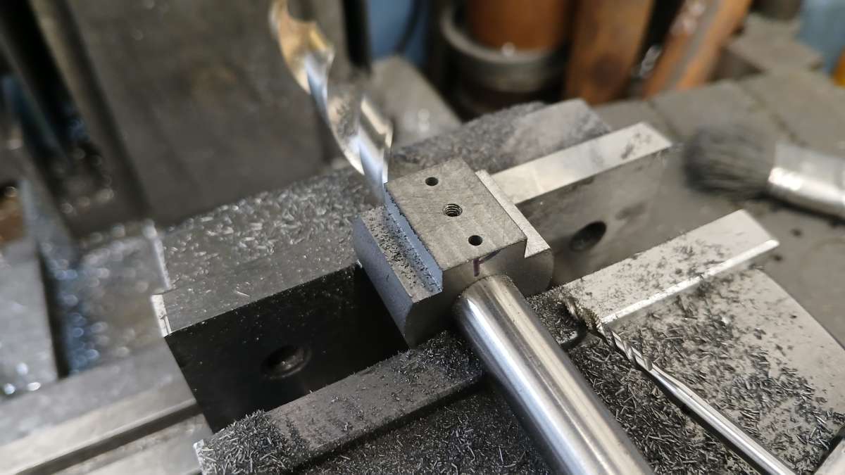

                                The last job on the covers was to drill the screw holes.
                                20251230_105052

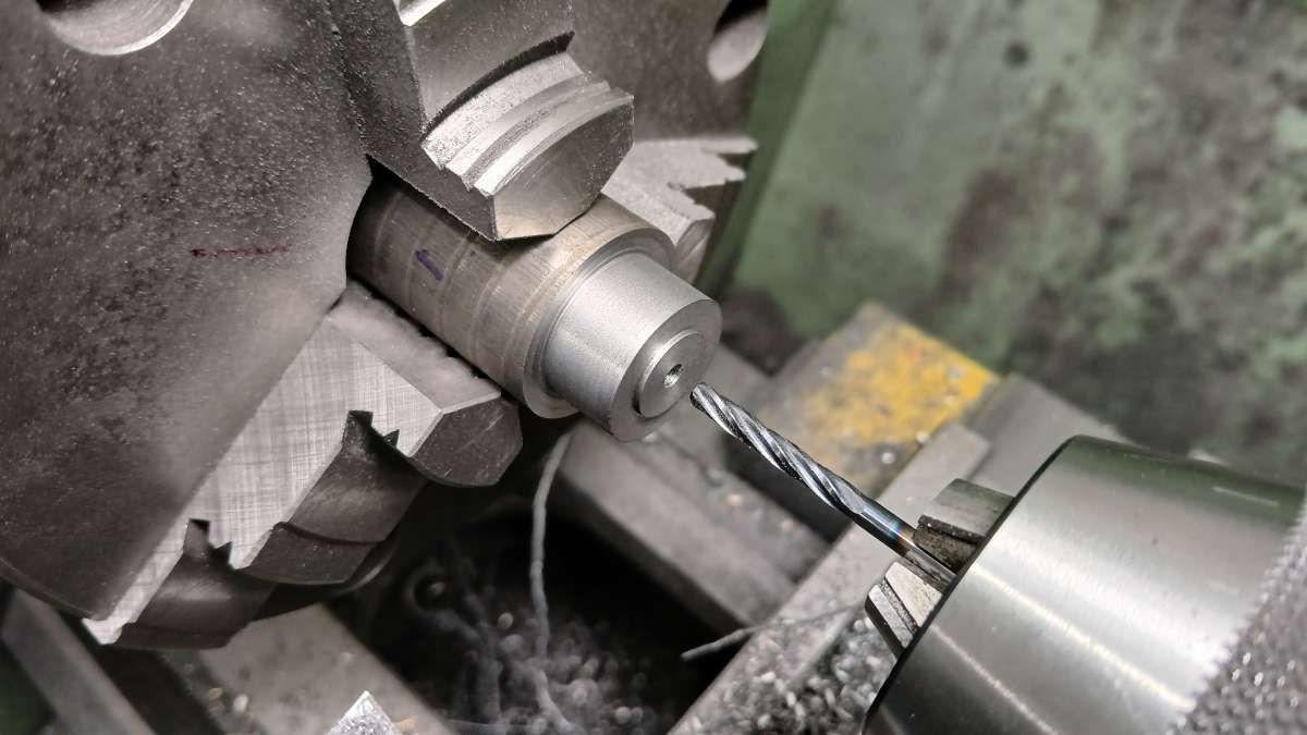

                                  The piston material was then faced and turned 0.2mm over diameter before being drilled & tapped M3
                                  20251230_111940
                                  It was then screwed onto the piston rod for final turning to diameter using the cylinder to gauge the size and a small oil groove added. No photos of the piston rod as it is just a piece of 3mm stainless steel tapped M3 at both ends.
                                  20251230_113422
