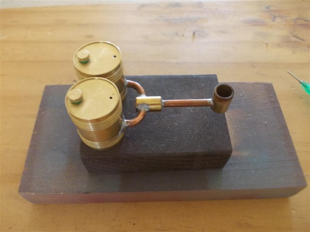

      Problems getting spirit burner to burn correctly.
      #168272
      Brian John
        @brianjohn93961

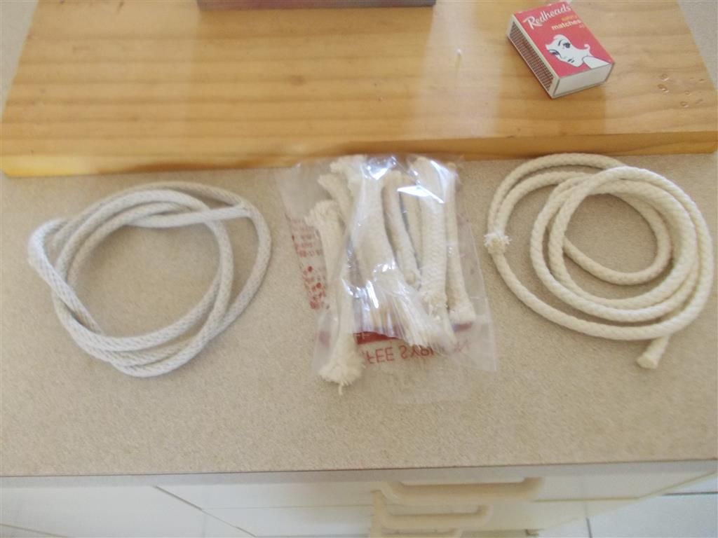

        I have purchased this spirit burner (methylated spirits or metho) from ebay. The wick it came with was quite good but nothing I have purchased from the hardware store lasts very long ; it burns for 5 minutes and then goes out. You can see the different cotton ropes and wicks I have tried in the photos. The correct diameter is about 4.5 to 5 mm
        1. What should I be using for a wick ?
        2. Why did they make the filler holes so small ie. why not a larger hole and plug to make it easier to handle ? Is there a reason for this ?

            Brian John
              @brianjohn93961
              1. What sort of metal mesh ?
              2. No, the wicks are not packed too tight ; it does not seems to make any difference anyway. I have tried both tight and loose, the result is the same.
              3. It is always the right time of the year in Australia I will call around tomorrow to look for glass fibre wicks. I had not considered that before.
              #168282
              Les Jones 1
                @lesjones1
                Hi Brian,
                I do not understand the logic of the design of this burner. For it to work the wick would need to be threaded through the pipe and reach the bottom each container. (Or the one container with the meths in it.) Also the containers can only be filled up to the level of the top of the burner part. If they were filled above this level the liquid would just run out over the top of the burner part.
                Les.
                Edited By Les Jones 1 on 01/11/2014 08:38:55

                  It looks a poor design – the base of the wick needs to be close to the bottom, level of the fuel tank, the top needs to be near the maximum fuel level.
                  The traditional method of filling is a small funnel (as supplied with Mamod!) Don't the big plugs come out? You're not having to fill it through the air hole with the syringe are you?

                    No, the plugs unscrew but they are VERY small and fiddly which is why I questioned the reason for making them this small. A syringe is supplied to fill through the filler holes after the plugs are unscrewed.
                    It worked fine with the wick provided.

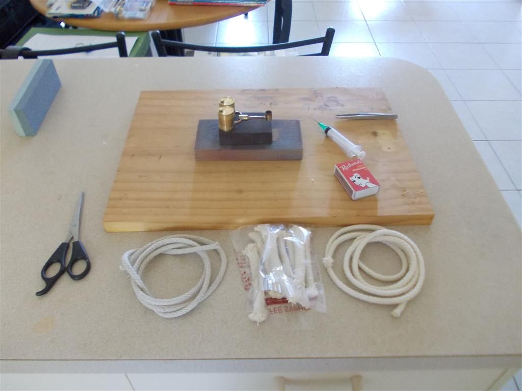

                        I have purchased the fibreglass wick but I am still having the same problem : it burns for 5 minutes then it goes out. There is still plenty of meths in the tanks. The wick also went black and sooty. I did not expect the fibreglass wick to go like that.
                        #169013
                        michael howarth 1
                          @michaelhowarth1
                          Brian….what is the condition of your meths? Alcohol is hygroscopic and therefore takes in atmospheric water and if your meths is anything like the rubbish sold in the UK it will already have been diluted with 10%+ water. As the volatile alcohol is burned off it will leave the remainder with an increasingly larger percentage of water which will not sustain a flame. Gauge 1 afficionados will not use the generally available hardware store meths for this reason, preferring to use 99% industrial meths from a reputable source. So if your meths is old stock you may wish to consider this.
                          How do you manage to relight the burner once it has gone out?
                          Mick
                          #169014
                          Brian John
                            @brianjohn93961
                            With a match.

                              Brian unless there is a wick within the copper pipes to draw up the last of the meths from the two tanks you will always be left with meths below the level of the copper pipes.
                              With the overall height being just 28mm I would think a 5min burn time is about all you will get

                                      A wick cannot be passed down the tube to the storage tanks because the tube branches into a Y shape. At least I do not think it could be done ? The single cylinder burner might have been the best buy because a wick could be threaded all the way through into the storage tank.

                                          I do not think any thought went into the design of this burner. I suggest that you move the pipes that connect to the tanks to the bottom of the tanks and make a new burner tube (The large cylinder at the end of the feed pipe.) If possible the top of the new burner tube should be at least as high as the top of the tanks otherwise the fuel will pour out of the top of the burner if the tanks are filled to the top.
                                          Les.

                                              I have trimmed the wick and done some experiments : the longest I can get it to burn is 10 minutes. That is with 5mls of metho in each tank. As previously discussed, not all the metho is being burnt otherwise I would probably get 15 minutes.
                                              I do not think 10 minutes is long enough. How long does it usually take to get little pot boilers steaming ?
