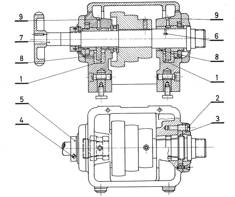

      I'm about to strip down my "large" Lorch headstock to track down a potential lubrication problem, and one of the things I'm girding my loins to potentially have to deal with it replacing the wicking oilers.
      Theses are shown as the cross-hatches parts dipping into the oil reservoirs (1) in the drawing:
      I've seen in other threads that felt is available from McMaster Carr in the US (expensive!) and from Hardy & Hanson in the UK, but I have no clue about what grade I should be asking for. H&H may be able to offer advice (I'll call them this coming week) but any pointers/experience would be appreciated.
      It's a different approach from the more usual felt dripping oilers, in that the felt needs to wick the oil upwards, and I've not been able to find any specific guidance.
      Also, my headstock differs slightly from the one in the drawing in that there are no oil sight glasses on mine, so I'm unsure how far to fill the oil reservoirs – is it enough to be sure that the bottom of the felt is covered, or should I be going up as far as I can without the oil leaking out simply because there is too much….?
      Any pointers gratefully received !

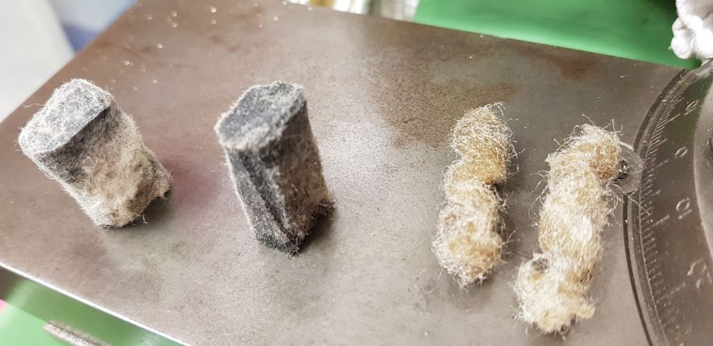

                              So – spindle out, and the oiling felts are oval in section, 10mm x 15mm and have a thickness of ~25mm
                              The other felts were in the oiler ports where the oil goes in – maybe to act as something of a filter to swarf and other rubbish in use.
                              They look in good condition, so I'm just going to rinse them (white spirit?) and re-use, same with the very coarse stuff that was in the oiler ports, although I'm not sure that's actually needed at all.

                                      May I ask where you obtained that technical drawing of the Lorch headstock, please? I have a similar Lorch circa 1920 and I was trying to work out how to adjust the spindle bearings when someone on another forum brought this post to my attention.
                                      My Lorch has been out of action for 6 months because of this! How did you get on with your headstock in the end?

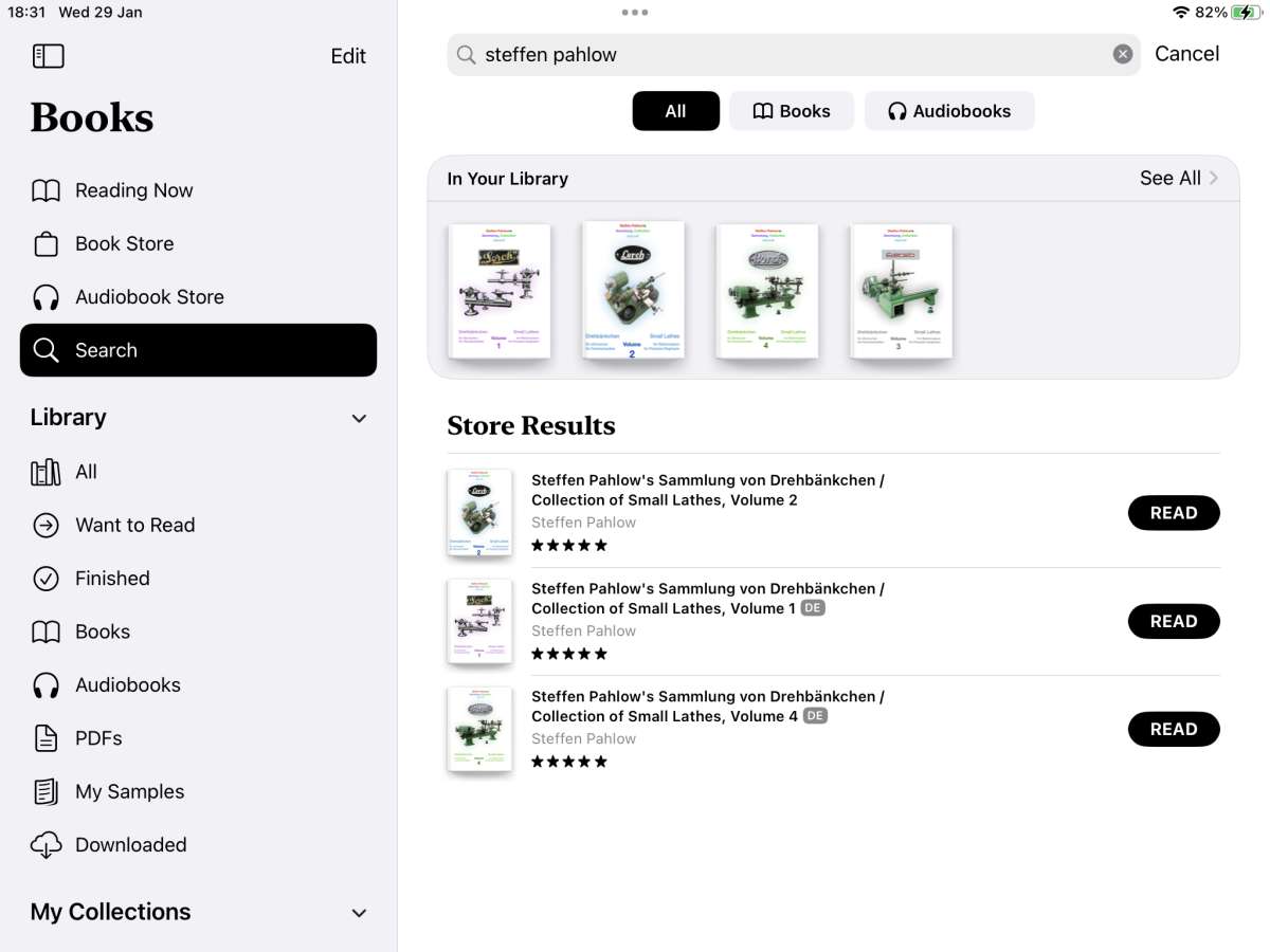

                                        This doesn’t exactly answer your question, but … if you have an iOS device, may I recommend the ‘Books’ publication by Steffen Pahlow
                                        More Lorch information gathered there than I have ever seen elsewhere.

                                              my Lorch (it’s an AVI-RG taking 20mm collets) is in daily use – it’s my main “Large” lathe and it’s wonderful! It’s mounted on a Schaublin 102 underdrive stand with a clutch/brake unit, and I couldn’t be happier 🙂
                                              Sadly, the online source of that sectional drawing is lost to the mists of time – I can say that’s it’s not from any of the manuals from Lathes.co.uk, and I don’t *think* it’s from Steffen Pahlow’s site, although that is indeed a treasure trove of info, although mostly if not exclusively for the smaller machines.
                                              I do have the service manual (for the AVI-K and AVII-K machines) that the drawing came from though, and I’d be happy to let you have a copy of it if it’s of interest. Happy to upload here, but not obvious how.
                                              Does your headstock have the adjusting bolts (ref. 2 in the drawing) visible on the outside of the casting? as long as everything is still round, you *should* just be able to tighten those.
