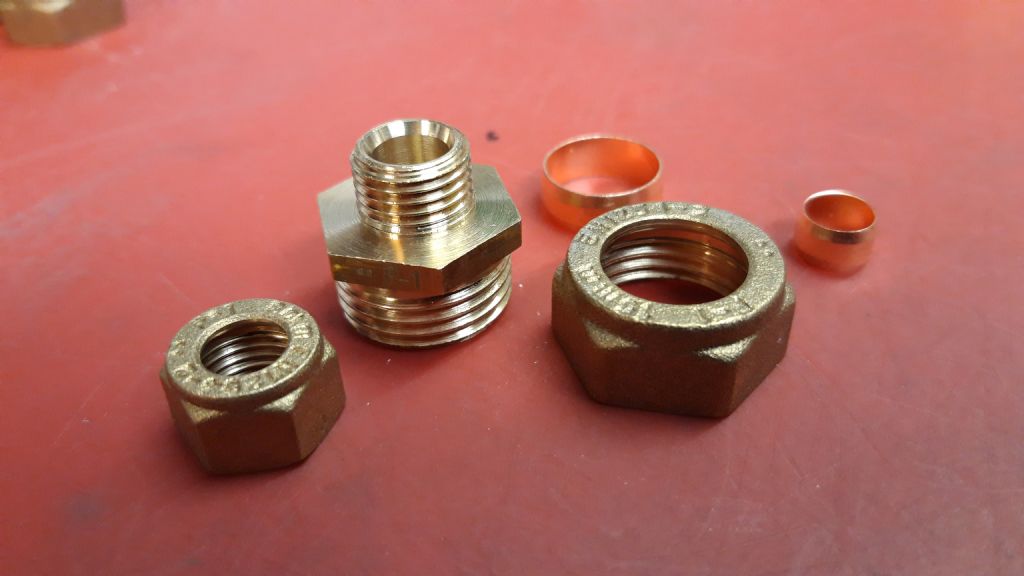

      I bought some brass plumbing connectors today, 1/2" bsp to 1/4"bsp male thread. The main body is machined out of solid brass bar, but the nuts look like they are cast and then machined.
      This got me wondering why? Why go to the trouble of casting something and then machining the threads, using different processes and probably different factories, surely it would be quicker and easier to machine them out of hexagon bar, in the same factory which makes the main body?

          For high volume production (ie millions of parts / year) every gram of metal counts and every second of machine time counts. For plumbing nuts that are only made in a few sizes it probably makes cost sense to make a dedicated cast / machine line for them in Asia. For the fittings, they could be machined in many sizes and so hex bar gives max flexibility.
          Years ago I worked at the Canadian factory of a big US controls company. We had a whole section of the plant making hot water heating valve bodies and all manner of fittings and nuts. I know of which I speak. For 3/4" size valve bodies alone there were 28 variants of fittings sizes / threads to accommodate the world's plumbing needs. We also made 1/2" and 1" valve bodies with a similar number of variants. When I started there the valves were made by soldering machined brass fittings into a centre brass forging. Later we changed the valves to be made by sand casting and I designed the castings to be able to machine all needed threads and fittings in 2 or 3 way valves for the whole 1/2",3/4" and 1" families with 6 different castings. The centre machining was same for all valves the only variation was it was cut a bit deeper in the 3 way versions. Changing to the machined castings vs the soldered machined fittings / forging saved many hundreds of thousands of dollars per year. We produced between 4 and 6 million of these valves per year out of our plant.

            Are they cast or are they hot pressed? Some years ago our club visited a place that was making brass fittings for LPG gas service. They were done in large power presses by heating up a suitable length of brass bar and then stamping it in the press. This gave quite complex shapes with good detailing including quite fine lettering. I think Stuart used to do some of their brass parts this way.

              Whether cast, drop forged, pressed or sintered, you can rest assured they were done that way because it is cheapest. Production engineers spend their careers thinking about such things. I would guess some kind of pressing/drop forging process so you get the stamped numbers etc incorporated and no waste swarf.

                The Halifax plant made brass gate valves – the bodies & gates were sand cast in an on-site automated foundry, the bonnets & gland nuts were hot pressed from brass bar billets & the screws were cut from bar stock on Wickman 6 spindle bar auto lathes.
                The hot pressing made both the bonnet and the gland nut from the same blank. I can't recall how they were subsequently machined. The cast bodies were machined on German multi-station transfer machines (Diedesheim or Vogel IIRC) – the operator removed a finished part, inserted a cast blank & the machine indexed one station and cycled all the 8 or so cutting operations. Every cycle a finished part came off. The machine shop was known as "The Golden Mile", as the floor was encrusted with brass swarf. All the brass swarf went back through the foundry – a hellish place. Hot, dark, dirty and noisy I was glad I wasn't working in there.

                    I can understand economy of scale manufacturing for millions of pieces, still not sure of how the nuts are made though. The surface finish looks like a brass casting to me, a sintered piece would maybe be smoother? Not sure what a hot pressed brass nut surface looks like, but anything pressed on a die would be smoother and more detailed?

                      You can also pressure die-cat brass casting a number on the same runner or sprue. It is quite possible that the texture is some kind of post finishing like rumbling before machining.

                          The double male fitting is probably machined from hex bar( it may even have the hole in ) but the nuts will be hot stampings/forgings. The brass is heated to 3/4s of it's melting temp it's now plastic and can be squeezed into any shape you need. The detail that can be got like this is quite incredible. As has been said, Stuarts use hot stampings for the reversing gear on the 10v and D10. Noel

                            Yes the Male fittings are made from solid bar, probably on a sliding head CNC. I don't think the nuts are hot stamping produced, because they lack the incredible detail, the lettering and surface finish is very poor.

                              What might have determined the use of a casting for a plumbing fitting was the cost difference between a turn/drill/bore/thread/part-off operation with its small quantity of lost material and a load/bore/thread/unload operation with its casting and autoload/unload costs, calculated over a year's usage.
