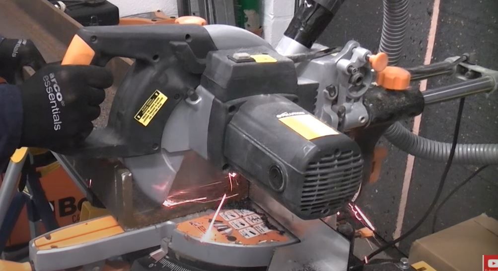

        I'm looking to buy a metal 'stock cutting' saw. The manual hack saw is getting tiresome…
        It seems almost all hobby workshops seem to use either the ubiquitous 4×6 bandsaw or power hacksaw.
        Why aren't modern chop saws used?
        Especially since it seems the modern carbide tipped variety have overcome the dust/heat/sparking of the abrasive type; which is obviously a major deterrent in a small workshop! They're competitively priced too.

              I have an EVOLOUTION chop saw for metal. Fantastic for stuff like steel angle, 1/2" diameter bar, flat bar sections etc, BUT you can easily damage the teeth when cutting 1" dia bar and over. I certainly would not attempt cutting a bit of steel where the section of blade contact was more than 1". Of course, it does cut other metals, wood etc but again, HTS like reinforcing bar does not improve the blade although with care will cut it.
              It is fast, noisy and the chips fly off and safety goggles, face mask and gloves are "mandatory" – even wearing overalls and ear muffs!! However it is compact, portable and reasonably priced.

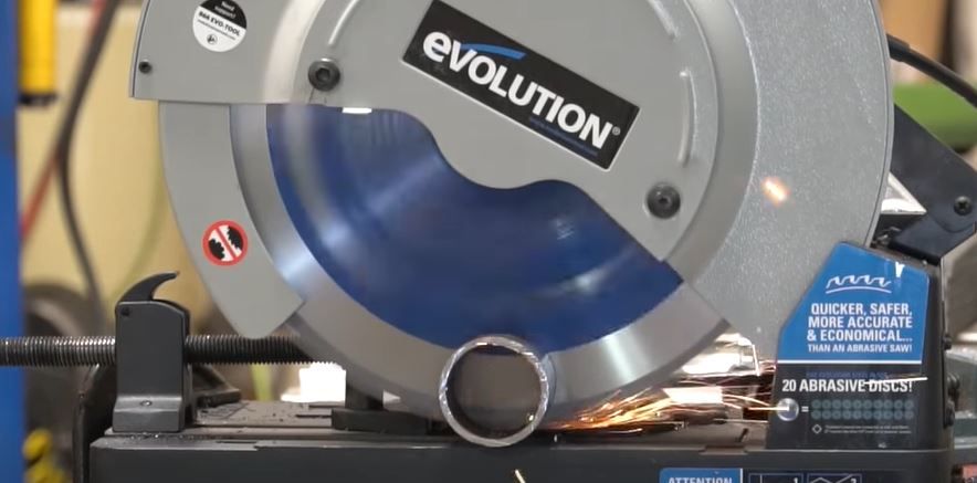

                      I am not sure it is obvious from your post, but that is a very different type of saw to the one the OP has mentioned.
                      It is, if you like, a fourth option, the others being mechanical hacksaw, bandsaw, and Evolution-style machine.
                      You can tell the difference because one has a the motor parallel to the blade, so it is worm drive (cf. Skil saws).
                      The big difference is that the Clarke one uses a fine tooth HSS blade, like a large diameter slitting saw, and needs flood coolant to clear the chips and preserve the blade.
                      The Evolution-type are dry cutting and have a much coarser blade and are considered cold-cutting. This is important if you are in an industrial environment with a hot works permit regime – they do the same work as an abrasive saw but without the added hassle.
                      The dry/wet cutting might be an important consideration for a home workshop.
                      The carbide blades on the Evolution-type are generally not sharpened and being coarse are not versatile. The HSS blades can be sharpened.

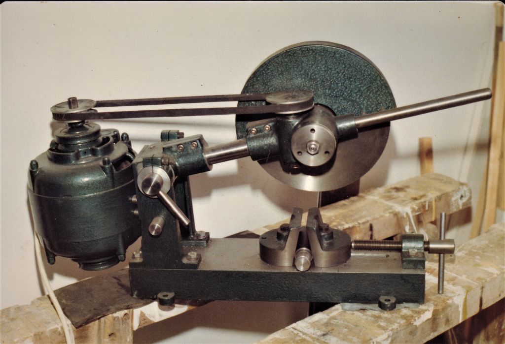

                              A long while ago I made a worm geared drive HSS cutting saw, but it just did not have the rigidity and power required. The blade cut but it chattered badly, so I discontinued my efforts. It was never going to work as I dreamed it would.

                                    I have an Evolution 255mm carbide cut off saw, they do several so the blade size might be important.
                                    Astonishing! The first thing I had to cut was 20×50 steel, whilst not like wood it was very close. I have cut many things with it, steel and aluminium.
                                    What it won't like is flaky rust. Had to top and tail dozens of square section steel tube, about 40mm by 3mm thickness. Blade was blunt after a few, a new blade only lasted about 10 pieces. It seems to be like the problem of oxy acetylene cutting of rusty steel, it is impervious to the flame and won't cut at all. A film of rust as on storage surface marking is ok, but definitely not anything that looks flaky.
                                    The other thing is the life time and cost of the blade, above comments but I have got through about 6 in 20 years, but compared with a hacksaw it is no competition.
                                    I also have a slow speed saw with the 80 tooth 10" blade. Brilliant, but gearbox failed, bought another secondhand and as AJ mentions, this one chatters, can't find out why.
                                    The real problem I find with these saws is the vice, will they securely hold a short length of metal. Had a big hacksaw but unless the metal was 10" long it wouldn't grip, and even then it was forever slipping. Not certain angle adjustment jaws are really worth the pain.

                                          Also watch out that the TC saws can throw sparks, both types of the Evolutions saws do it
