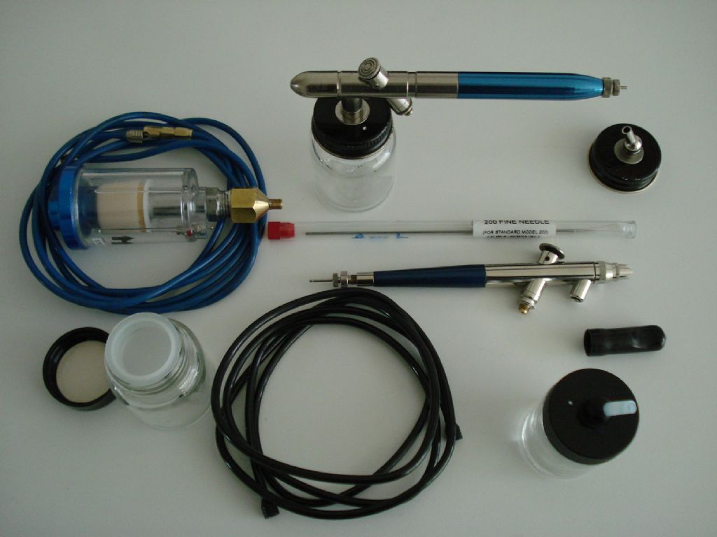

                  The problem with airbrushes are that some especially the cheaper ones do not have changeable needles and nozzles which means that any medium that is sprayed through them needs to be thinned quite a bit. I have only ever used them for decoration on some turning that I did which was fine..
                  Something along the lines of this type I would have thought a better prospect for larger areas.

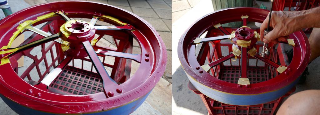

                      You could spray paint a 5" gauge loco with an airbrush but they are not realy suitable for large areas. I used one for painting the spokes on the wheels of my 6" traction engine but only on the small black section using signwriters enamel paint. The main parts of the wheels were sprayed with 2K paint usings a touch-up (small) spray gun. (available from auto accessory suppliers for less than $50). (pin stripes done with Beugler roller)
                      One of the problems with airbrushes is that the paint has to be thinned more than with a bigger gun to go thru the smaller nozzle. To get an even surface, the overlapping layers of paint should be wet so that they blend together and 2K paint dries very quickly and on a larger surface with an airbrush may not do so.
                      Why not try a test to see how well your airbrush covers a similar size area as on your engine ?

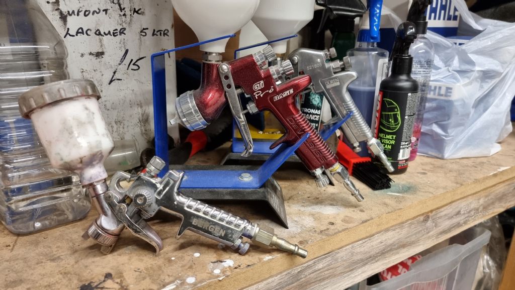

                                              Steviegtr
                                                @steviegtr
                                                I have a few spray guns, but the front small one would be perfect for small items. I have used this gun for small patching & painting of motorcycle wheels. It was something like £20. Made by Burgen.
                                                Steve.
