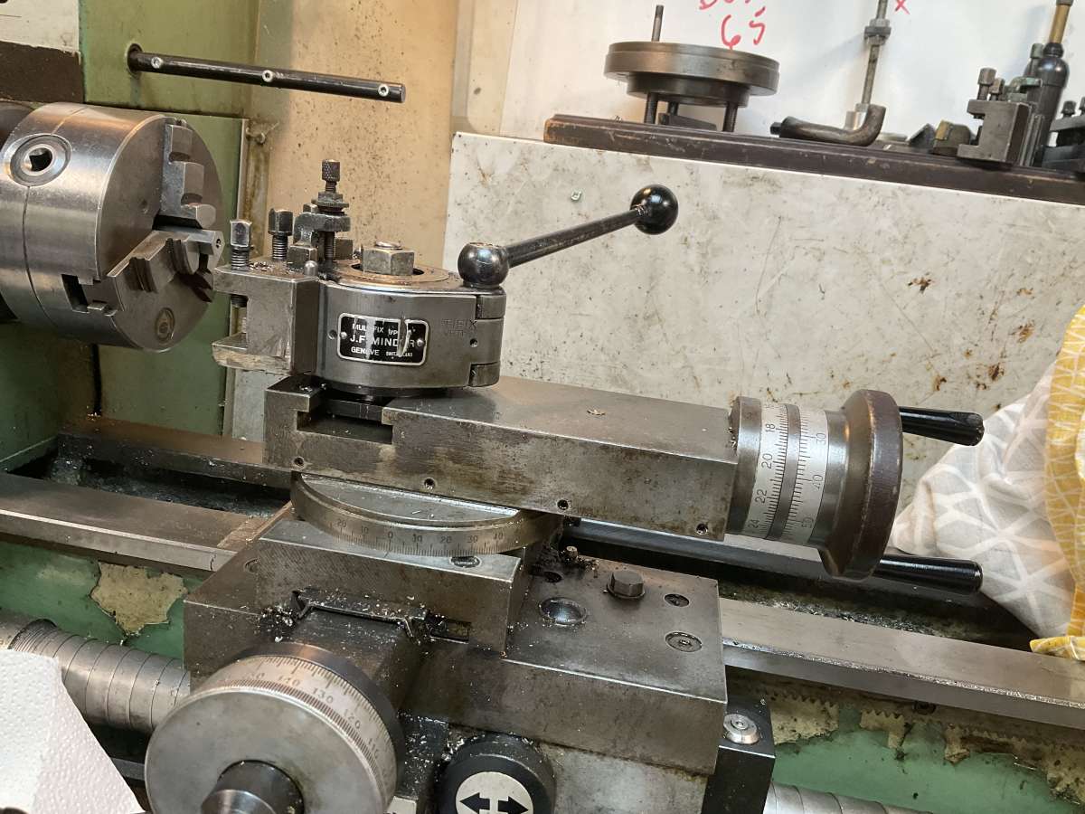

                On my 254+ I swapped the compound slide with one from a Colchester Chipmaster / Bantam which is near enough 1/2” lower in height than the original Myford item, this then allows me to use the multifix size A system. Other benefits include a smoother action and a bigger hand wheel / micrometer dial. A very worthwhile improvement!
                #745950
                Durhambuilder
                  @durhambuilder
                  IMG_1016
                  #745962
                  Dave Sawdon 1
                    @davesawdon1
                    That’s an interesting idea. How much work was involved in the swap?
                    #745966
                    Durhambuilder
                      @durhambuilder

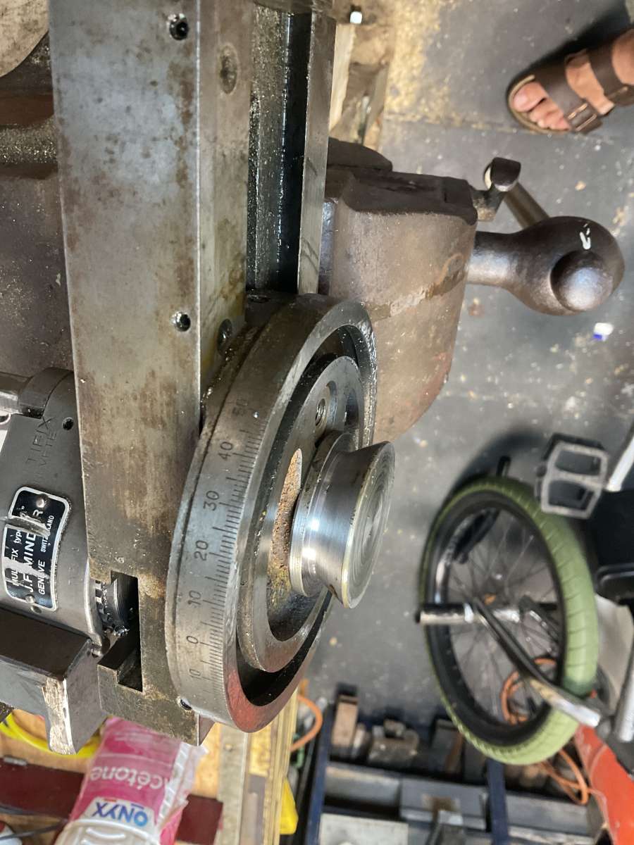

                      The Colchester compound had a 1” or so hole in the base to locate on a spigot on the original top slide, I bored this out a little more and threaded it 16 tpi, a spigot was then turned to suit the dovetail mount of the original Myford slide and this was screwed and loctited into the new base. Whilst it is a one way trip for the Colchester part the Myford is completely unaltered and the compounds can be swapped in a minute or two. The top of the Colchester compound sits 1.963” above the mounting surface. I already had the spare Colchester top slide so the only cost was about 2hrs hour of my timeimage

                        I’ll have a look at the 254 tonight (I can’t remember what the top of the cross slide looks like) and then start looking for a Colchester top slide at a sensible price – that might be where the idea collapses.
                        Do you know whether all Bantams and Chipmasters have the same top slides?

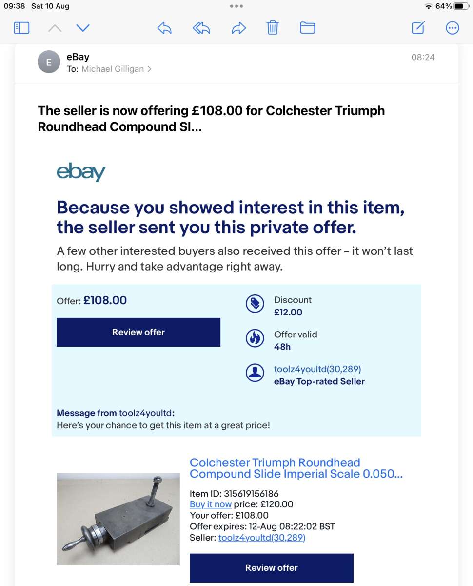

                          I predict that the ebay price for those Colchester slides will escalate rapidly !!
                          That’s a very nice upgrade.

                                  #746251
                                    Probably reduced as it looks to be missing the ability to swivel as it is just the two sliding parts.
                                    #746254
                                      which might make it ideal [and reasonably priced] for the proposed adaptation
                                      … but what do I know ?

                                                You won’t regret it! I seem to recall an obscure grub screw that holds the bronze nut in place for the feed screw, removal is the key to dismantling the topslide then you just have a round base on hold in the chuck for threading.
