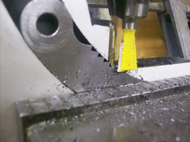

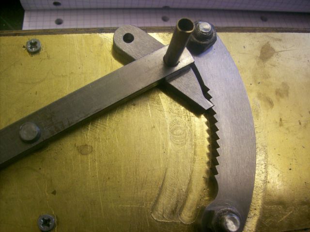

      I've just finished making handbrake parts for a 1947 Humber Hawk Series 1, the toothed quadrant and the mating pawl, from 1/4"gaugeplate. After much careful measurement (not easy, given the badly worn state of the originals) I knocked up milling jig No. 1 and set to work producing the quadrant shape.
      Jig No.2 then produced the teeth ….
      using a carbide tipped routerdovetail cutter, which worked suprisingly well.
      Then jig No1 was re-used to check the pawl shape, using a piece of bar drilled at the correct centeres to represent the handbrake lever …
      Now I have the machined components and it's time for hardening and tempering. Data on the gaugeplate wrapper suggests 780 – 820 degrees for hardening (held at temperature for 15 – 20 minutes, Tubal Cain), then quenching in oil. Tubal says engine oil gives variable results, so which oil is best ? I don't do much hardening so don't need gallons of the stuff, and I'd like it to be very reasonably priced. Any suggestions ? Your help will be much appreciated,
      Thanks,
      Ken.

                Ken,
                Gauge plate is formulated to minimise distortion. Quenching in oil has a reduced cooling rate compared to water (or brine) which also helps to keep distortion at bay. I've successfully used straight SAE 30 oil (new!) but there are several references on the web to using vegetable oil. I think the cheapest cooking oil in the supermarket will do the job admirably. I don't suppose there was anything magical about whale oil – before the mineral oil industry took off I believe it was the only none gumming commercial oil available in bulk, much used in oil lamps. I would imagine that the most important part of the formulation for commercial hardening oils is to give a long life – something that is probably not relevant to our usage.
                Nice bit of machining by the way,

                  Some useful tips there chaps, thanks. Commercial H.T. companies are out; too expensive, so it's a DIY job alright. I like the idea of using cooking oil; I'll look for web references, as Rod mentions, before jumping in. And yes, edgewise immersion too. All good thoughts,
                  Thanks again,
                  Ken.

                                                      Thanks to all respondees and the wealth of your collective experiences. I can now report that the parts have been successfully hardened using Sunflower Oil ! Very cheap and available anywhere, it was chosen after various suggestions and some reading of articles on the 'net. Heated to dullish red for a few minutes, parts were then dunked with vertical agitation. They are certainly hard, and black deposits were easy to clean off, mostly by wipe, then a brief rub of emery. The oil is now back in the bottle but appropriately labelled and permanently removed from the kitchen at my wife's insistence, though in truth I would happily use it for a fry-up (but then I couldn't use it for subsequent hardenings, could I ?). Annealing was carried out at 200C for one hour, in line with the supplier's suggestion, so was simple to do in the domestic oven. Reassembly of the handbrake is scheduled for tomorrow.
                                                      I too was pleasantly suprised at how well the router cutter performed. After all, there is a world of difference between a tough wood and gaugeplate, but I thought to myself 'carbide tipped, so worth a try', and glad I did so. The cutter was barely worn at all afterward, even on the outermost sharp corner, which I had expected might quickly be destroyed, but no. It's given me confidence to consider other uses for router cutters, with their fancy profiles, and I hope you too find they help solve a problem.
                                                      Regards to All,
                                                      Ken.
