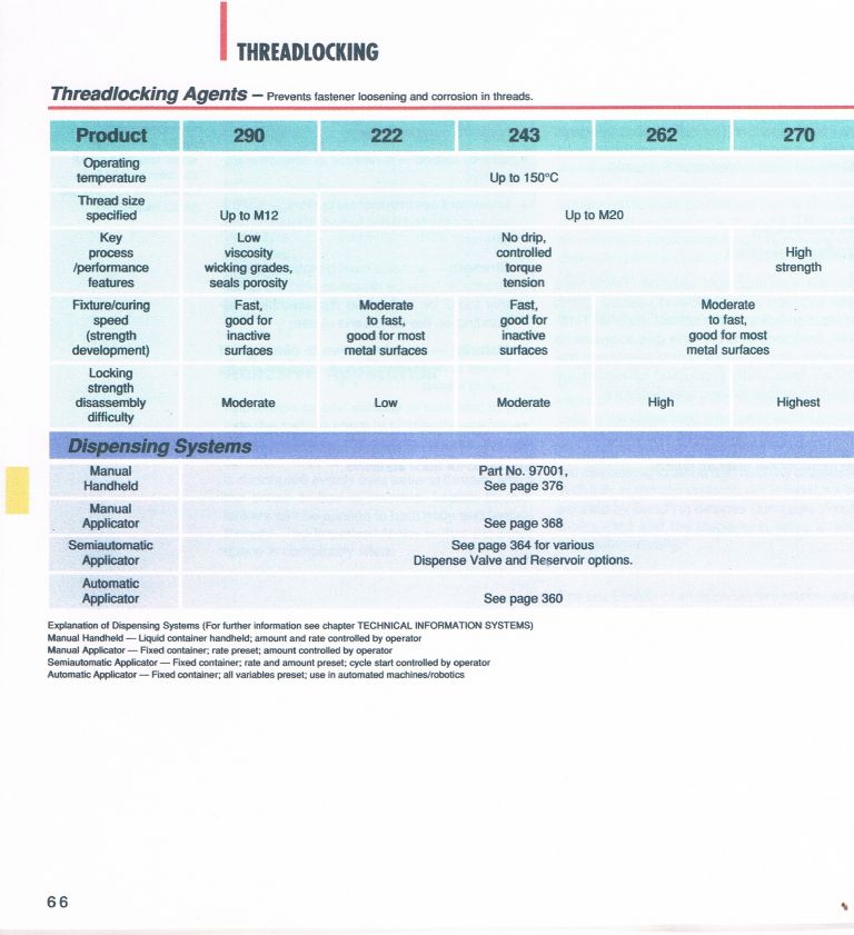

                                      Thank you everyone for your helpful explanations, seems like ‘blue is the colour’

                                        Oven Man
                                          @ovenman
                                          Here is a page from the Loctite book that might be of interest.
