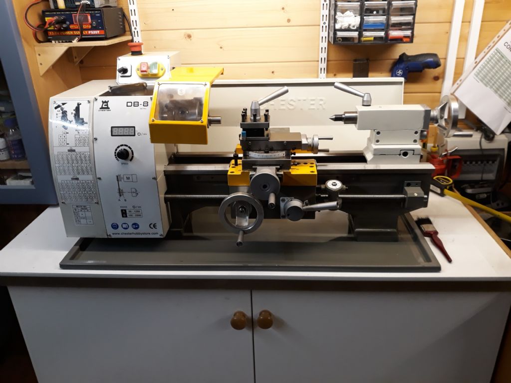

                            I have just recently purchased a Chester DB8vs and I am impressed with the precision. The chucks runs pretty true, much better than the one on my Emco compact 5 I had before (for 38 years). The jib strips were all set up, no adjusting necessary. Little backlash in the handwheels. So it was just cleaning. Reading several comments of people who had to rip half the machine apart to set it up properly – not at all necessary here. I start liking this machine. The bed is pretty stiff, parting steel no problem. There is plenty of power, but the motor is noisy. It is not a brushless synchrone motor.
                            By the way, after my positive critisism (except the noise, but I am even getting used to it) of the DB8vs I have to say I am not born in China but in Austria – the land of Emco.smiley
                            Price: you will need a few extras, even the accessories coming with the machine are plenty (fixed and travelling steady, independent 4 jaw chuck, self centering 3 jaw chuck, centers for spindle and tail stock and even some carbide tipped tools.
                            You will need a live center for the tailstock, a drill chuck for the tailstock, and if you want to attack smaller stuff also a collet holder and collets (lucky me, I have a mill and I found a collet holder which uses the same size – this saves some money). I also purchased a quick change toolpost and some holders as I am spoiled from my old machine, which had also one. So whatever you pay, consider a couple of hundrets for accessories.
                            And: look for a stable workbench. I use a good quality kitchen cabinett which is strong enough. Think also about transport of the lathe to its final position. It ways 110kg net, in the box with the accessories it is 130kg.
