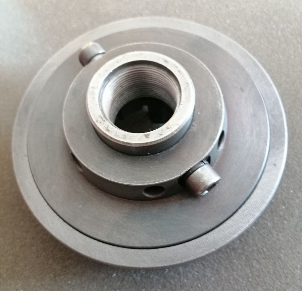

      In my collection of things that seemed a good idea at the time, I have a lever operated 4 jaw chuck that has an integral thread which seems quite fine in comparison to most lathes I know of.
      The chuck is German, made by Niles, so I assume it a metric thread 32×1.5p
      Does that size ring a bell with anyone?

        Or could it be 1.25″ x 16 tpi

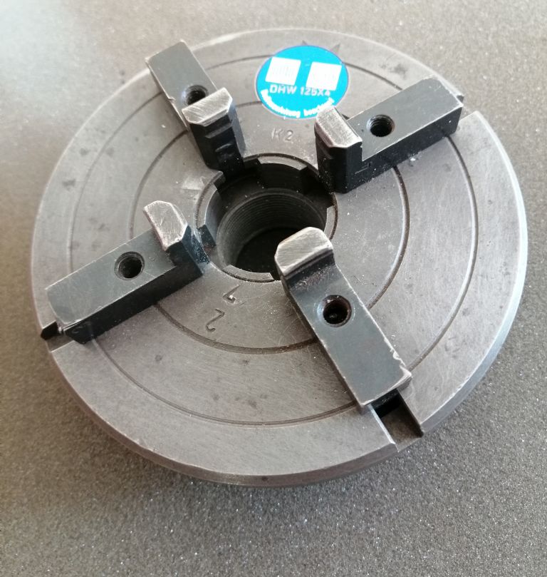

            Definitely not a power chuck!
            Its quite lightweight and unusual in that the the (reversible) jaws are inserted from the centre bore outwards.

                  Lots of wood lathes have a 16tpi thread, but usually smaller diameter and not lever operated, which is also less common for this diameter. Perhaps made as part of an engraver general fitting pack where a large diameter might be wanted but minimal force.

                        I borrowed a thread gauge so now I know it is 1.5mm pitch.
                        Still looking tor what it might fit and find someone that wants to buy it.

                          I have done a (small amount) of digging on this, mainly because I have a bit of a "DDR fetish".
                          Googling the visible model number on the picture above gets several pictorial hits in German, most being obsolete sales listings. Obviously used examples are frequently heavily sawdust encrusted & there are couple that are shown attached to woodworking lathes. This listing includes a picture of the original chuck box, with pictures of turned wooden objects & also a picture of the chuck that I think I can see an adapter bush fitted into the back of the chuck – the faceplate alongside has a much smaller mounting thread.
                          So it may be that the M32x1.5 thread is provided to make the chuck a "universal" item, being adapted to fit the lathe spindle nose with a bush (M32z1.5 outside, lathe spindle thread inside) as required.

                            You did better than I did Nigel! and it confirms it is a woodturning chuck.
