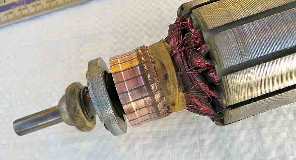

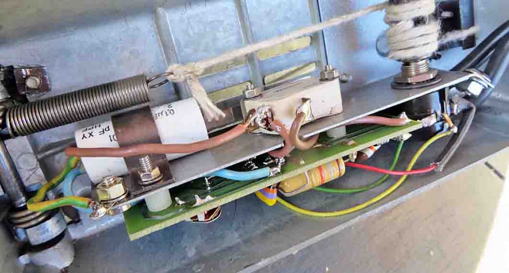

                                  Here are 2 pics of the pedal and commutator:

                                    Looks like it may be a home-made speed control board, probably thyristor or triac based. Would definitely need a suppressor then, but only for interference. Commutator looks very worn. If you have a low voltage power supply, say 12V, or even a car battery, the motor should run on it albeit slowly if it's OK.

                                      Commutator does look a little worn! Probably best to go sewing machine motor route. Dave W

                                        by the look at that com the motor as earned it's retirement

                                            Condensers are placed in parallel to commutator segments to dampen spikes that both generate EMI or could damage a controller upstream. I was taught in similar applications that if they go out, you might also get premature wear out of your carbon brushes, but some would differ on it. Looks like the brushes are gone and you were down to the metal, which might be why it's not running correctly.
                                            I'd try getting a new motor like they suggested, or you could turn down that commutator and get some new brushes installed. I've installed brake pads on bad rotors and had them break in ok. hehe

                                              Hi, the commutator does look bad, but I've tidied up some worse looking ones and they have worked OK, but it would pay to check the continuity of all the coils and segments before wasting any time truing the them up and it will need new brushes fitted.
