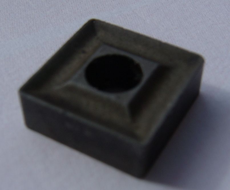

      As I now have my Barker lathe set up I am beginning to practice taking some cuts, experimenting with speeds and cut depths
      Obviously I have made a few errors during these learning moments and have half broken one of the tools tips, the one one the knife tool
      My set of tools are these:
      I have messaged the seller but he has not responded. I took them along to the Harrogate Show but no one had any to match
      They are square, measuring 10.2mm per side, with 0 degree relief and a single groove on the top side. They are secured by a detent mechanism, basically an upturned L which is locked by turing 90 degrees
      I have spent ages searching online but just can’t find anywhere in the UK selling these tips
      Can anybody help please?

                      #54443
                      John Coates
                        @johncoates48577
                        Dias – thanks for the link to Excel Machine Tools. They want £33 + VAT + P&P and I only want the square inserts, not a full set so Gulp !
                        So far I can work out that mine are SN*M (Square, 0 relief angle, single groove with straight through hole) but I’m getting stuck converting the imperial Size and Thickness to metric from my measurements
                        I measure 10mm sides, 3,6mm thick and 4mm hole
                        Is this 303035 ?

                              #54473
                              HasBean
                                @hasbean
                                Hi John,
                                As the inserts have zero clearance are they double sided or just single sided for neagtive rake machining?
                                Any chance of a closeup picture of the insert?
                                Paul
                                #54475
                                HasBean
                                  @hasbean
                                  I have the Sandvik Technical Data chart in front of me but without having the insert to hand makes it a tad tricky.
                                  Guessing at;
                                  S               Square inset
                                  N               Zero clearance angle
                                  M or U      Tolerance of inscribed circle (ie don’t worry about it)
                                  M               Guessing at single sided insert with positive rake held with pin not screw
                                  09              Closest to given measurement at 9.525mm (next is 12 at 12.7mm)
                                  T3              Closest again, T3=3.97mm, 03= 3.18mm
                                  XXXX          = Nose radius ie 0.2,0.4,0.8 etc
                                  So could be; SNMM09T304 (for 0.4mm radius) etc
                                  In tha past I have phoned Peter at Greenwood Tools who has been able to supply me with just about any sort of insert in any sort of grade and has been more than helpfull (usual disclaimer)
                                  I seem to remember that you could send Greenwood an insert and they’d be able to identify it for you and suggest an alternative.
                                  Hope I haven’t confused things too much
                                  Paul

                                      #54512
                                      John Coates
                                        @johncoates48577
                                        Hi folks
                                        Here is the tool tip – a good one taken off one of the other tools. I have checked my measurements again and found that the top of the square measures 10.05mm per side and the bottom 10.00mm per side so there is a slight rake (clearance). On the underside there is a slight recess (counterbore) around the hole but it is very shallow and I can’t measure it
                                        Over to you
                                        t
                                        #54532
                                        KWIL
                                          @kwil
                                          I have checked a number of manufacturer’s list for these sizes and do not find any matches. Either the measured size is wrong, but you have no doubt been careful or else you have been sold some cheap non standard item.If your supplier cannot/will not help then you may have to start again using a reputable source such as Greenwood as mentioned above.
                                          #54536
                                          John Coates
                                            @johncoates48577
                                            KWIL – you may be correct about the cheap non-standard item
                                            When I put the codes of the three knife tools into Google (PSSNR1215H09, PSBNR1215H09 AND PWGNR1215H06) I get results for several Chinese manufacturers offering bulk sales (1000+ units) of the nine piece set I bought
                                            Going to their websites does provide product numbers for the carbide inserts, namely 41005V, but no UK stockists
                                            Seems like my only choice is to replace these tools with better ones where I know I can get replacement tips as well
                                            Bugger! More expense when I could be buying metal
                                            #54564
                                            KWIL
                                              @kwil
                                              Regretfully you usually end up getting what you paid for, in this case not a lot. Stick to ISO inserts and buy the toolholders to match.
