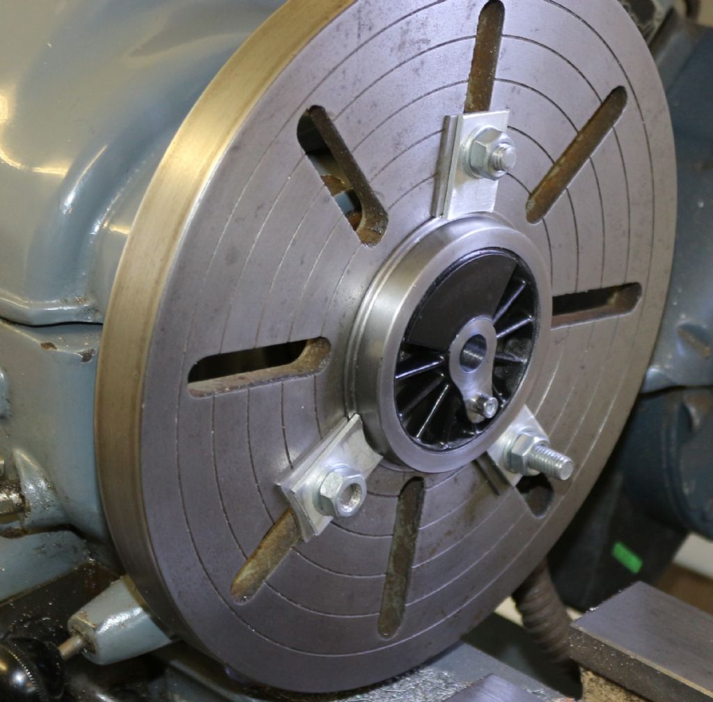

      I am building a 31/2" Lifford Hall loco. I fear I have somehow managed to get one of the driving wheels running out of true. I machined the axles between centres and used loctite to secure the wheel. There now appears to be about 14thou sideways (lateral) movement on wheel at the outer edge. The tread is concentric to the axle. I fear I may have not gone through square with the reamer as I did suspect a bit of lateral movement before loctiting but assumed it was the clearance between the wheel and axle prior to fixing.
      What puzzles me is that I used a jig set in lathe to machine each wheel.
      I really don't want to start another wheel so am looking for suggestions/advice on the way forward. My initial thought was to drill out the axle and somehow set the wheel up and bore out a few thou remake the axle and hope.
      Things were going well up to this point!!

          For an accurate fit I always prefer to bore as you can size the hole to whatever needs to fit with a loctite joint having a smaller hole than say one in a bearing.
          Drilling then reaming particularly into a casting is also prone to problems as any hard spots, voids, etc in the casting will cause the drill to wander and then the reamer will just follow the path of the drilled hole.
          You could possibly bore out the wheel and loctite in a piece of bar and then bore that out to fit your existing axle.

              Unfortunately, It feels like deja vu. I had almost exactly the same snag with one of my Rob Roy wheels. I ended up cutting the axle and reboring on a face plate. I also had to make a wheel quartering fixture because I fouled up the quartering on the lathe.
              As Jason has explained, I suspect reamers can sometimes follow the drill and produce a wobble on locomotive wheels and other similar parts.

                        I would feel tempted to recover the situation by boring out the wheel, and Loctite in a bushing which can then be bored to correct size for the axle.

                            Boring out and bushing, as Howard says, will be the best solution. The only drilled holes I would trust would require a solid carbide drill.

                              Looking at the photo of a wheel on a myford faceplate,my method is to rough machine the wheel,and leave the width of the flange oversize , then grip the wheel flange with soft jaws in the 3 jaw chuck,then machine to size the wheel tread ,the inner side of the flange ,face off the front of the wheel rim and boss and then drill,bore, and ream the axle hole,only leave about 5 thou on diameter for reaming, I know that leaving small amounts to be removed by reaming is supposed to cause the reamer to rub and wear,but I have found that it produces good results,and only a few holes are being machined,its not production .Better to loose a reamer than expensive wheel castings. the wheel can then have the back faced off and the rad on the outer rim machined ,the important bit of this method is that the the critcal machining is done at one setting,with good concentricity and no wobble.
