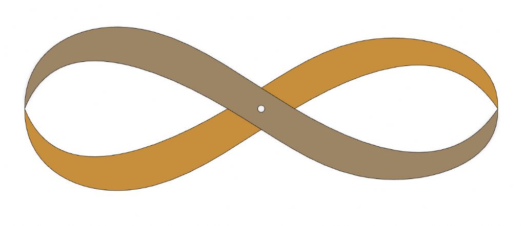

      I need to measure the thickness of something that is surrounded by a raised border thicker than the item I want to measure. A calliper like this would do the job, but I don't know what its called and can't find anything like it. Any ideas?

          Double ended caliper.  lots on ebay, Amazon, Proops, RDG tools etc

            Dunno what it's called – maybe double-ended caliper – but why not just make or find a flat piece of known thickness greater than the depth of border that fits inside the border, insert it, measure the total thickness, then subtract the thickness of the insert?

                  Thank you. I tried X-calliper and cross-calliper. I didn't think of 'double ended'.
                  Mick: Unfortunately, the item I need to measure is on a curved surface.

                    Try Axminster Tools Under Woodturners Calipers
                    #633756
                      I need mote Coffee … I’s just taken me five minutes to realise that Gary’s illustration represents the shape of the calliper, and is not a drawing of a Möbius strip blush

                          A friend wanting to measure the thickness of his car fibreglass bodywork made a lash-up double ended caliper with a 80cm throat at one end and a 30mm stroke dial indicator at the other. He made a calibration table to interpret the readings.

                                Such double ended calipers are used by cylinder-head modifiers on car and motorbike engines for measuring how much thickness of metal is left between an enlarged port and thin air or the next port etc when grinding out the ports. So might be available from automotive tool suppliers.

                                                  You will find several choices of the type you sketched Gary if you search Amazon for "Figure 8 Caliper"

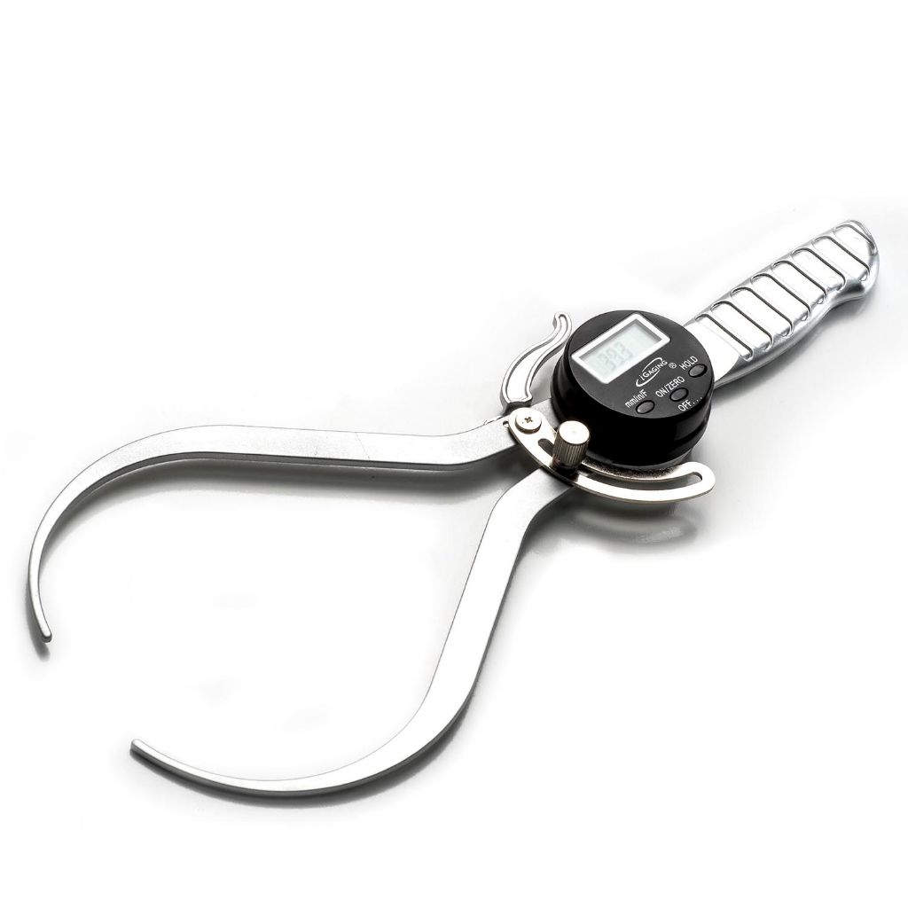

                                                    And if you do a google search for "Digital outside calipers" you will find this interesting mix of new and old tooling. Internal version is also available. Looks very handy for measuring oddly shaped things. And not very expensive at circa 30 Quid.digital oustide calipers.jpg
                                                    I have seen the figure 8 type referred to in an American cylinder head porting book as "indicating calipers" but a google search shows nothing under that except normal digital calipers and the above.

                                                      THESE are used by woodturners they are not double ended as your picture and yes they are expensive but they do have a metric scale to read off.
                                                      I have a set for when I am turning hollow forms
