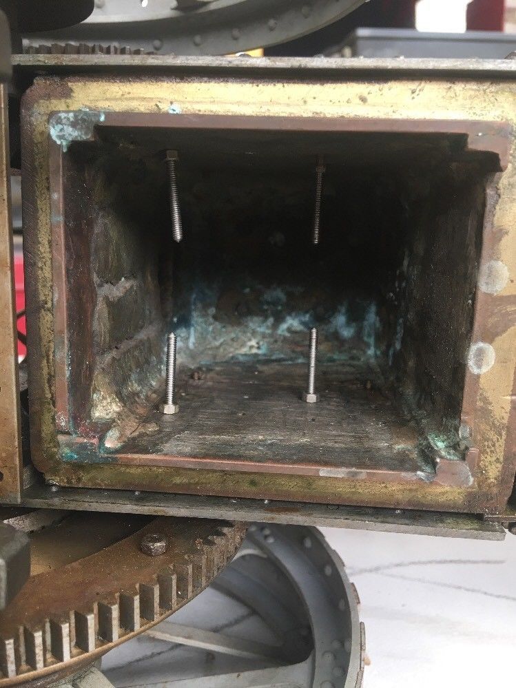

Looks like there are 16 hollow stays each side and the hornplates have just been put on with a couple of screws through 2 of the holes during construction. Whats wrong with that?
Similar to my 2" Fowler boiler made by a professional.
