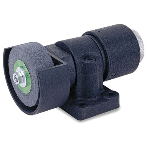

      Hi, I will need to sharpen occasionally some carbide gravers / cutters at some point. My research has led me down the route of using a diamond wheel followed by a fine diamond lap. However when I look online at diamond wheels they come either as a solid disk like a standard grinding wheel or as a cup with a diamond external ring.. Can someone explain my best route and what is the different uses of these wheels. Also are the Ezelap stones good, do they need water or oil and what grade(s) would be a good choice.

          Hi Chris I have a flat faced square cup wheel and an adjustable angle steady. I can grind most tips and carbide faced turning tools.

            Hi Chris, I would use 400 or 600 diamond laps to finish with and water with the merest hint of detergent in.

                My latest research is to buy a set of 50mm dia lap wheels which I could mount on my Sherline lathe and run at a slow speed. I would need to cover / protect the table from debris and also make an angle secondary table to give me the angles required. It's not as good as David's but for occasional use is it a sensible idea?

                  I use the lap wheels at 400rpm for sharpening carbide scrapers. You could probably go up a bit in speed for a 50mm wheel. Use some kind of solvent to cool/clean the disk as you use it.

                    Hi Chris I find that you get a better flat angled face for the cutting face as a wheel with a curved face gives you curved face and you cannot controle the angle on the tool to get a finish. Also when you grind or regrind a tip the shape is better.

                      Hi again Chris Just thinking about what you are saying about solid diamond wheels my wheel is just a different shape to a round wheel but diamond wheels are all bonded on to an alloy wheel base as a diamond substrate would not have enough strength for speed and pressure and would cost a fortune in diamond material.

                                  Thinking about mounting diamond laps yes you can use your lathe but I just don't like the idea for reasons of accessibility and possible ingress of debris.
                                  having said that a machine such as the Accu-Finish is expensive so for my limited use I am now minded to build a cheapish stand alone sharpener. I will investigate whether it is best to use say a converted electric drill already with a chuck or an electric motor that I can adapt. Any ideas on this front always welcome.

                                    I was lucky to pick it up for about £18.00 on ebay and made a better rest for grinding lathe tools. The original wheel was damaged with a chunk out as though someone had jammed a cutter. It was local and had been used in a shop to sharpen engraving tools for making labels and as I could pick it up so no carriage. You never know what is out there.
