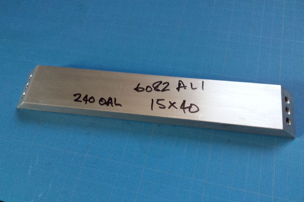

      20191008_172533.jpgI have made one of these but I need to make several more.
      The two end faces are at 45 degrees and have to fit closely between other faces on an existing manufactured product which has clearance holes for the three tapped holes in each end.
      I can set the part up to mill and drill/tap each end but I am stuck knowing how to position them accurately. The sloping face is just over 21mm wide but the holes need to be offset slightly but its hard to measure to an edge which is not at right angles.

        They are on sloping faces

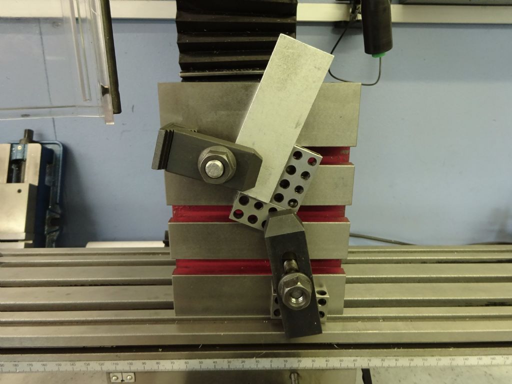

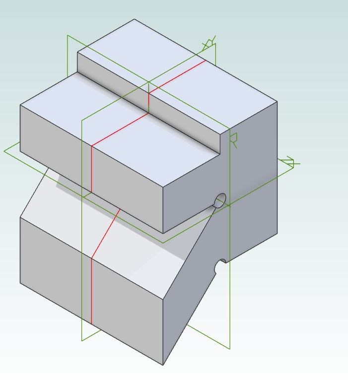

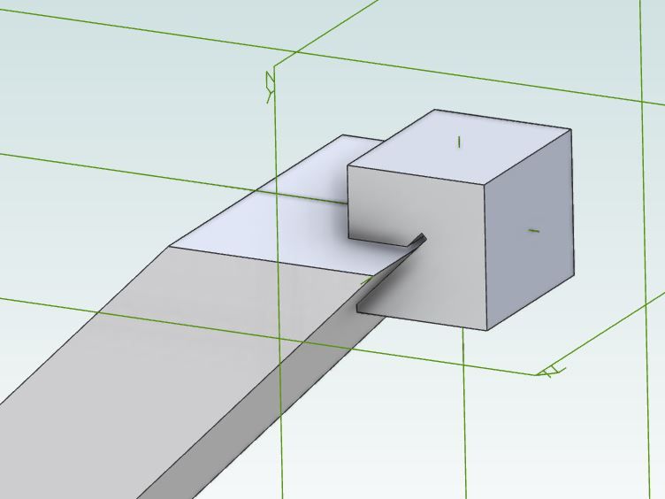

                      You could always make up something like this which would then give a vertical edge to touch off against, two slitting saw cuts across a bit of say 1" wide material should do.

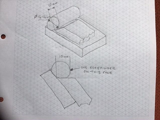

                            Dovetails are measured with cylinders to avoid problems like this. Do you have any silver steel or other ground rod that could be used against the angled face to allow more accurate measurement?

                                Don't need to go wasting metal making L shaped jigs when you have a pair of Uncle Ketans blockswink
                                Or the little jig I mentioned above

                                      Posted by Martin Connelly on 08/10/2019 19:39:29:
                                      Martin C
                                      Trouble with rods etc is that its fiddly holding everything in place, Balamy Blocks solve that.

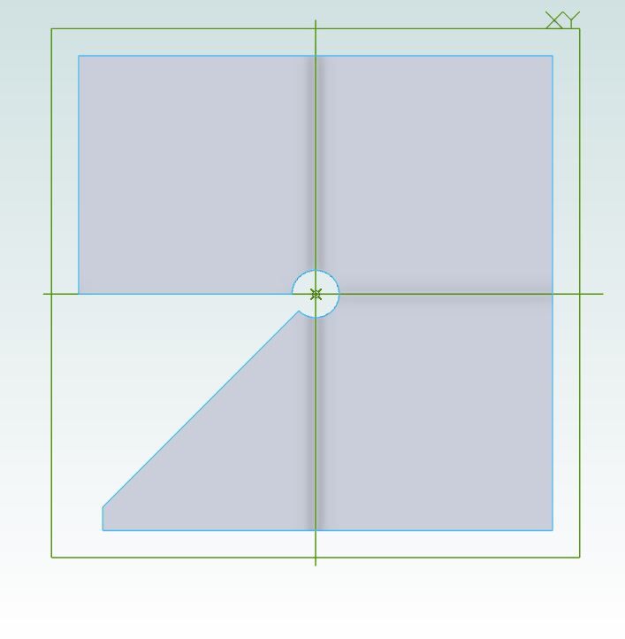

                                        Rods also need to fit into a Vee to be of any use.
                                        MK2 JBBlock. 20 x 20 would make it easier to just knock 10mm off the indicated edge, hole will clear a burr thrown up in either direction.

                                            what do you think of the deluxe block, acute & obtuse angles and a vertical face directly above the corner for the mathmatically challenged who can't add/subtract 10 or those who work in imperial.
                                            It's not your royalties I'm worried about, it's Ketan's cut that's the problemdevil

                                                  Mike Poole
                                                    @mikepoole82104
                                                    A gauge could be made like this, if the round bar is made dia.14.14mm then the face of the bar as indicated will be 10mm from the apex of the mitre, use you favourite edge finder to locate then position to drill and tap.
