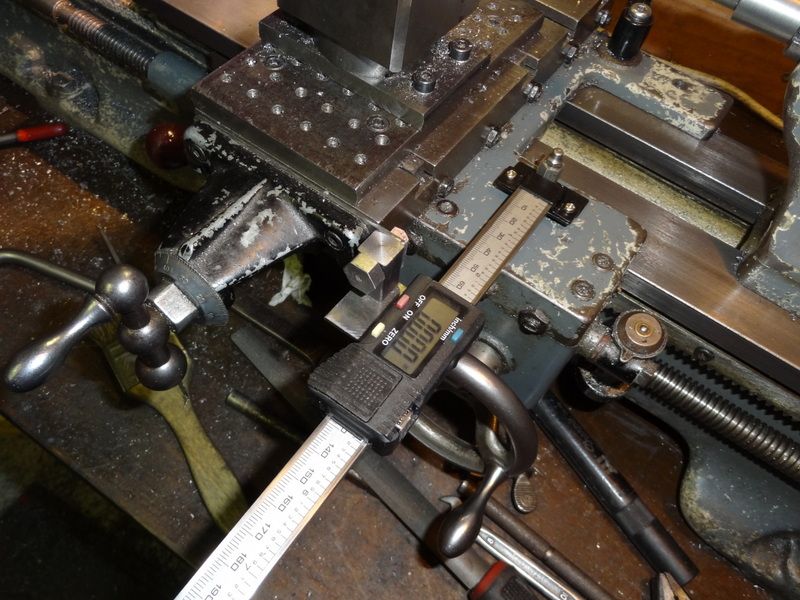

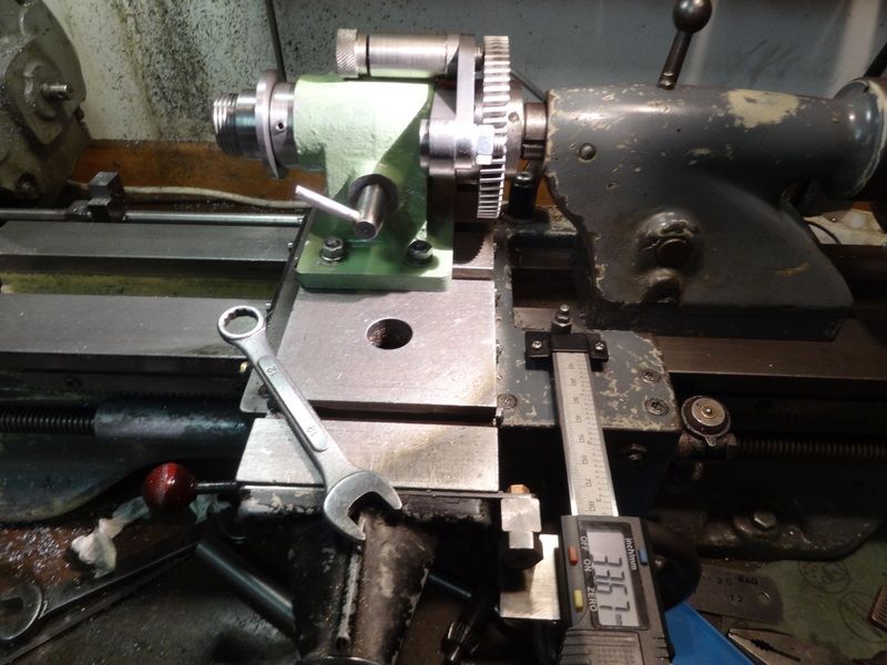

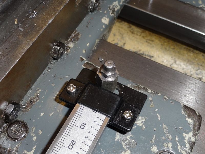

                Actually the day before yesterday. Fitted a detachable DRO for use with my dividing Head.

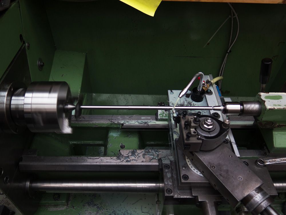

                                            I have never actually done any turning between centers. So I thought I would have a trial dabble at doing so.
                                            Nick

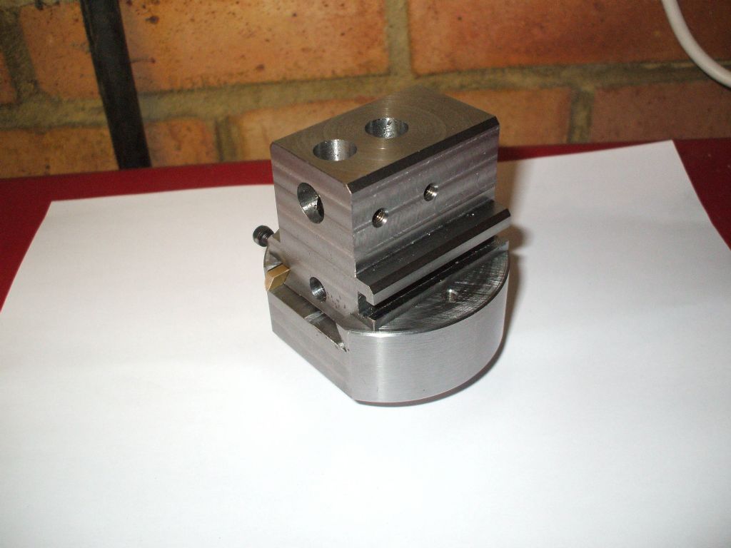

                                              Nearly finished the preliminary machining of the main body and slide for the boring/facing head. Still got a way to go, but I just had to check that they went together OK.
                                              Main body and slide assembled
                                              A couple more photos in the album, if you're interested.

                                                Nick, you may find it necessary to use a travelling steady with slender rods between centes, even with light cuts.
                                                Emgee

                                                    I do so like the idea of a gib strip on the head.
                                                    Far, far better than most designs that just bends part of the head over. My cheaper commercial heads have this bent slot / strip method but the more expensive ones do have a gib strip and the difference in use is noticable.
                                                    Full marks for the improvement.
