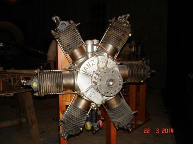

      Anzani 6 cylinder aero engineAndy, would the spring be better vertical, down behind the chain wheels, that would give better tension to the jockey wheel.
      Ian S C
      This is the real thing at the vintage aircraft museum at Omaka at the northern end of the South Island of NZ. This is a 2 row radial engine.

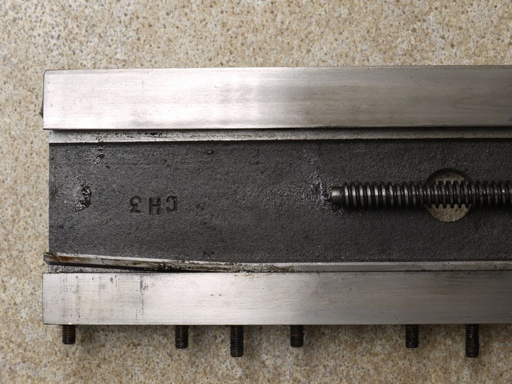

            Decided to have a go at the horrific Gib Strip from the Cross Slide on my ML7R
            Readers may remember that it looked like this:
            … due to the rather unfortunate adjusting-technique employed by the previous owner.
            I am pleased to report success.
            With the strip supported like a bridge, spanning two timbers; a nylon-faced hammer did the trick.
            Cleaned up the wear on the bearing surface with a diamond hone, and it's good-as-new [maybe better].

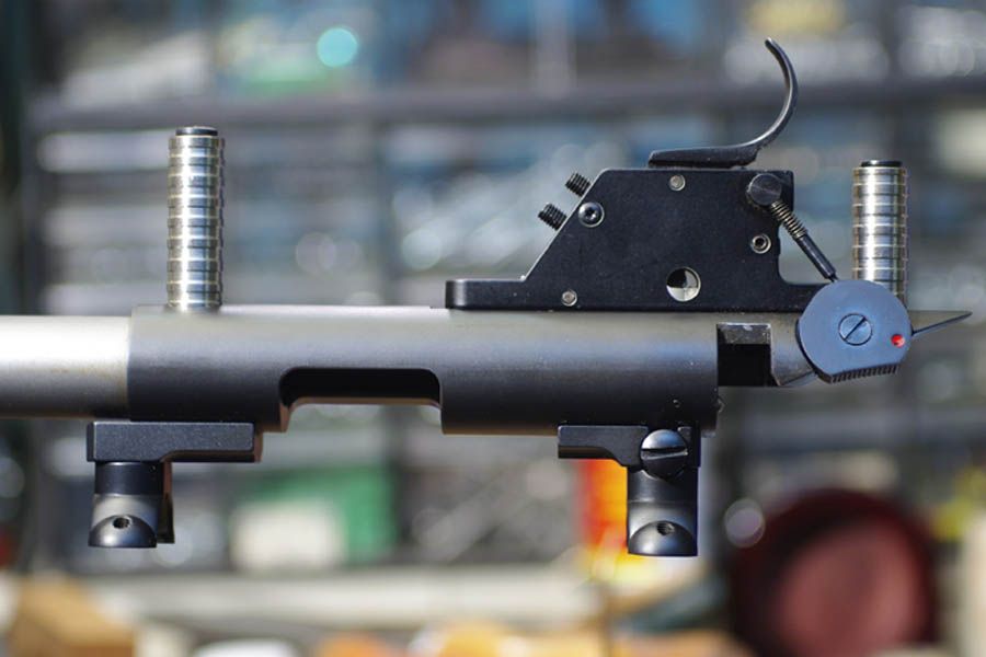

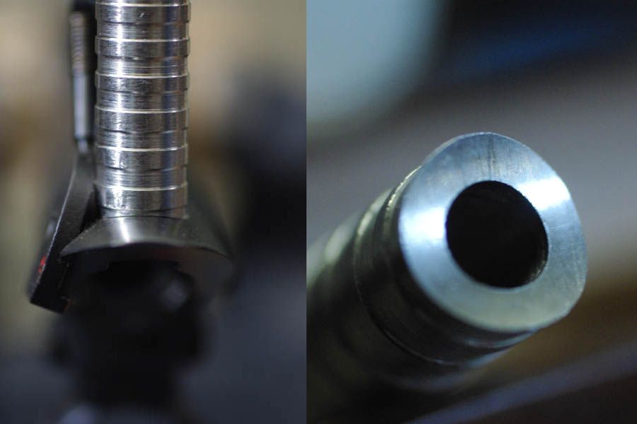

              Getting ready to bed the Kimber 22 LR. Made a set of pillars using 1/2" 316 stainless bored to 9/32". Although the previous owner had it aluminum pillar bedded, I was not impressed by the quality of the work. A bit of work to machine the pillar profiles for a good fit. The receiver is 1.155" in diameter. Ended up using a small fly cutter which was a bit of a nuisance to set to center and to the proper radius. pillars were set up and centered on the lathe vertical slide. When the job was done (as usual) it struck me that I should have turned a ring gauge on the lathe with an inside diameter equal to the receiver diameter. Adjusting the fly cutter would have been quicker and easier… next time I will try to remember that. This job will be followed by epoxy bedding. The local supplier of my epoxy supplies went belly up so I need to do a 2-hour road trip tomorrow to replenish my kits.

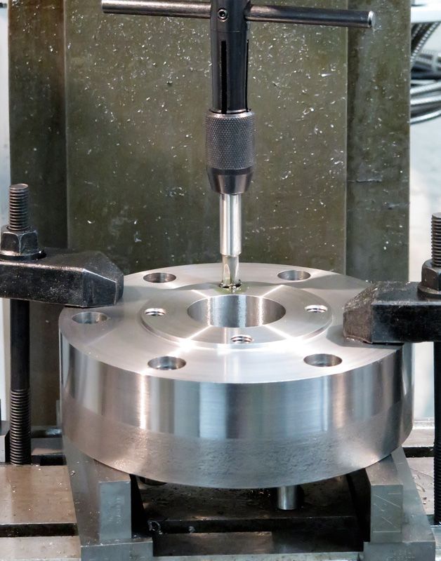

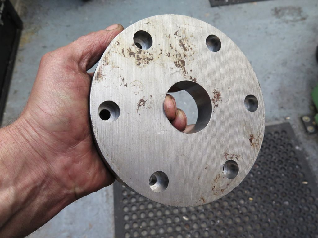

                I had an issue that has been bugging me for sometime. – One I must admit to being purely my own fault. blush
                One of the first things I bought for the lathe not quite 12 months ago was a 4 jaw Bison chuck. I was at the Harrogate show with coins in my pocket and quickly snaffled the new chuck from one vendor and a cheap D1-3 backplate to mount it on from another. …………………… It was not until I got home that I realised the PCD of the D1-3 studs was near as damit the same as the 4 Jaws mounting ones. sad
                This meant that one of the 4 chuck bolts was always going to be a hit onto the top of one of the three in the backplate. Oh dear.!
                Now being full of gusto and not wanting to loose the nice new Bison chuck I had purchased I pondered and considered that as I would only be making lightish cuts that mounting the chuck with just three bolts 'maybe' would be OK. And to a point it may have been. …………. That is had I not made a cobblers of the size of the register in the backplate. (undersize)
                It was usable. But it always bugged me. – I had the idea that using an extra adaptor plate between the backplate and the chuck would solve the issue. But adding weight the the chuck unit, which I am not sure of the pro's and con's of.? (advice please)
                The other day at a friend of mines workshop he donated a piece of steel that had been cut out of something else that would be suitable.
                I am not sure (and he cannot remember) what grade of steel it is. But it beautiful to machine. smiley It is magnetic so it ain't stainless. and the swarf when taking a reasonable cut turns a pale brassy tone. But I would like to know what it is though.?
                Anyway. This is what I did. :-

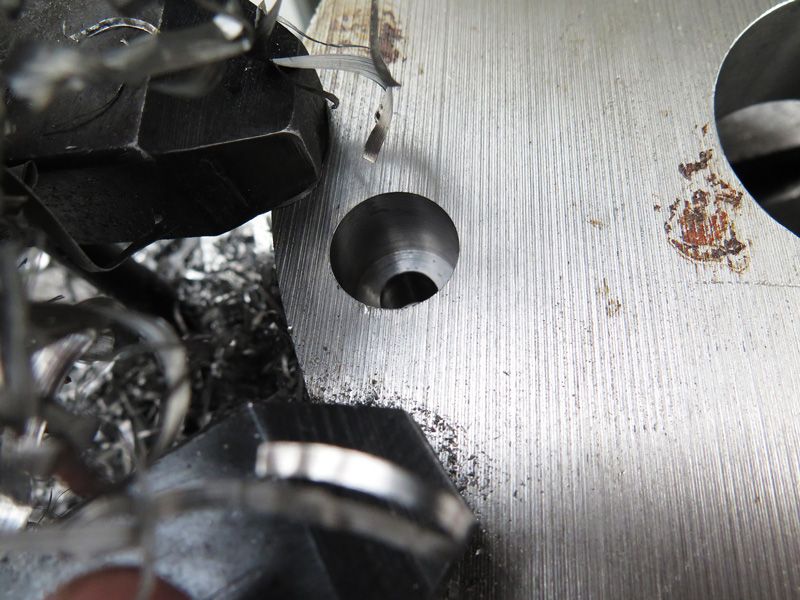

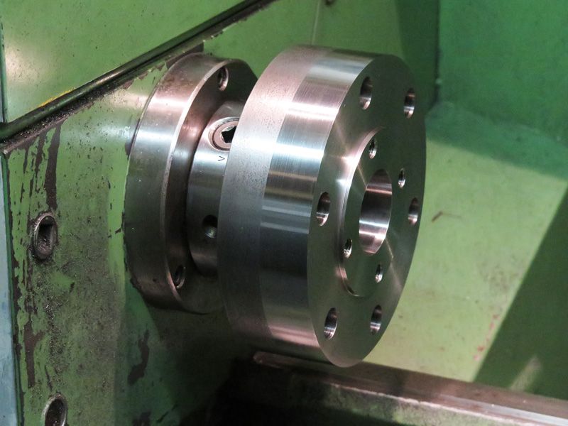

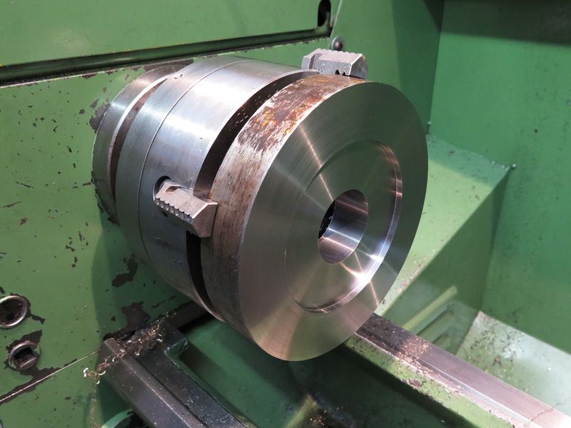

                The only chuck I had large enough to hold it was the guilty 4 jaw. I faced it off and machined the female rebate into it that would key onto the new one I would cut on the cast backplate. Drilled the center out and bored it to the same size as the chuck bore.

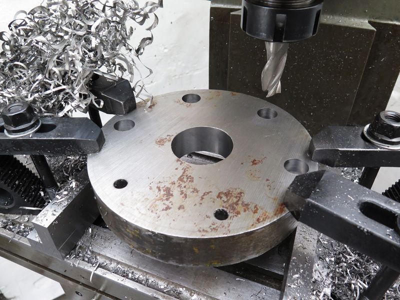

                Some PCD holes to give clearance for the M8 mounting bolts, followed by an end mill to countersink them.

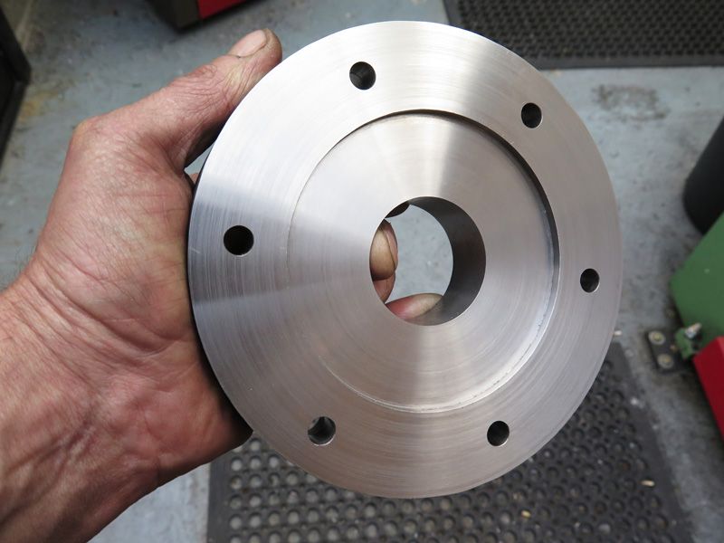

                I then cut the male register on the cast iron backplate. (the correct size this time wink . ) This was followed by corresponding tapped holes to match the adaptor plate. The plates were then mounted together. The other side then faced and a register to match that of the chuck.
                Some more PCD holes for the four M10 chuck mounting bolts.
                And here it is ready to have the chuck mounted. smiley But this time with 4 bolts and the correct size register.! cheeky
                Nick
                  Clarification required as I never make misteaks.. Ring gauge diameter needs to be machined internally to reflect the radius of the required cut PLUS half the radius of the fly cutter body. Maybe even a milled slot to provide access to the locking screws while making the adjustment.

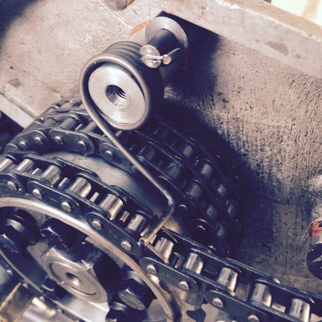

                    Hey Ian, mine's the real thing as well😉!! Just happens to be a 4 cylinder water cold car engine.
                    You are right about the spring angle but I ran out of time and patience.

                      Andy, thought you might be building one of the scale aero engines, I think there are 3 different ones, 3 cylinder W, 3 cylinder radial, and the 6 cylinder radial.

                        Nick g, nice job on the backplate !. Ill bookmark the page for future reference. Not wishing to be pedantic though , but some stainless steels are magnetic.

                                        Ian, the 3 cylinder W is on my project list meanwhile all my machining time is devoted to getting my full sized job going properly.
                                        Tidying my bench revealed the spring that I intended to use in the first place. Today's efforts were therefor doing the job properly. The spring came off a modern tensioner that I hah hoped to use but it wouldn't fit into the space available. This is what the sensible spring looks like rather than the previous Mickey Mouse effort.

                                              Andy, that spring looks like a good solution for the chain tensioner. The fan or W Anzani would make a nice model. When I was doing my apprenticeship as a aero engine mechanic, there was a Anzani (W type) in the corner of the workshop, along with the remains of a Flying Flea(pre WW2 French home built aircraft), didn't take so many photos in those days, pay was small, and film was costly, so no pics of that one.
                                              Is your current motor from a car? If so what?
