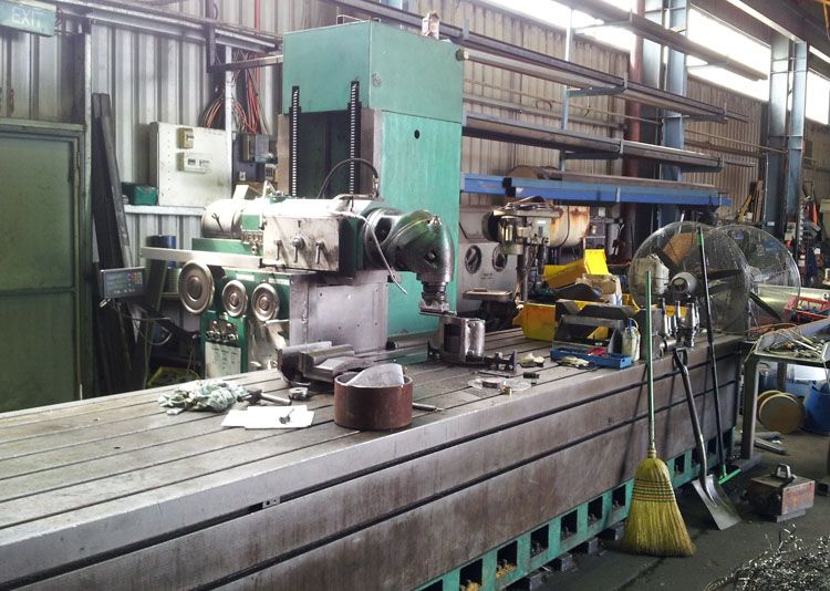

      Hi Murray,
      The engine is a 6" scale (half size) of a 3 1/2hp Ruston and Proctor traction engine which is only a small engine to start with. Originally designed for one man operation. Drawings and castings were supplied by Live Steam Models but I have re-designed it to suit the Australian code and for available material sizes.
      The boiler barrel was originally 10" ID and our code requires a minimum wall thickness of 6mm. I chose to use seamless pressure pipe which has an OD of 273mm and a wall thickness of 9.27mm. Therefore everything is a bit bigger than shown on the supplied drawings. Aust. code for firebox plates are 10mm. Tubeplates are 16mm (minimum 12mm). Don't worry about my toes. Always wear steel cap boots around the workshop.
      Will have to use a bigger mill to skim the side stays. Fortunately I know someone. The one below should be big enough. (Shown machining the steam chest)
      Paul.

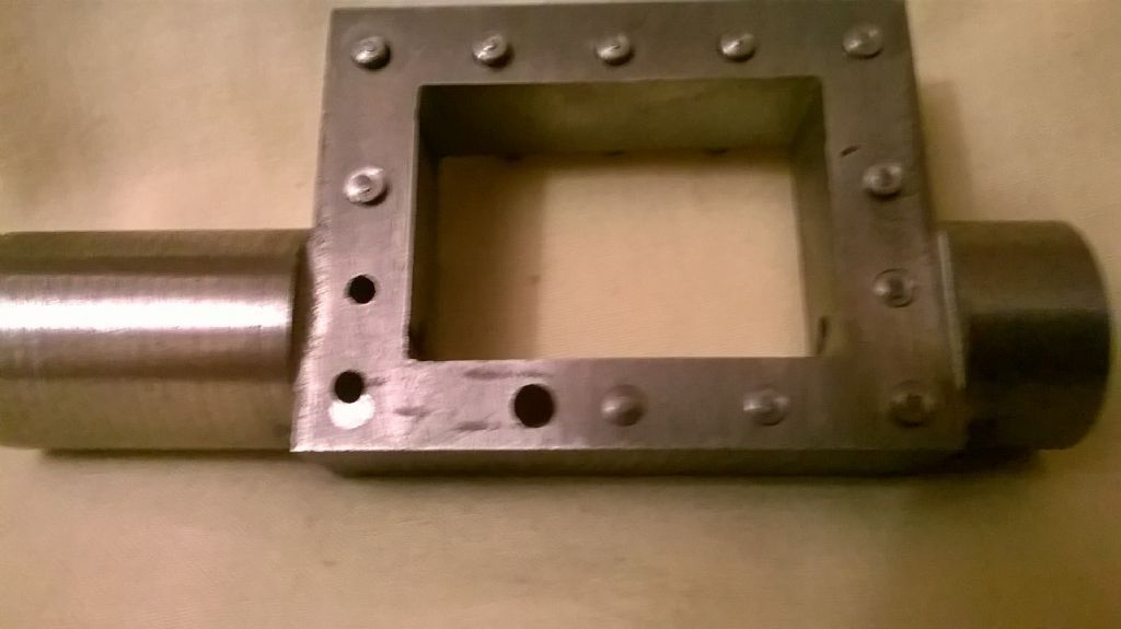

          What I did to-day is try to fix the Fups of yesterday, this is what I do most days !!
          The holes are all in the wrong place. No need for the pic if they weren't.
          Fixed the bottom left , used steel knitting needles form the charity shop they were on their way to the "bin"
          Sure takes longer to fix than it did to "make"
          A problem shared is a problem etc. Feel better now

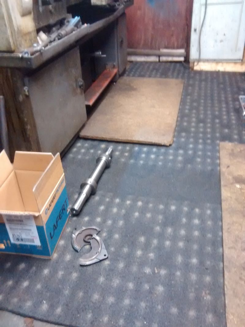

            Well Tuesday to be honest.
            I have rubber matting down on the floor in the small shop, 3mm thick stuff with the penny round embossed pattern on it.
            Been down now close to 3 years and this is a working shop so get a fair bit of use.
            What with the traffic on it it has now started to stretch, bubble up and split and I can see it as an accident waiting to happen if I get a boot toe stuck in one of the bubbled up splits and go base over apex.
            Looking at alternative that hopefully might have a better life and came across these horse mats.
            Bought off Ebay they are left overs from horse shows in places like the NEC. First off the print the floor with a machine that drops tiny dobs of sand down to stop the mat sticking to the floor, then they cover it with bark and that's it.
            After the shows, bark and sand are dumped and the mats sold off, probably to expensive to store.
            They are 8' x 4' x about 10mm thick made from crumb rubber. I was a bit worried about how the hot chips affect it as sometime turnings come of the TOS literally glowing red.
            Well after a couple of days have to report all is well, heavy and light chips brush up OK from the surface, so far no embedded chips. The sand marks are slowly disappearing and if it bothers you they can be hosed off or the other side used.
            They are springy underfoot and could be used as is, I still prefer the boards in front of the machines as it's what I'm used to and even though they are only 1" high, without them I feel like I'm stood in a pit.
            Anyway usual no connection with the seller, just pleased with the product.

              John,
              Is it this stuff? **LINK**

                  Bob, Yes same stuff.
                  I actually bought this.
                  **LINK**
                  And sorry told you wrong they are 10' x 4' but the ones you linked to are roughly the same, your link is 6' x 4' but two off for £2.00 extra.
                  TBH I didn't see these but the 10' ones mean less joins, all depends on the size and shape of the shop.

                                    What's it like for wheeling tool boxes on castors?

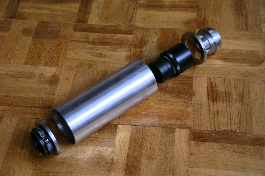

                                      Finally finished an eyepiece projection adaptor for my telescope (the bright parts here):
                                      The dark parts are from the existing telescope focuser. It all screws together using 0.75mm pitch threads and the smaller diameter threads are M42 x 0.75 — i.e. T-mount thread, which is the thread used throughout the telescope focuser.

                                          To Andy who asked what it's like for wheeling toolboxes on I can't say as all mine are fixed and anything with wheels on that will fit in is on largish rubber pneumatics.

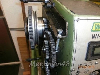

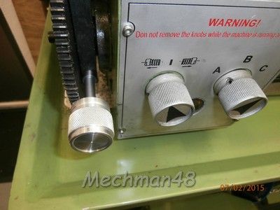

                                            Finished off my lathe mod; gear train disengagement lever, from an idea out of Journeyman's workshop from Maurice Duckworth, simply to quieten the gear train down if you're not needing leadscrew feed, works a treat.
                                            Quadrant pinch bolt..
                                            Stop bolt on top of quadrant…
                                            The bolt fits into a slot in the angle iron carefully filed to give enough clearance when disengaged & proper backlash clearance when engaged.
                                            Have got a small video to show the effect on noise it has when operated, but, as usual with Photobucket it's still loading up & then I might get lucky & be able to put link in…. have got it in my Dropbox but can't see any way to link from there as I don't see any URL copy facility as P/bucket has. Does anyone have the method of linking videos from Dropbox to here..?
                                            George.

                                                  George try uploading the video to youtube as its quicker to play than ones hosted on PB.
                                                  I don't find the noise a problem when they are all set up just right but if one of the washers between banjo and gear is wrong or the mesh a bit off they can sing a bit.

                                                    "from an idea out of Journeyman's workshop from Maurice Duckworth"
                                                    Interesting mod George – do you have a link?
