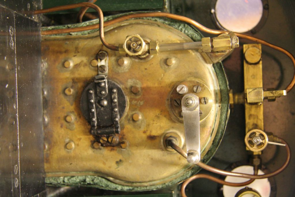

                                          5G inch gauge Tich
                                          #138237
                                          julian atkins
                                            @julianatkins58923
                                            hi dave,
                                            there is a simple method of proving the water gauge reading from your pic (which is very useful). if the regulator gland isnt tight (if so slacken it off) see when the water gauge reading gets to the regulator level. a slow drip of water should disappear and turn to steam (perhaps easily seen on a cold day than a hot summer's day!). similar to the GWR try cock arrangement..
                                            my initial thought from your pic confirmed my view that the water gauge reading is perfectly ok as the bottom fitting is quite high. check via the inside of the firebox with a rule allowing for the thickness of the inner firebox wrapper – the water gauge reading should be 1/4" dia above same when the water level is at the firebox crown ( the water gauge usually showing a reading 1/4" above the actual water level when in steam).
                                            i do like the manifold/turret and steam valves – you have done a very tidy job which looks very good!
                                            cheers,
                                            julian

                                                You may have seen my photo of the backhead, which was posted with this latest ‘saga‘. The photo worked, but the ‘saga’ didn’t. I think that there is too much verbiage. Stupidly, I hadn’t saved it, so I have typed up this new account, in Word first, saved it, and will hope to copy it into another post. It will have to be in smaller chunks.
                                                #138295
