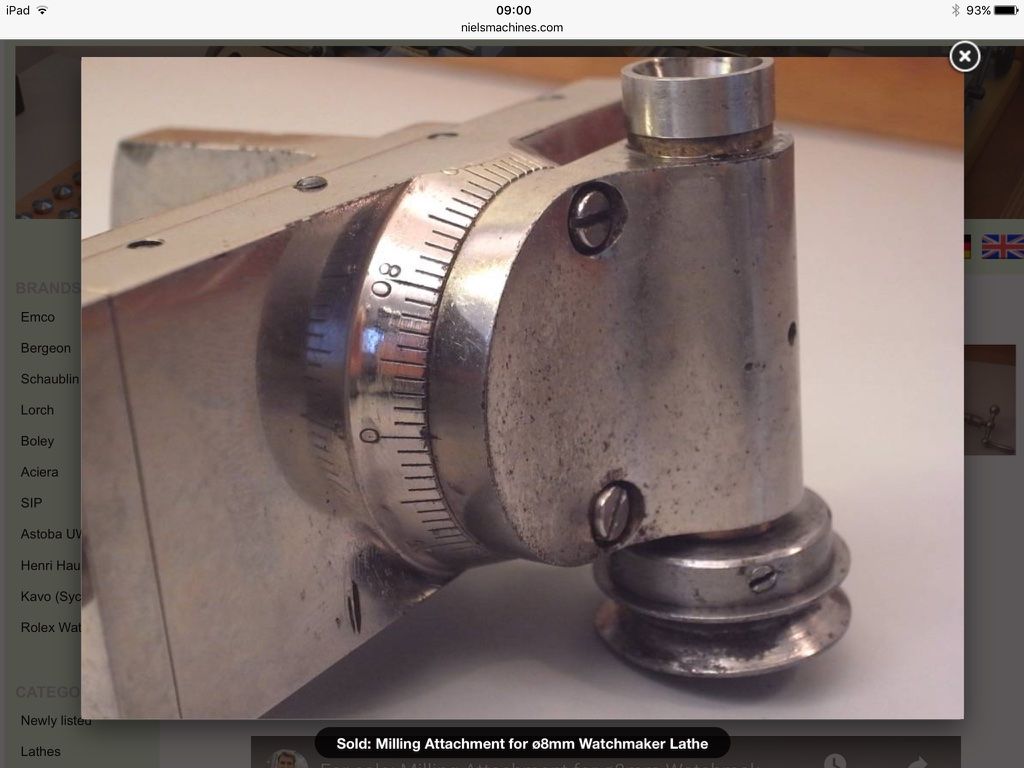

                #399215
                  Rod,
                  The item on Neil's Machines appears to have its fiducial mark positioned appropriately for the most common use-cases:

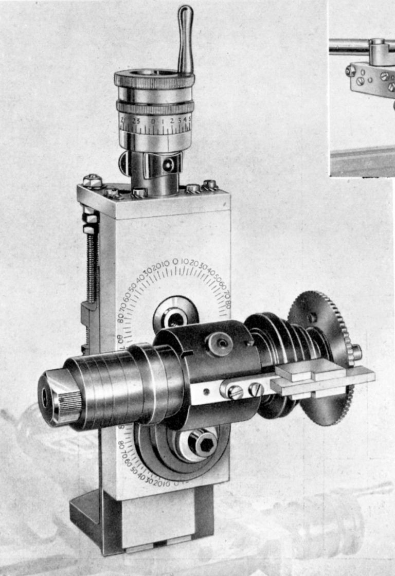

                                  [ for what it's worth … in my personal opinion ]
                                  The Lorch markings are a model of clarity, compared with the Pultra equivalent:
                                  Edited By Michael Gilligan on 09/03/2019 17:28:49
                                  #399426
                                    Can't argue with that. Numbering every 4th or 6th division would have been better but at least they are working with 360 in a full rotation

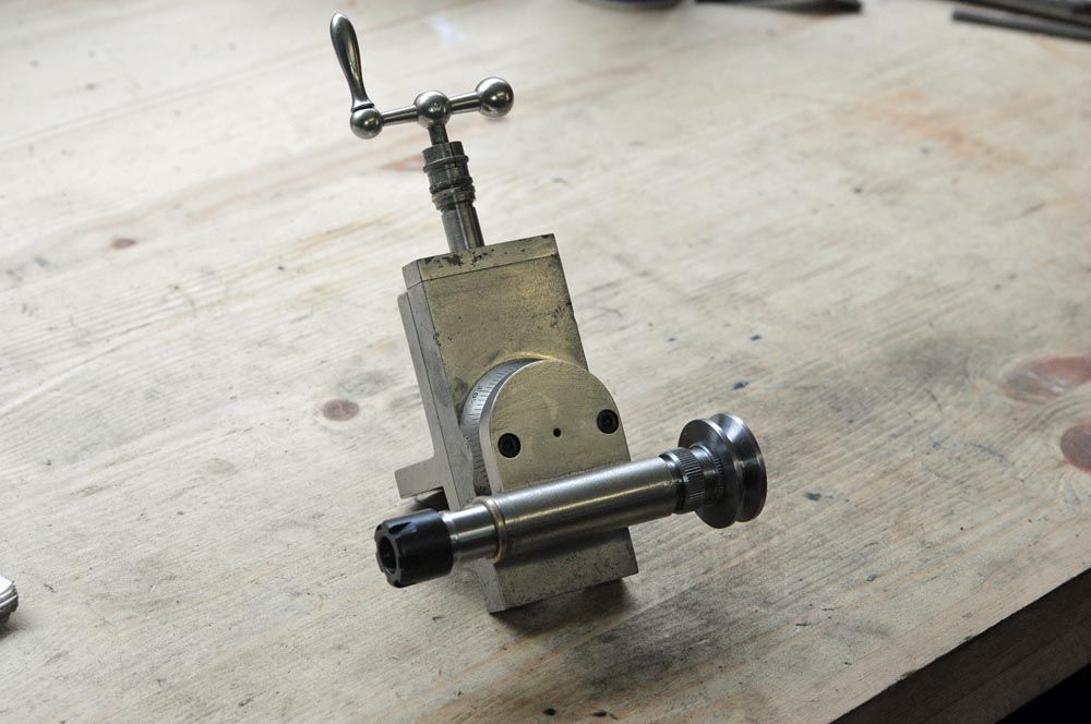

                                                  Roderick Jenkins
                                                    @roderickjenkins93242
                                                    My obsession with milling spindles continues: I've made one for the Lorch slide –
                                                    Cheers,
                                                    Rod
                                                    #401617
                                                      That looks very tidy, Rod
