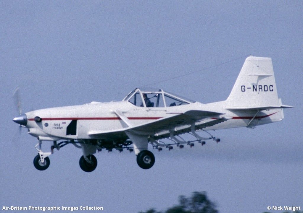

                                Robert Atkinson 2
                                  @robertatkinson2
                                  As Bill says, it can help fatigue life by removing transverse scratches from the edge of sheet or plate material.
                                  I was taught this by Desmond Norman when helping make the curved spray bar supports you can see under the the wing in this picture:
                                  https://s3.eu-west-2.amazonaws.com/abpic-media-eu-production/pictures/full_size_0243/1365100-large.jpg
                                  I'm avionics based but A. my traning included "fitting" and basic machining and B. We were in a rush to get the aircraft out for a customer demonstration. It was "all hands to the pumps" so I started filing as did Desmond. While the factory was "sheet metal in, aircraft out", we had no CNC machines etc. The supports were band sawed roughly to shape and then filed.
                                  When doing filing exercises during training we were not allowed to draw file because it was to easy to get a nice finish. And yes those are the actual items in the 35 year old photo, we only ever made one set.
