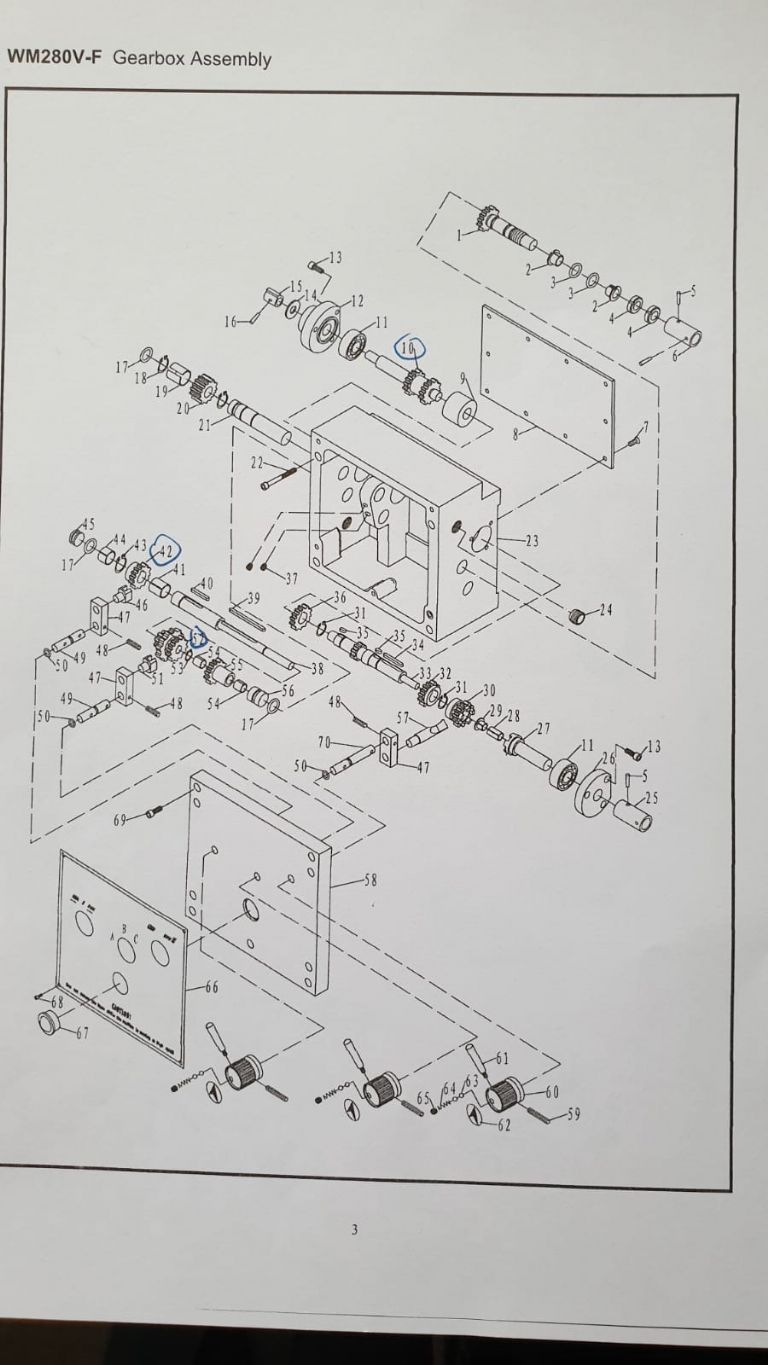

                      Update. Many thanks for the input on the problem. Warco can and do supply spares for the gearbox so I have ordered two which are in stock and a third is on order but with a long delivery time! I will now remove the assembly and review the situation. May well try to modify the third gear with one from HPC as per Dave's suggestion if the wait is too long.
                      I've experienced stiffness with the gear change selectors since original delivery (it went back to Warco quite soon after it was installed for this very problem) but after a time you tend to live with difficulties.
                      Poor meshing would appear to be the primary cause. This has led to excess gear wear, resulting in the three broken teeth discovered in the base of the casing. Will update the Forum as things develop. smiley

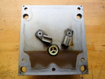

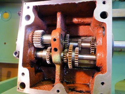

                          The gearbox is fairly rudimentary, if the gears aren't meshing correctly as far as I can tell the only adjustment is by altering the position of the gear-change knobs on their shafts. The location of the gear-change arm and the U-shaped fork is as far as I can tell simply held in place by the ball bearing detent on the underside of the knob.
                          Inside the gearbox, left is the reverse and right the 3 speed ranges
                          Inside of the lid with actuator and U-shaped forks that sit around the gear.
                          Problem is you cant see anything to check the alignment once you put the lid back on! The pictures are of theWM250 but the 280 is probably pretty similar.

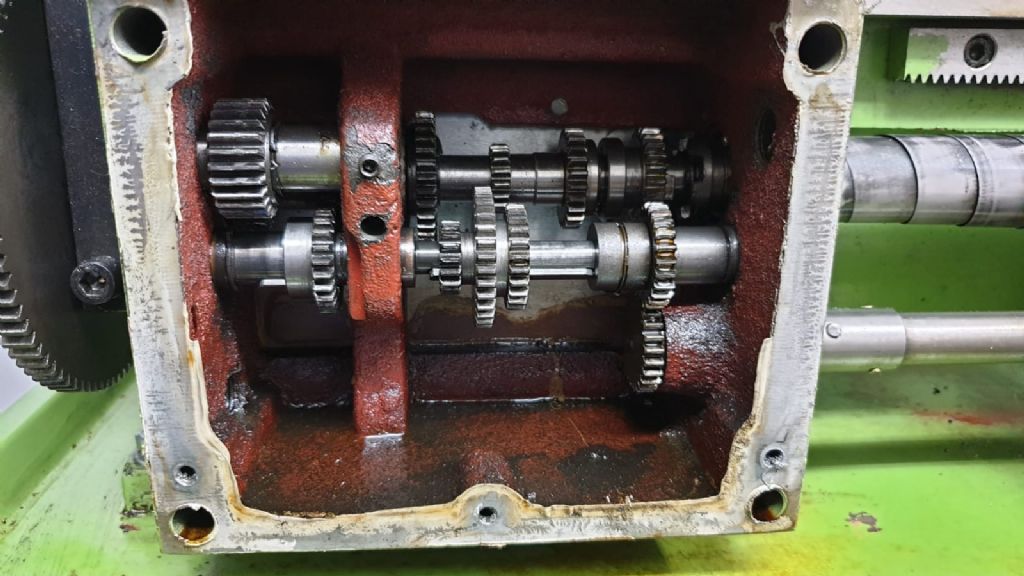

                              Few more gears in the 280box, this is a similar PM1127
                              Looks like the grub screws in the dividing web may need to be loosened so that the shafts can be slid out to replace the gears.
                              #457331
                              Journeyman
                                @journeyman
                                Yes, a bit wider with the 3 extra gears on the right to select either the lead screw or feed shaft and of course an extra knob and selector arm.

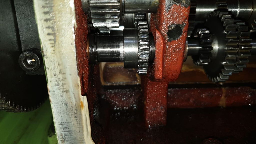

                                              If this works these are Barrys pictures. he sent them to me when he first took the cover off.
                                              Hoping this works
                                              Steve
                                              #457388
                                                Interesting that the damage seems to be on one half of the gear as first photo looks reasonably OK but second is a mess. Or did it come to a grinding halt when a tooth broke off and got in the works?
                                                #457390
                                                  Is there a Circlip missing from the groove?
                                                  #457392
                                                  S.D.L.
                                                    @s-d-l
                                                    Posted by JasonB on 15/03/2020 15:52:13:
                                                    Looks a good call from the Manual picture below.
                                                    I know that Barrys lath went back to Warco when it was new as the selectors were stiff.
                                                    Wonder if it was broken circlip in it?
                                                    Steve
                                                    #457394
                                                    Dave Halford
                                                      @davehalford22513
                                                      Circlip shows in the other photo.
                                                      Does the mangled upper gear mesh properly with the big idler using the undamaged section on each gear?
                                                      Is there a small amount of backlash?
                                                      Is the other gear we can't see the same?
                                                      If there is then it's likely theres been a Chineseium failure or you really should let the machine stop before changing direction.
