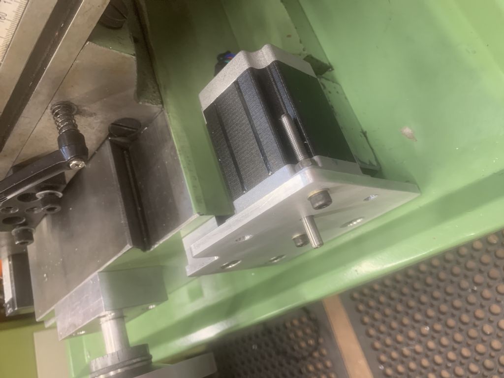

                                    PS, i found my old thread when i did the Z axis conversion and Joseph Noci 1 did suggest i may need a Nema 34
                                    This is my Y axis project, i am using an old stepper for sizing etc
                                    Edited By petro1head on 05/04/2023 11:44:18
