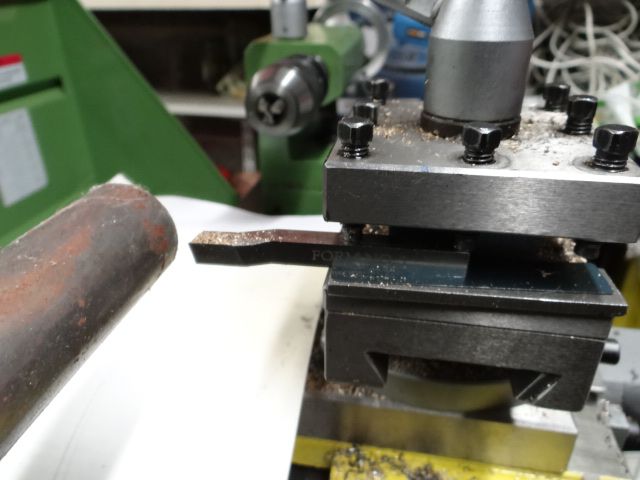

      I have a Warco WM 250 lathe, its mounted on a very robust frame of heavy box section steel Tubing, that came with the lathe. also this is the model with only one drive belt.
      Problem one. After buying this lathe S/H, I was quite disappointed with its Performance in regard of depth of cut and surface finish. It had been fitted with a quick change tool post, This was the cause of some problems. As the original TP had been cut cut off low down and drilled and tapped with a stud (I assume to accommodate the higher tool holder. The problem was that the new stud mounting was not only drilled off centre but in material that couldn't accommodate the size required it was only a few thou bigger that the thread on one side.You could move the tool post by hand. To rectify this I have removed the compound slide assembly (for later repair) and replaced with 2 one inch blocks of steel mounted in theT slots of the cross slide, the tool post now consists of a 9/16 UNF bolt and is quite solid or so I thought. Last night I was removing some weight from a rotating drum assembly and not only could only take cuts of a thou or so it would also dig in suddenly and stall the lathe. Has anyone any thoughts on what could cause this?
      I have plans to fit new headstock bearings sometime.
      Problem two, Due to the cutting tool digging into the material a few times it has probably over heated the motor because at one point the spindle stopped and I could not turn it at all by hand, I stripped out the gear cover and removed the belt.by this time had cooled down a bit and the spindle turned freely by hand.Tried the motor with belt off and that runs fine, Not sure about under load though.
      Later on I am going to remove the motor and check the brushes etc. Advice welcome.
      Thanks in advance,Sam

                  Welcome to the forum Sam.
                  Pictures help with this sort of problem, and how to post them on this forum is described here <link>.
                  My first reaction is the two problems are connected:
                  • Motor overheats because the tool digs in, Noting that the previous owner probably had repeated dig-ins, and may have kept going regardless.
                  • Assuming a sharp cutter is correctly set at centre height with minimum overhang, digging-in is usually caused by the tool-post flexing. I'm not clear how your temporary steel block and big bolt are arranged but I suspect it's not stiff enough either. A photo of the arrangement would help even if the lathe is bits. The force exerted on a tool-post by a properly positioned sharp cutter is surprisingly high, and much higher if the tool is below centre, blunt, well away from the tool-post and is hacking into a nasty lump of scrap such as work-hardening stainless steel.
                  Maybe the motor's damaged, but don't rush to change it until the mechanical tests advised by Tony and others have been tried. Be really annoying to fit a costly 3-phase and VFD only to find the real problem is something else…
                  Never mind, every cloud has a silver lining – diagnosing and fixing the problem will be highly educational!

                      1 ) Rigidity of tool [post / Cross Slide
                      2 ) Tool not on centre height (Lack of rigidity could give the same effect
                      3 ) Grossly excessive feed rate
                      4 ) Possible excess top rake on the tool., I do a lot of work with Zero Top Rake. (The parting tool in the rear tool post is one such example. ).
                      If it were me, I would seriously explore ways of reverting to a four way tool post, if possible. This should be more rigid than a QCTP, because of fewer interfaces and reduced overhang.
                      You could make a four way post by laminating suitable pieces of plate (I made a four way indexing rear toolpost for my lathe (Take a look at my albums for a couple of pictures )
                      Like me, you may not be able to locate each position by a spring loaded pawl, I used a long dowel to do the job!

                        As Howard suggests lack of , rigidity .is the key . Can you lift the cross slide vertically. ? Possibly due to poor
                        assembly . On my gh600 the cross slide lock is supposed !!! !to work by tightening up the right hand hex head
                        to clamp on the underside of the bed .
                        If your lathe uses a similar system you could try locking the cross slide before moving the tool in to touch the bar
                        or try taking a facing cut..

                          Sam, it sounds as if your WM250 might be even older that my 2007 version. The lathe still works well although probably quite lightly used compared to some here. The DC motor does indeed run hot despite the fan, being tucked away at the base of the headstock there is little in the way of free air circulation, I considered fitting a computer style cooling fan to help but never got round to it. Where possible I keep my lathe in the low speed range so that it can run with higher motor speeds, this helps both for cooling and for power.
                          A few things I found which help rigidity:
                          • Check the rear saddle gib strip mine was loose on delivery, this stops the rear of the saddle lifting.
                          • Check the guide blocks at the front of the saddle these will probably need fitting by filing, machining or rubbing on abrasive paper. Unfortunately not adjustable so it's a one way trip don't overdo it.
                          • Check the cross-slide gib strip and adjust carefully. Stops side to side play and snatching.
                          • Check the top-slide gib strip. If not in use clamp up with the allen head screw.
                          • Adjust the change gears to ensure they are not too tight, use paper between the teeth.
                          I use a QCTP on mine without any problem but sounds as though yours might be a bit awry. I made a cross-slide toolpost to avoid any chance of play or rigidity problems from the top-slide.

                                        I wonder – was your 'rotating drum assembly' possibly made of brass? Very inclined to grab, brass is, pulling the tool into the work. Just a thought.
                                        To stop this effect, take the sharp edge off the tool with a fine stone – 5 to 10 degrees of negative rake – taking off as little as possible so you can restore the tool for steel. Or, keep a few tools for brass, ready stoned, if you use it regularly.

                                          Easy, just follow this bad advice:
                                          1. Wind the top-slide fully to the left
                                          2. Clamp the cutter in the tool-post at maximum extension:
                                          3. Grip a long job in the chuck, and don't support it at the cutting end
                                          Aficionados can improve on this by fitting a QCTP, loosening the gibs, not locking unused slide-ways, using a blunt cutter, turning a grabby metal like Bronze, and attempting a greater depth of cut than the lathe is fit to take. What a lathe is fit to take varies considerably – might have been lightly built in the first place, have an old-fashioned narrow saddle on a twisty bed, and the bed and spindle bearings might be worn sloppy.
                                          Considerable force is needed to cut metal. As every force has an equal and opposite reaction it's important not to multiply it by creating anything resembling a lever in the set-up. Everything bends, so avoid accidentally crowbarring the lathe as shown in my photos!
