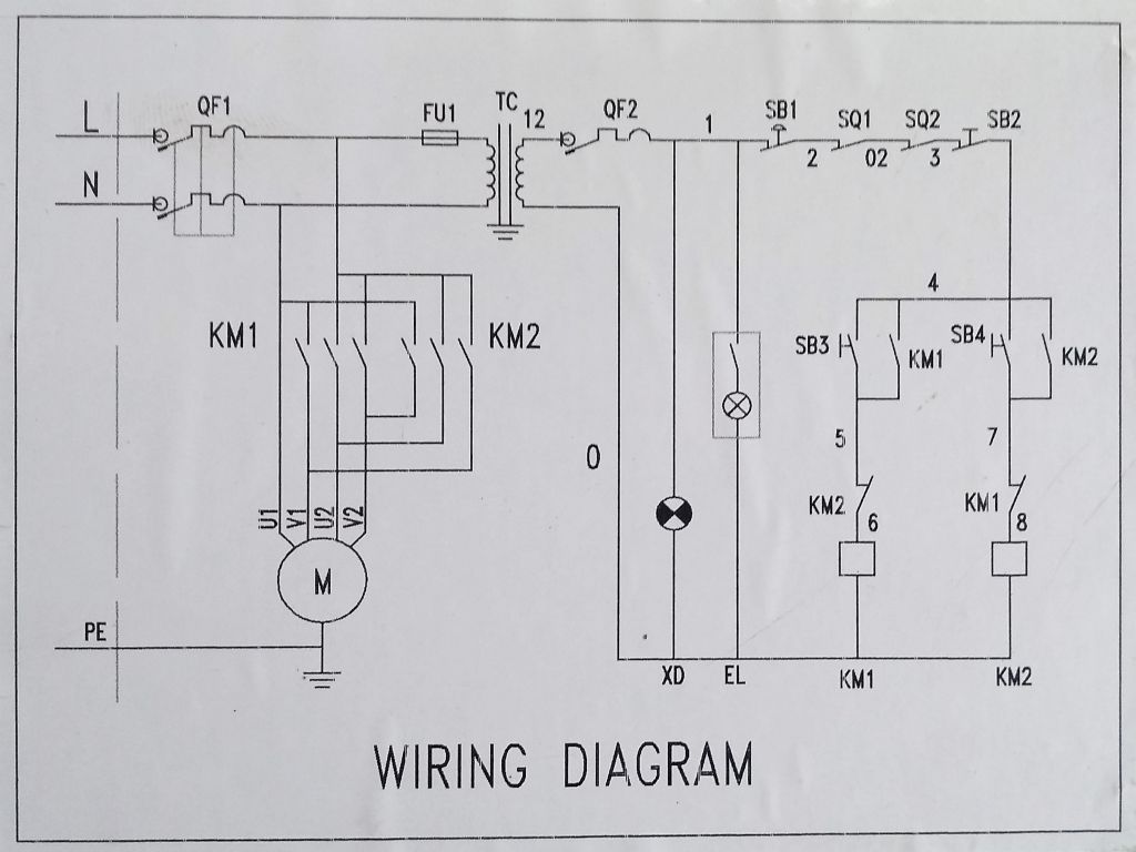

      Hi all, I am new to the forum and enjoying the wealth of information.
      i am looking for some help with the wiring on my Warco VMC mill. I converted the mill to run VFD many years ago, and I did take a picture of the original wiring, however, you guessed it, no longer have the picture!
      As the machine is going to be sold I am converting back to original 240v and will use VFD on my new mill.
      The bulk of the wires have gone back without a problem as they are well numbered. The problem is the safety switches for the lid and chip guard. For the life of me I can’t work out the correct connections.
      If anyone can help with a wiring diagram or a photo I would appreciate it very much.

          Duncan,
          The safety interlocks need to be wired in series, the series chain then connects in series with the Live feed to the NVR switch.
          I dont have a schematic but if you have most of the wiring back as was, it shouldnt be too difficult to figure out…
          The NVR switch needs a Live and Neutral going in ( with the series chained interlocks in the Live feed) then there should be a Live and Neutral coming out, feeding the Run winding of the motor, a Live and Neutral pair feeding the FWD-REV switch, which in turn has the Start winding connected to it. You may also have a Live Neutral feed going to a transformer for a lovo lamp.

            I spotted an Ooops…
            I should have said the series chained interlocks are in series with the feed to the coil of the nvr switch…

                    Glyn Davies
                      @glyndavies49417
                      This is the wiring diagram for my 2018 VMC:
                      #521546
                      John Rudd
                        @johnrudd16576
                        Glyn,
                        That is just what is needed, many thanks…
                        Duncan, if you can identify SQ1&2, we can go from there…I suspect they are belt cover and chip guard interlocks.

                        Duncan Harwell
                          @duncanharwell16936
                          John and Glyn
                          Thank you so much for your help and advice. Now fixed!
                          Richard from Warco managed to find an older part exchange mill with the same wiring as my mill. He kindly took some pictures and the culprit wire 007 had to be connected with cut out switch to 003!!
                          They seem to have changed the wiring on the newer models like yours Glyn.
