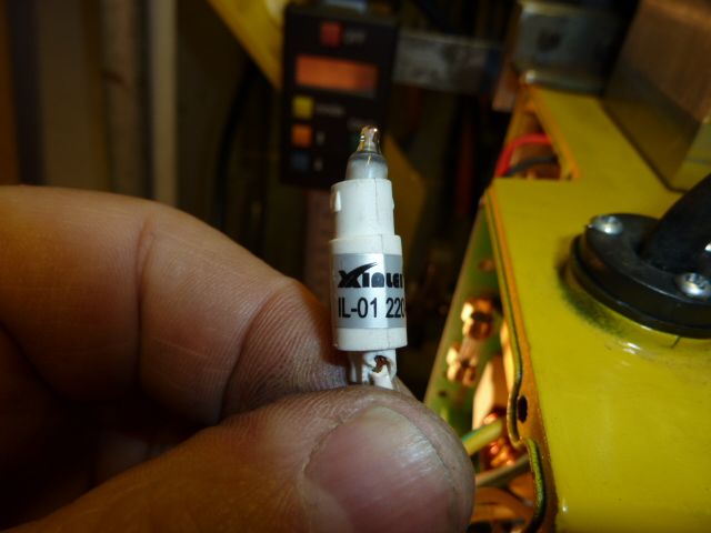

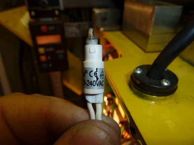

        So thanks to all for there help i am now almost sorted. The one remaining problem is the mains supply light.
        It is blown and must have been what i heard go Phutt.
        Its straight off the 230v supply and has a little resistor in its housing. Who can supply the necessary infor or alternative part info for me????
        Thanks again and sorry it was a false trail but at least it saved me a bundle for now and having to work out how to fit the heavier alternatives.
        Regards Clive
        Edited By Clive Farrar on 20/01/2015 18:47:19
        #176719
        John Rudd
          @johnrudd16576
          It will be a 90v neon with a 270k resistor in series….
          might be easier to go to Maplins and buy a 240v panel lamp….
          #176728
          Clive Farrar
            @clivefarrar90441
            Just been looking at maplins John and at £1.09 I think that might be the job.
            I can cut the old bulb off and fit spade connectors to go straight on the lamp.
            cheers Clive
