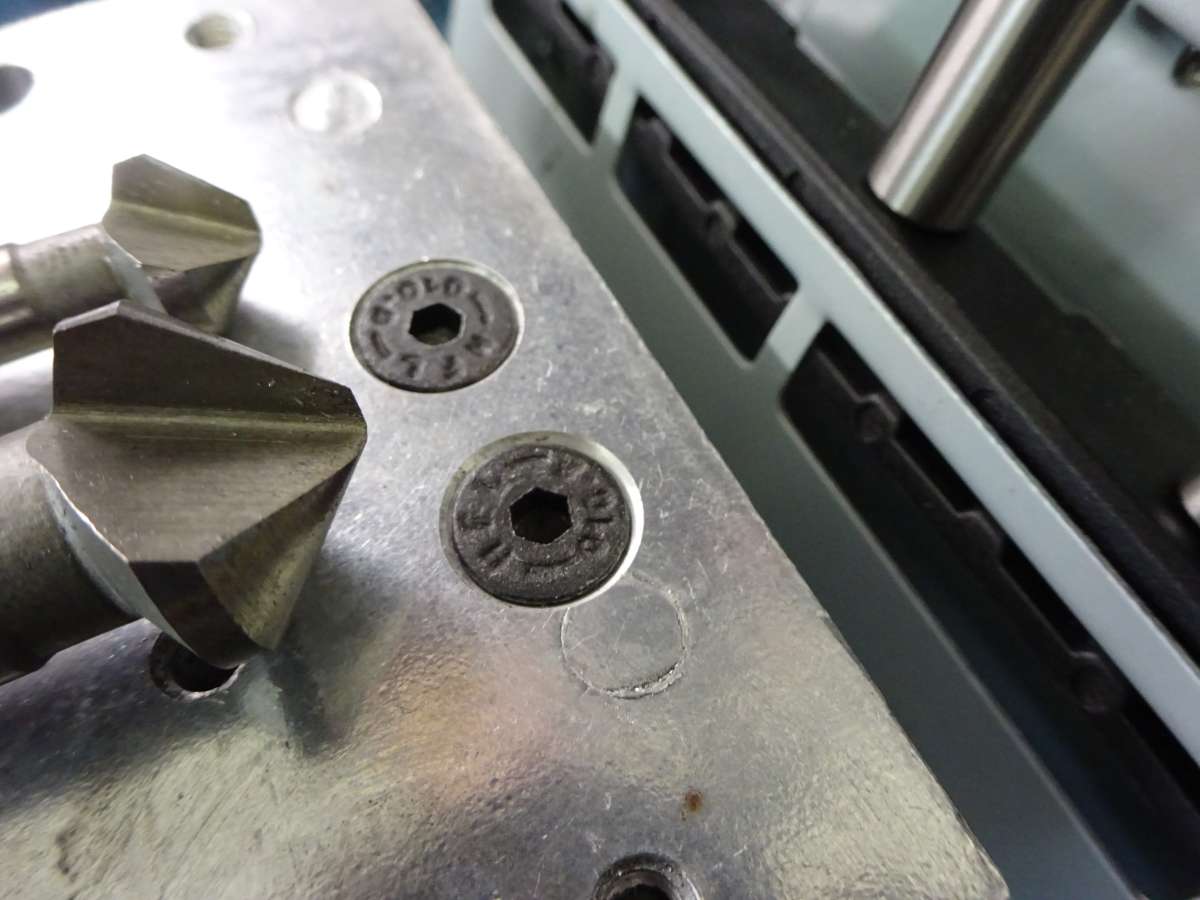

          Can’t comment on the C/F aspect but a few thoughts on countersinking particularly with CNC.
          You have two options. The first is to plunge in as you would with traditional manual machines which quite possibly is not the best bet. Though the advantage of plunging is you get a CSk hole with a slight straight section at the top which better accomodates the screw a sthey don’t come to a sharp edge then it is better not to have the CSK just a sa plain 45deg cut. The off the shelf countersink bits for this have a 6.3mm head and usually come on a 5mm shank.
          The far hole was done with the correct size CSk for the M5 screw, the one nearer just a larger one that was taken deep enough to set the head just below the surface which results in a larger hole at the surface.
          Photo 107
          Second option is to use the Chamfer function of CAM and have a 45deg cutter run around the edge of the hole to a prescribed depth. This allows you to use one cutter for several different diameter holes as well as chamfering any edges. For this I would go with a chamfer mill when working metal but there may be a similar thing specifically for C/F. Provided the cutter is not larger than the standard CSK size you can get the stepped hole so in your case a 6mm cutter would work as it is smaller than 6.3
          No need for depth stops you can set the height in the program though may need a bit of trial until you get the right depth. Then make a note and use it in future

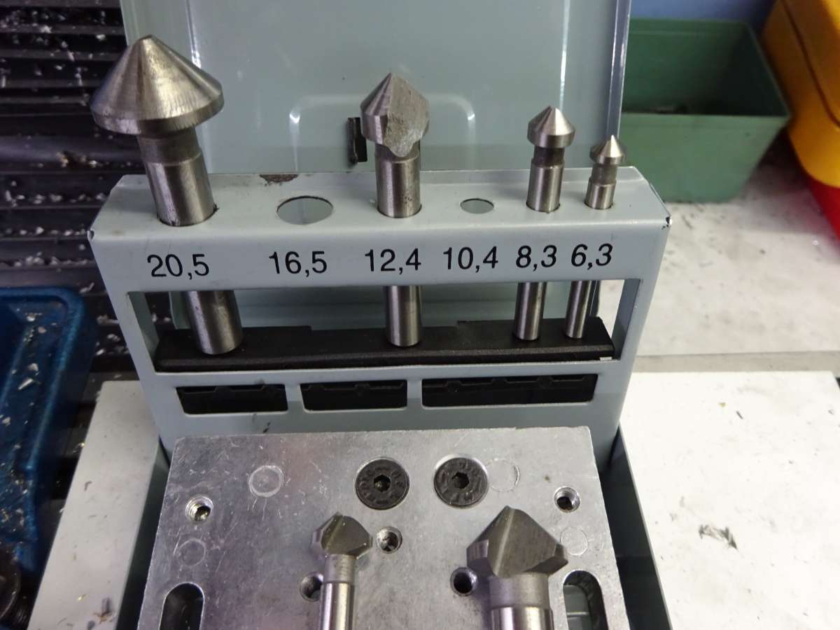

            Regarding sizes, this set have the ISO heads for M3 to M10
            Photo 106

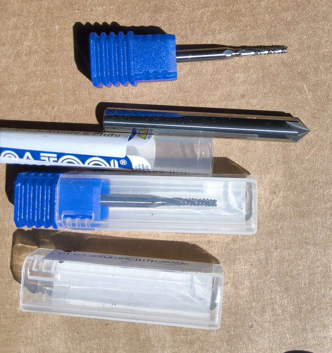

                            Hi Jason,  thank you for the advice and pictures.  The inlet countersunk screw looked a lot better than using a larger countersink bit.
                            I have ordered one of the ‘Drill Mill 6mm Diameter 90° Point 6mm Shank AlTiN Coated Carbide’ and also a carbide countersink.  A little experimenting is in my future 😉

                                  I’ve just had a delivery of a couple of Routfish cutters and the 90 degree cutter.   Time to start experimenting 😃
