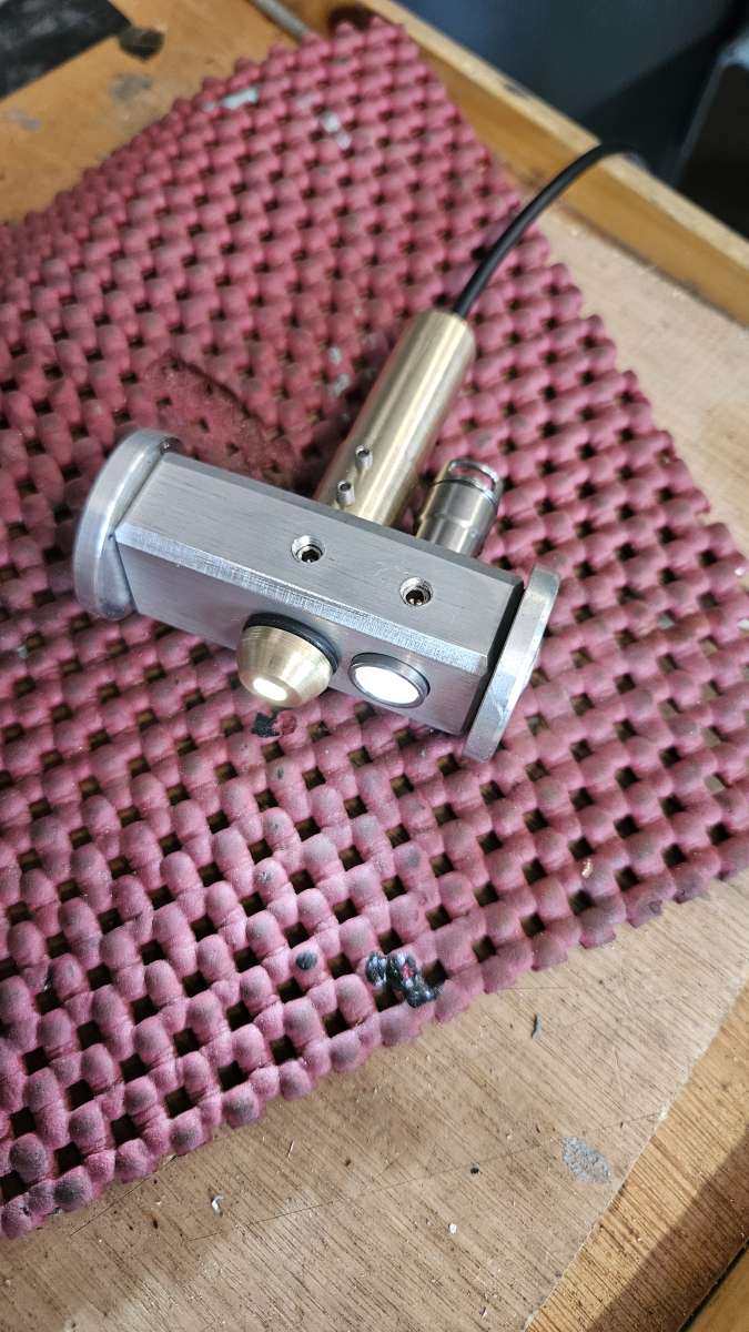

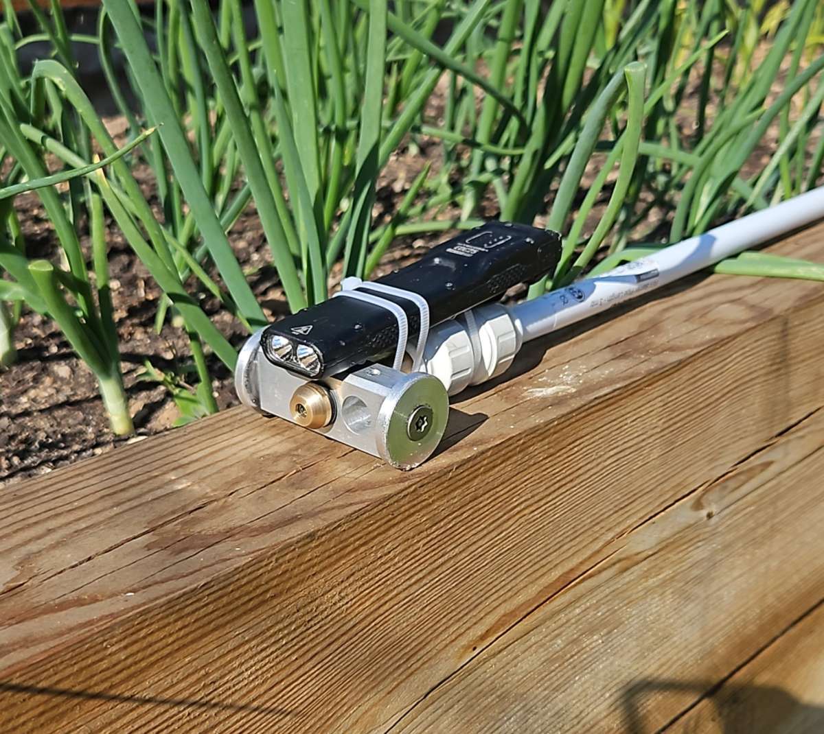

                                    So, I took the easy route of digging down to find the redundant sewer line just above the Y junction where the kitchen drain joins it.  A quick slit with the angle grinder and I checked the full length upstream with the home made drain camera I cobbled together.
                                    I didn’t mention that did I? Cheap endoscope with 3m of cable and USB connection to laptop. I made a little carrier head for the camera with a light source.  A 15mm shank allowed it to fit in a 15mm push fit plumbing joiner and a 2m length of flexible pipe.
                                    This worked brilliantly to see along the pipe and identify there were no faults after the cut out and plenty of movement on the upstream side.
