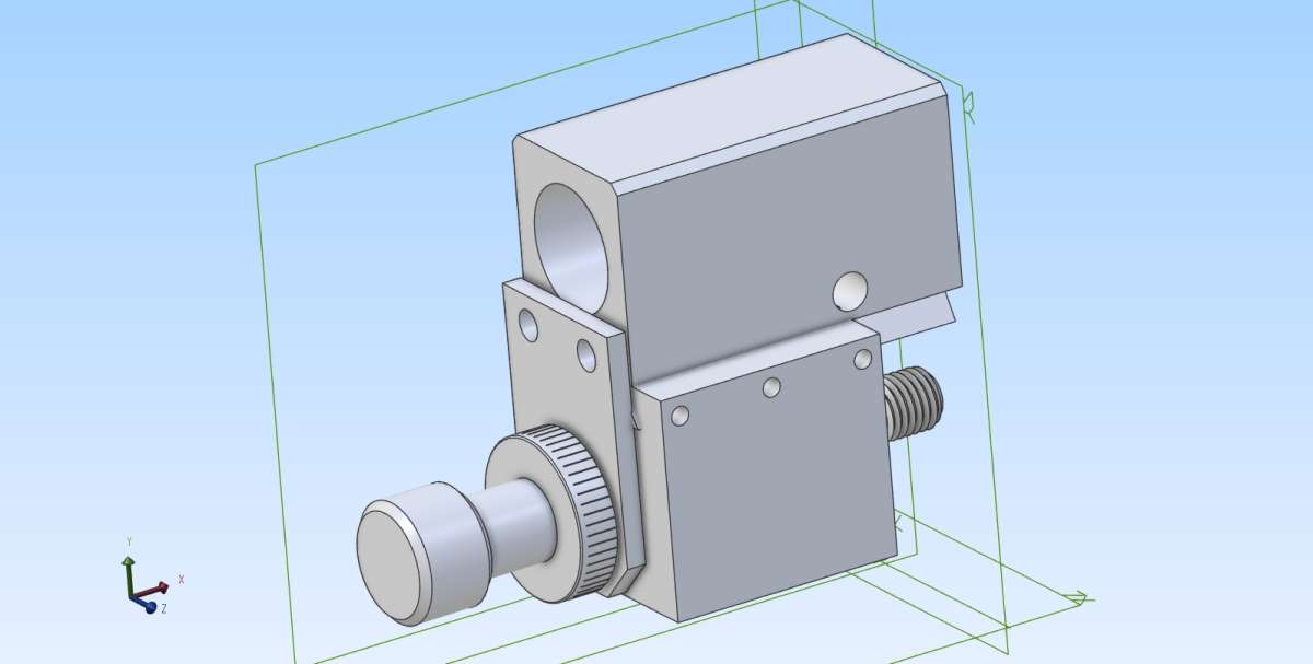

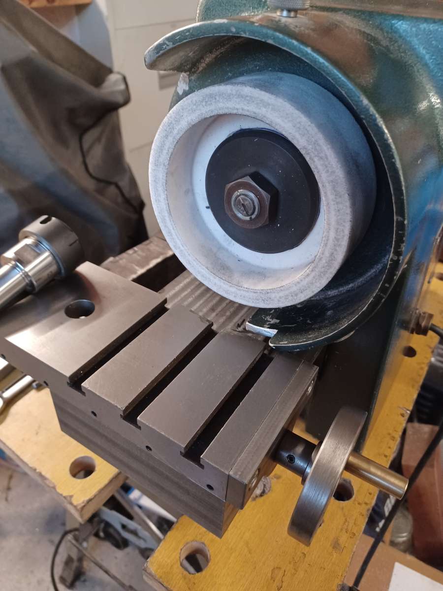

                I have started to modify my Taylor Hobson cutter grinder, which was made to grind cutters for a pantograph engraving machine. I have made a cross slide from a cross slide from a Myford lathe and a chunk of cast iron and other bits and pieces firstly to give me a base to add cutter holders.
                20241219_154519
                I have also started on design for holding the ER collet set and to give it angle and depth movement.
                Tool grinder mod top slide assembly
                This will have in and out slide, rotation on base and rotate up and down on other axis to allow angled cutters and shallow angles on bottom of end mills etc.
                David
                #773740
                Clive Foster
                  @clivefoster55965
                  David
                  Thats an interesting project.
                  However I do wonder why you went for an all new build rather than adapting one of the “U2” milling cutter holders made for the import Deckel cutter grinder clones that can be found for £100 – £150. Which doesn’t seem to be completely beyond budget. Your Taylor Hobson grinder being, I think, sufficiently similar to the Deckel clones that adaptation is quite feasible. Although the as supplied fit and finish of these imports is generally said to be agricultural it does give you all the bits and nice dials. Best thought of as a part machined kit I guess.
                  The prime limitation seems to be the limited collet size range and cost of around £20 per collet from the usual suppliers.
                  I’m interested because I’m wondering whether the nice scales et al would make one worth modifying for my Clarkson as an improvement on the rather basic standard work head. But I wouldn’t use U2 collets.
                  Clive
