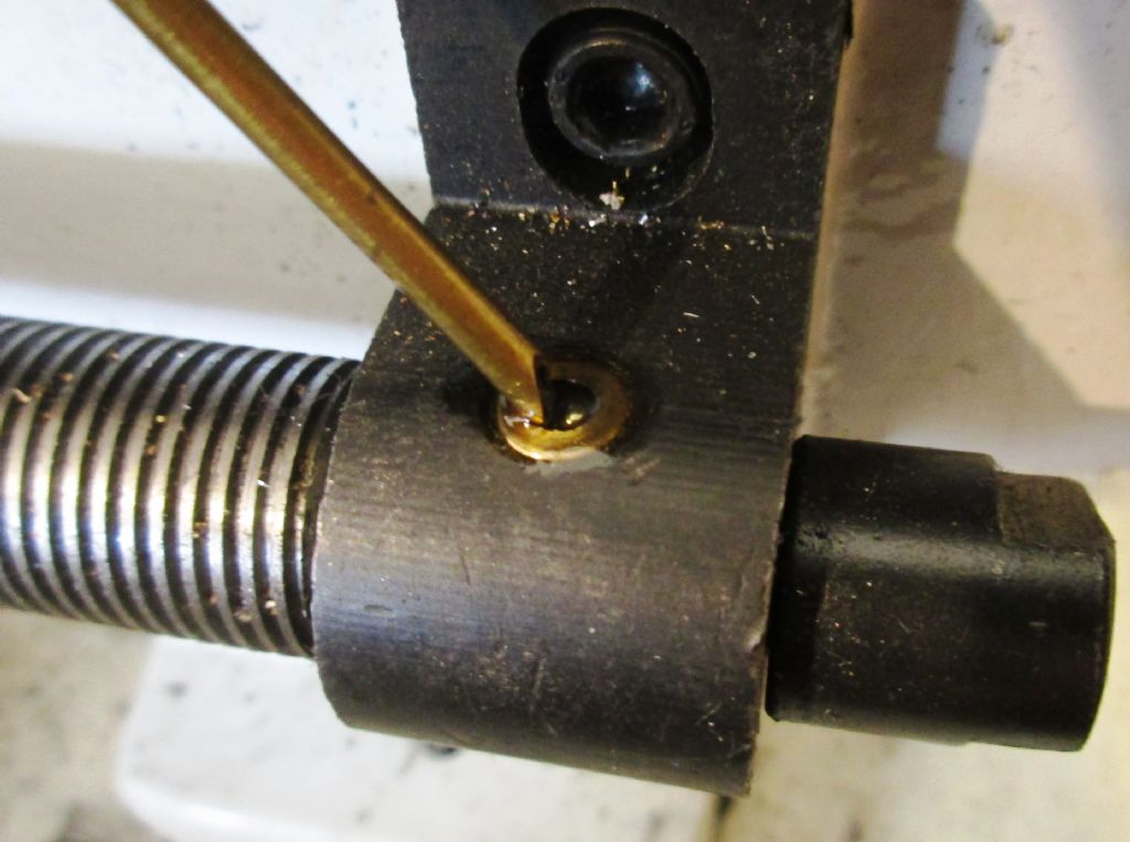

            Not familiar with this model, but the second question is easy. That type of oiling point is very common; inside a spring holds a ball-bearing in the hole to stop muck getting in. Any oil-pump with a nozzle that fits well enough to move the ball when pressure is applied will do. It's easier if the nozzle bends, though I just use the ordinary type and put up with a bit of mess and having to keep the pump full. The ball can also be depressed with a nail if only a gravity can is available.

                    Justin, as Hopper says, any oil can, with a suitable size nozzle, is used on those ball oilers. I haven't ever seen or been aware of anything special to use on them, you just push the ball down with the nozzle and you should only use a few drops of oil each time, as too much will just drip out somewhere.
                    Regards Nick.
                        Regards Nick.
                        OK, so it can just be dripped in with the ball pressed down. This would be OK for the hydraulic oil as its quite thin. But some of these oiling points lube the 'slide ways' and as far as i understand these need a 'way oil' which is a pretty thick stuff and I feel this would need to be forced in?

                              Hi Justin, that is way oil I'm putting in, in my photo. As far as adjusting gib strips, I start in the mid position ang go outward one at a time both sides. I agree with Dave W, fill to the centre of the sight glass, bit don't get bothered if it ends up a little above the centre.
