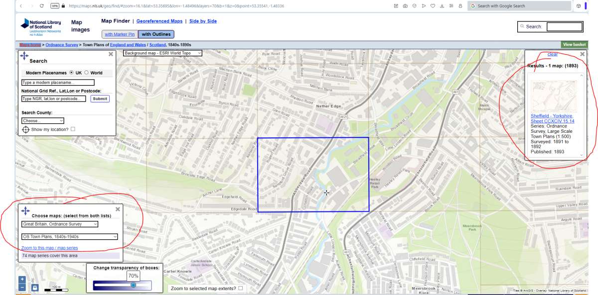

                I’m wondering about cistern myself.
                I’ll not include a screenshot, as I don’t wish to identify your house directly, but if you zoom in on this 1894  map, it may show something of interest.
                https://maps.nls.uk/view/125651290
                Then compare with the 1905 map
                https://maps.nls.uk/view/125651293
                No contours, but check out the bench marks for heights to determine possible water flow(s)

                  #795272
                  peak4
                    @peak4
                    I’ve deliberately put the cursor in the wrong place here, but if you reposition accordingly for your own house, the town plan might be interesting
                    image_2025-04-26_150238089
                    Bill

                                On Ian Parkin Said:
                                So a cistern is an underground storage facility? A well fills with water from the water table?
                                many thanks Bill for the links to the maps i do have a full size 1904 os map displayed in the hall but its black and white only and doesn’t show the blue bits (wells/sisterns)
                                The first link should also show where the stream used to be before they built the later houses; depending on heights, I wondered if that was piped to a cistern.
                                Did you get the town plan to show OK?
                                If not I’ll try and send you a working link via PM, but that doesn’t allow attached photos as I recall

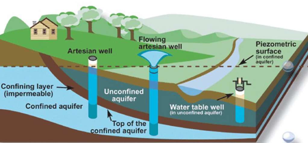

                                            On Ian Parkin Said:
                                            … she was surprised to find what looks like a well its about 1m dia built in bricks (all houses are stone) and full with clean clear water about 1.5 metres deep on pumping out the bottom is a clay type silt..
                                            IMG_3572
                                            What could it be for? Is it a well if so how does the water get there as bottom end of garden is below the level of water.  There isn’t any pipe work visible..
                                            Also a question all neighbours seem to ponder would these houses when built have internal plumbing both supply and drainage (1865) and also gas? For lighting heating?
                                            Probably a well, but don’t bet the farm on it without further investigation.  People have many reasons for digging holes!  To add to the list, it might be a French Drain, keeping the basements dry by encouraging water into a soak-away.
                                            Whether or not it’s worth digging a well depends on the geology underneath.  Usually taps into a waterlogged porous rock.  This diagram shows some of the possibilities:
                                            aw
                                            Most traditional wells were dug in the “unconfined aquifer”, that is a porous rock such as limestone laying on top of an impervious layer, usually clay.   Water-table wells in the “unconfined aquifer” fill with relatively new surface water that percolates down from the surface.  The surface excess flows into the stream.  Though most water-table wells aren’t particularly deep, they might be.  Castles on hilltops often have very deep wells.
                                            Well water will be clean provided the water took many years to filter into it.  Unfortunately, nature and man are both likely to fracture the rock, which allows dirty water to drain into the well, or the well might be fed from a nearby underground stream: dirty!
                                            A well’s brick lining isn’t simply structural, it also keeps recent surface water out.  Covers needed to stop animals falling in and festering.   Wells had to be cleaned regularly because stuff grows in them and rots. In the country there’s space to separate earth closets and wells, but not in a town.    There, it became necessary to pipe clean water in, and to pipe sewage away.   At first sewage was just dumped into the nearest river or pumped out to sea.  Both cause havoc; it’s necessary to treat sewage before returning it to the environment.   Plenty of opportunity for ignorant or penny pinching opportunists to poison the wells, and they do!
                                            The picture also shows Artesian wells, where water in a lower level is pressurised.   Might gush out, not needing a pump, or fill an ordinary well close to the top.   Deep water is millions of years old and biologically clean, though it will be mineralised – furry kettles!   Couple of problems with extracting it: the surface can subside cracking up all the buildings on top, and, deep water doesn’t last forever.

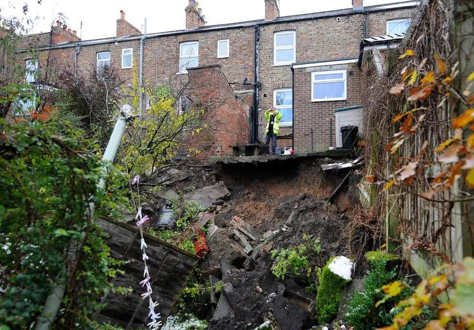

                                            Underground water isn’t always friendly.   Some rocks dissolve in it creating caverns not far beneath the surface.  Eventually the roof collapses and creates a sinkhole.  I have family in Ripon near this house:
                                            ripon
                                            Piped water, gas, electricity, and sewage disposal took well over a century to spread.  In the sixties house adverts still highlighted “All Mod Cons” if the home had them, because so many older properties didn’t!

                                                    Some notes on the various geological points raised above:
                                                    Ripon lies above a bed of gypsum (Calcium Sulphate), which is a more soluble rock than limestone and chalk (Calcium Carbonate), hence the ever-present hazard of collapses into what must be sizeable caverns eroded in it. Luckily they do not occur very often; but events like that photographed are not predictable.
                                                    These two minerals do not dissolve very well in pure water but even very weak acids corrode them. Rain-water is always naturally slightly acid from dissolved atmopheric CO2 (irrespective of anthropogenic additions), and can pick up more acids from organic material in the soil.
                                                    Water from a Chalk aquifer is likely to be safer than that from the more massive limestone, because Chalk tends to be fractured into innumerable small blocks separated by extremely fine fissures. This structure slows the overall flow through it and improves the filtering effect. A chalk aquifer is somewhat similar to one in gravel or sand; with diffusive, very long flow times.
                                                    Massive limestones (e.g. the Mendip Hills, Pennine Hills) host much larger conduits dissolved along joints and bedding-planes; including conduits developed to sizes humanly explorable as caves. There is not a water-table as such across the entire structure. Nor much of an aquifer though some water is trapped in overlying soil, peat hags or gravel deposits for slow release into the conduits. Consequently the water flows through from stream-sinks and soil-cover on the hills, to the risings, quite rapidly, typically in only a few days; and still bearing any micro-organisms, organic decay products or other potentially harmful additives it washed underground. It is still in contact with the rock for long enough to absorb some of the soluble minerals, though.
                                                    Both types of rock are chemically much the same, giving “hard” water. Hardness concentrations combined with flow studies are used in estimating landscape-lowering rates of Limestone and Chalk hill ranges: for example the rain dissolves away about 28 000t/yr from the Mendip Hills. That can fur a lot of Somerset kettles, showers and model loco boilers!
                                                    Underground water oozing from surface to spring does not spend “millions” of years down there, but can take very long times to emerge.  Though such water might be biologically “clean”, in some areas it might carry metallic salts it has found, although I don’t know of anywhere where this is a health problem. Mineral salts tend to flavour the water, so would be noticeable if too strong. A spa in the village of Radipole, near Weymouth, did not last long because the water is unpleasantly sulphurous from contact with the Kimmeridge Clay – even Regency fashions had their limits!
                                                    The water supplying Weymouth and Portland comes from Chalk aquifers overlying Limestone then Clay. The original pumping-station drawing from the source of the River Jordan (no not that one!) at Sutton Poyntz has been preserved as its own museum though open only occasionally or by special party booking. The displays include a framed certificate completed by the Sanitary Inspector early in the last Century, for a farm’s drinking-water well. He noted that the water was discoloured, and after recording what he found in it, concluded it would be eminently suitable as liquid fertiliser!
