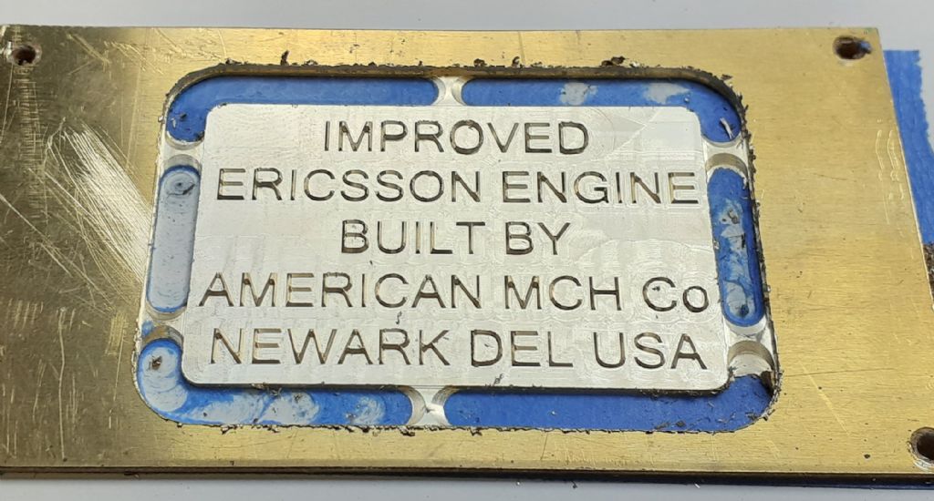

            Well this will be the last adventure on this version of the forum.
            A name plate that will be bent and then let into a recess on a cylindrical part to represent cast letters. They are raised and tapered though hard to tell if they are raise dor cut into the metal from the photo
            Plate is 50mm x 32mm letters 3.5mm tall and stand 0.4mm out of the background. Apart from the contour cut around the edge all was done with a 60deg engraving cutter with 0.3mm end width, 0.15mm stepover running at 5000rpm and a feed of 200mm/min. I left it running while I went out to do other things as the run time was just short of 4 hours to get through the 83,000 lines of code.
            The machining marks that are just visible on the background cannot be felt and will have disappeared by the time I have silver soldere dit into place, cleaned things up and probably bead blastsed for good measuer.

              How long did that take to do Jason?
              #662720
                There is a big clue in my post
                #662723
                Ady1
                  @ady1
                  aha!
                  I was just staring at it thinking omg
                  But 4 hours wasn't so bad, I thought more like 8

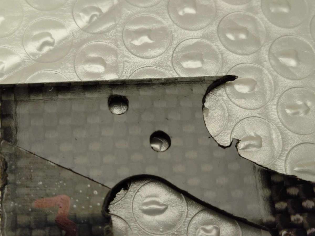

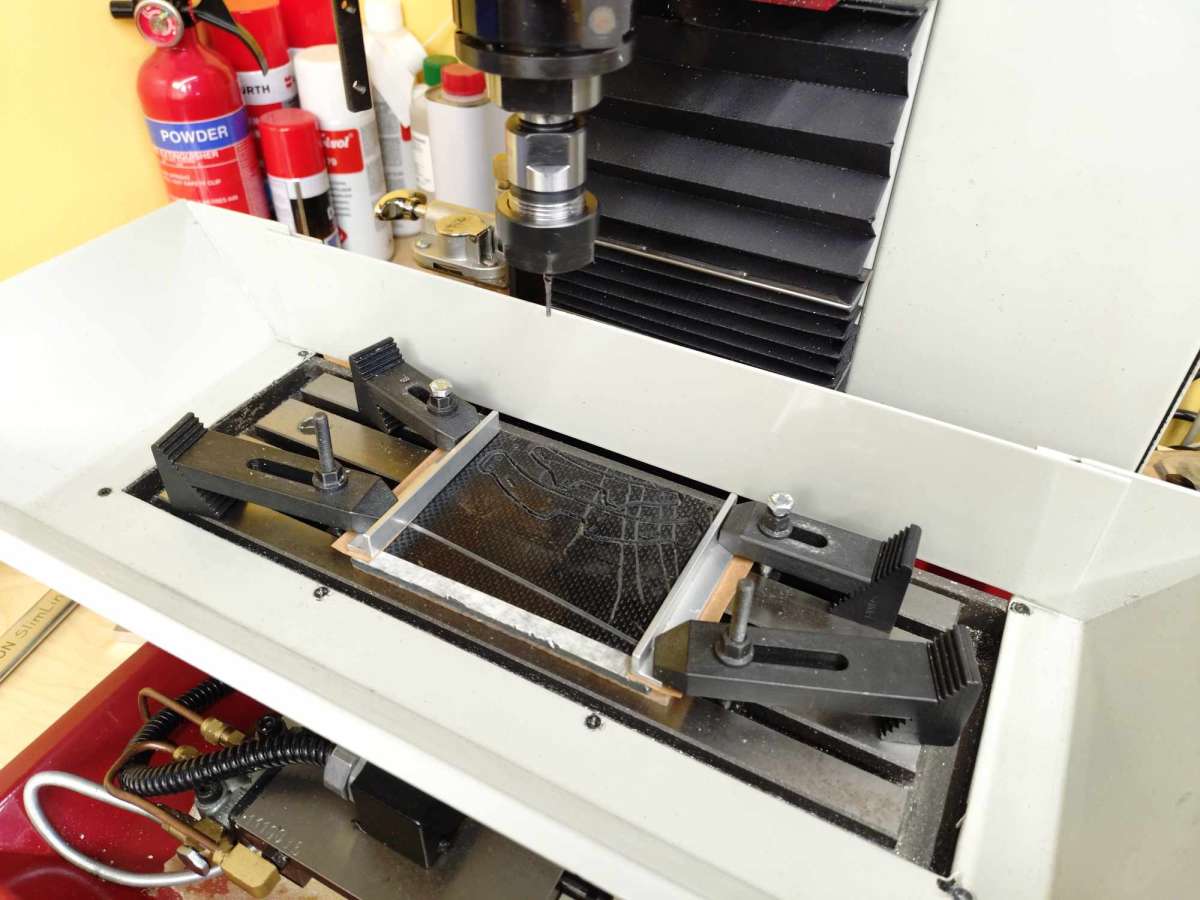

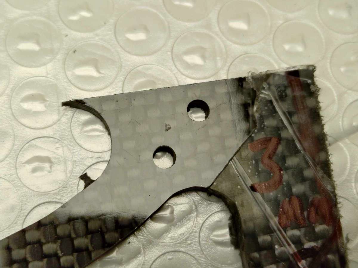

                    Sarah F
                      @sarahf

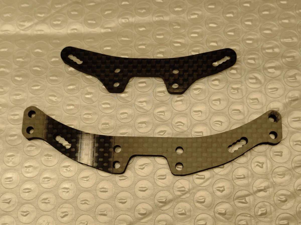

                      I’ve been out of action for a while now due to back surgery.  The good news was that it was successful and has reduced the pain in my legs immensly, though it has left me with week and wobbly legs.  Though I have been doing a bit in my workshop before surgery I have not undertaken any of my away from home hobbies for a few years.
                      I have started racing rc cars again and I have been impressed with the leap in design and engineering.  I could have spent a fortune on a new chassis but I wanted to see how I performed before doing that.  One of the trends has been to use shorter and fatter dampers.  I bought some for my current car, a Tamiya TRF419, knowing I should, hopefully, be able to make the required lower damper towers.  After getting to grips with my CAD programme I came up with a design and exported it as a .dxf file so I could use it with the CAM software Cut2D.  Exporting it as a Gcode to use on Mach3 for my Sieg Kx1 CNC mill.  I did a couple of ‘air’ runs, then a cut into pink foam as it had been a long time since I used the mill.
                      received_1171908991150825received_2439097586440385
                      received_456226864243274

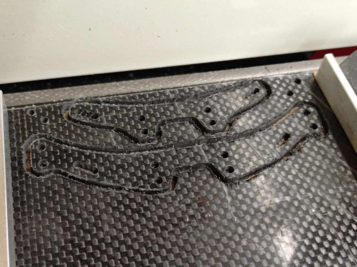

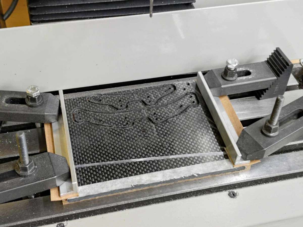

                      The profile edges are not rough, its the clear protective film on the carbon.
                      I did a few test runs to establish feeds and speeds and then cut out the two damper towers.  I did the profiling with a 2mm Routfish cutter at 160mm/min, 7,000 rpm which is  the maximum for the machine.  The carbon fibre sheet was 3mm thick, so I set the CAM software to cut 3.2mm, with 10 Tabs per damper tower (1.5mm long, 1mm high)  I did 3 passes at 0.5mm offset from the final profile then 1 final pass cutting to the profile.  The finish was excellent though there was a miniscule amount of delamination on the underside around the drilled holes, a 3mm Routfish cutter was used for drilling.  I did a little test using the 3mm Routfish cutter to drill a couple of holes and also using a 2mm Routfish cutter to cut a profile inside a 3mm profile.  The 3mm Routfish gave a great finish going in, but a touch of desalination on the reverse.  The 2mm cutter gave a good finish going in, just a minor bur on the outside edge of the hole.  The underside finish was better than the 3mm cutter.
                      received_1434711147909289The 3mm test holes, topside.received_1266283538053727The 3mm test holes, underside received_1159613639002732
                      I would be grateful for any comments as to:
                      Are my feeds and speeds in the right ball park?
                      Am I taking too many passes, 3 passes for 3mm carbon?
                      Is it worthwhile cutting to an offset, then doing a finishing pass.
                      Is there a way to reduce the delamination around drilled holes?  The delamination isn’t bad, it doesn’t stop me using the finished item but it would be nice to have a perfect hole finish.
                      Any other comments to aid in my work would be appreciated.
                      (I did use a face mask and had a vacuum cleaning running to suck up the dust)
                      Many thanks,
                      Sarah 😊

                        Julie Ann
                          @julieann
                          The feedrate seems a little slow, about 0.02mm per rev, so the cutter may be rubbing more than cutting. While composites are more abrasive than homogeneous plastic the general rule for plastics is not too fast on rpm combined with high feedrates. The problem with high rpm is that it can lead to the material melting.
                          On passes I would definitely try doing two steps down and would stick with a final full depth pass to clean up. It looks like a bigger cutter could be used for the profiling, leading to fewer passes, higher feedrate, and less machining time.
                          For holes it might be better to drill rather than mill. Using drills specifically for composites should eliminate the delamination at entry:

                          Sarah F
                            @sarahf
                            Thanks Jason,
                            I’ll look into whether it will do a helical cut, I can do a 2mm drill and then a second routine to profile out to 3mm dia.

                            Sarah F
                              @sarahf
                              Hi Julie,
                              Thank you for your reply.  How much of a higher feed rate would you suggest for a 2mm, and a 3mm, Routfish cutter?  The Kx1 CNC mill can only manage 7,000 rpm.
                              I will try and do the shock towers in two passes, with a final finishing pass.  I set up the profiles with ten tabs, would that seem appropriate?
                              I’ll get the drill but you suggested to try.  I do have quite a few bits to cut out of carbon so I’m happy with a bit of experimentation.

                              #790468
                              Julie Ann
                                @julieann
                                I would do some experiments starting a 2mm cutter at 200mm/min and 3mm cutter at 240mm/min. The cutters aren’t super expensive so it’s not a disaster if one breaks. I don’t like breaking cutters, but it is all part of the learning curve and pushing limits.
                                I think ten tabs sounds about right, where they are placed is as important as quantity, usually at extremities and thin sections that are liable to lift under cutting forces.

                                Emgee
                                  @emgee
                                  Hi Sarah
                                  Just asked a friend who does a lot of carbon fibre sheet machining and copy of his reply below.
                                  These are the right cutters. Use the 2mm or larger.
                                  ROUTFISHM – Carbide Spiral Flute Router, Fishtail point Metric Small
                                  I cannot help you with feeds and speeds as 8K RPM is very low, I would normally feed at around 800mm min with 16000 RPM and do a pass at 1.5mm then full depth.
                                  The carbon sheet has to be fully cured.

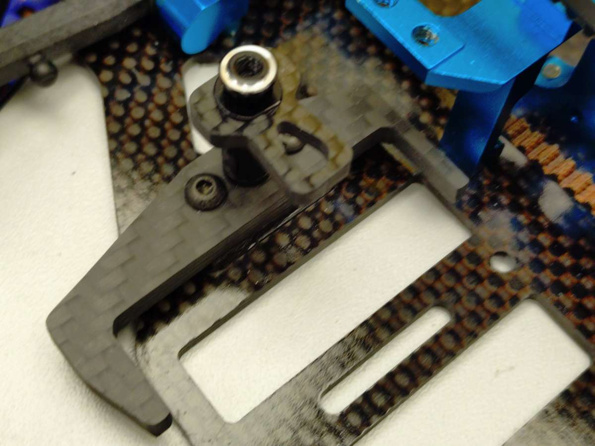

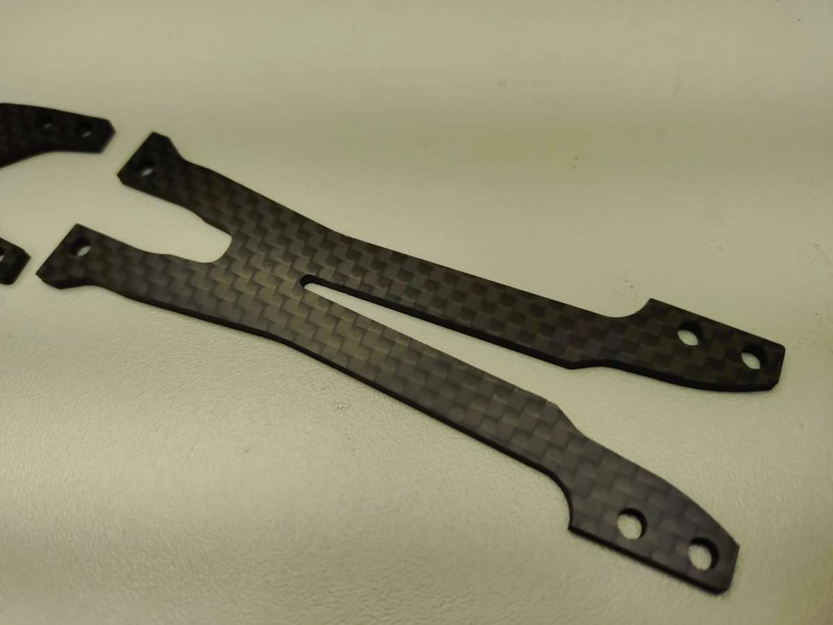

                                              Sarah F
                                                @sarahf

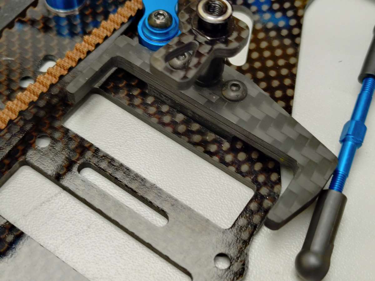

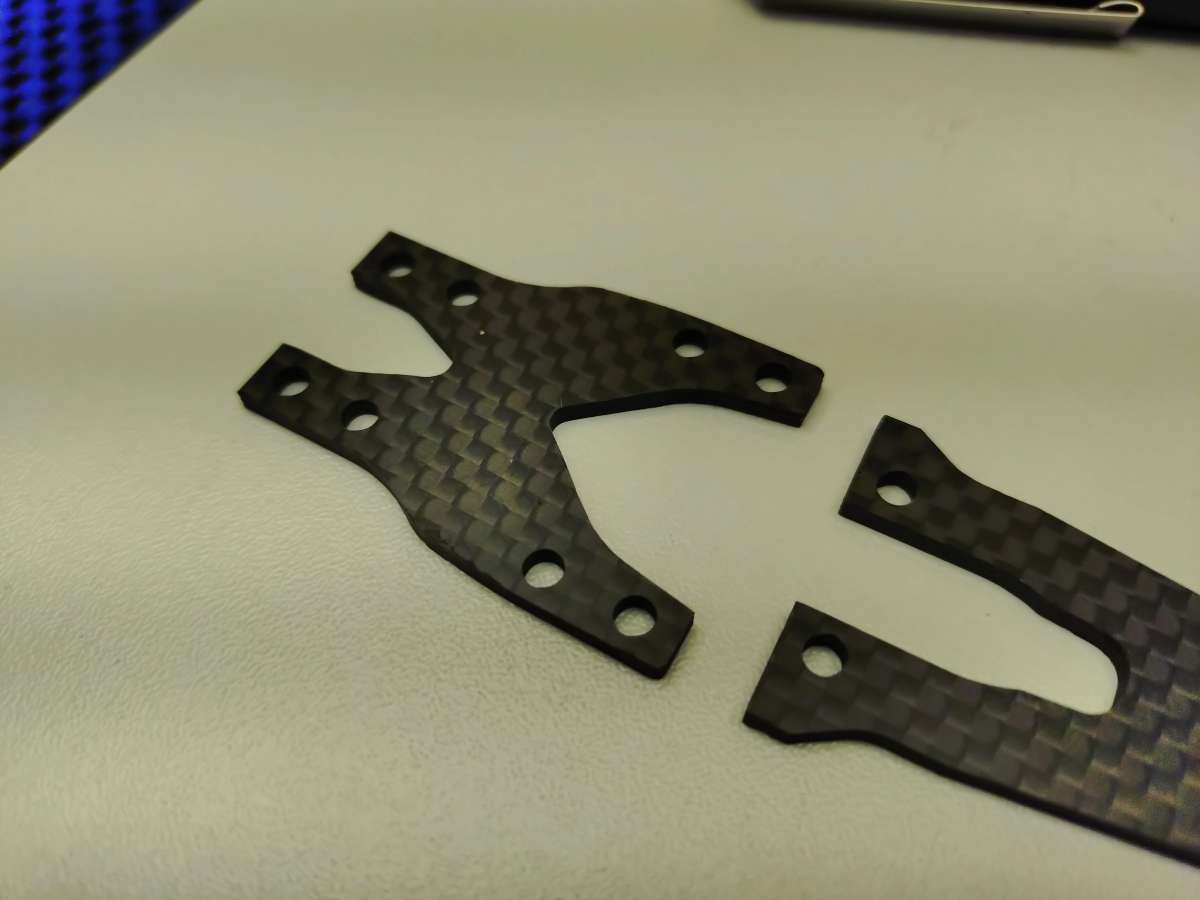

                                                I have been machining more carbon fibre sheet parts for my model car.
                                                I have given up on actually drilling holes, I actually use a 2mm cutter to pocket out the 3mm holes.  This gives a lot better finish on the reverse side with virtually no delamination.
                                                The Battery Retainers were cut in 4mm matt finish carbon sheet, the matt finish does seem to machine better with no signs of delamination at all.  I started the process by sticking the printed CAD drawing onto card, when it was close to the finished shape/size I laser cut them from thin ply.  When I was happy with the wood cutouts I CNC’d the finished product in 4mm carbon fibre.  The parts needed a very light needle file to get a great fit for the Lipo battery.  The press/swivel keepers to keep the battery in place were copied to CAD, lengthed by 3mm and then cut in 3mm thick carbon fibre sheet.
                                                20250422_125414743
                                                20250422_125419906
                                                The model car had a one piece top deck, which had two columns linking it to the bottom deck.  The steering system utilised the bottom section of the columns.  I made a new low mount for the steering system, which allowed me to dispense with the columns linking the top and bottom decks.  I could now split the upper deck into two, which not only makes maintenance easier but allows more flex in the chassis.  I have a few variations of the front upper deck, which allows me to play with how much flex the front of the chassis has.  Pictures of the two part upper deck are below.
                                                20250422_125518745
                                                20250422_125526693
