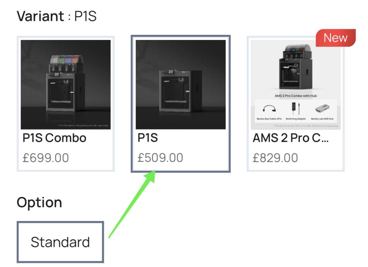

          I may live to regret this but, I bottled-out of buying either version of the AMS and bought just the Printer and one reel of Black ASA filament.
          Exciting times ahead …

            Once again the forum software has prevented us from seeing your excitement!
            #795122

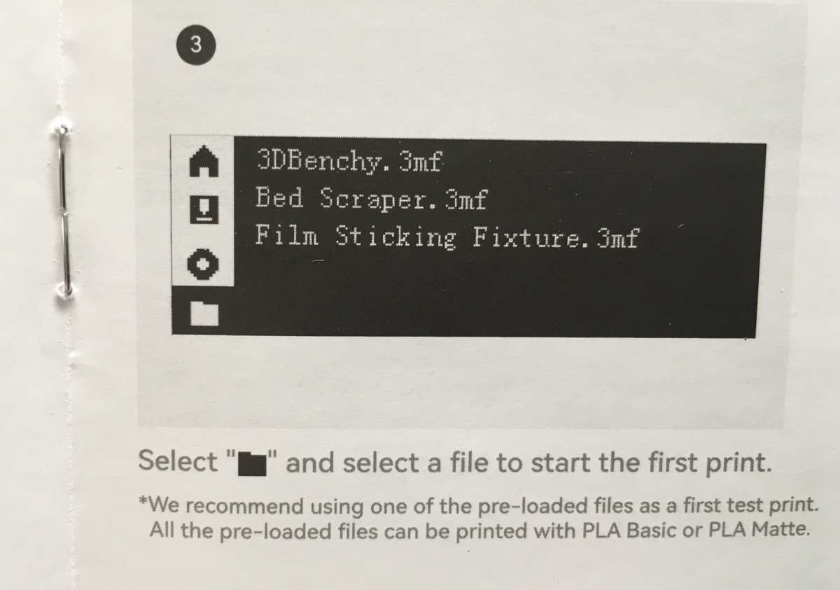

              Presumably it doesn’t like .png files
              … it was just a small clip from a screenshot, showing the three available options.

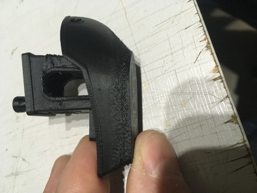

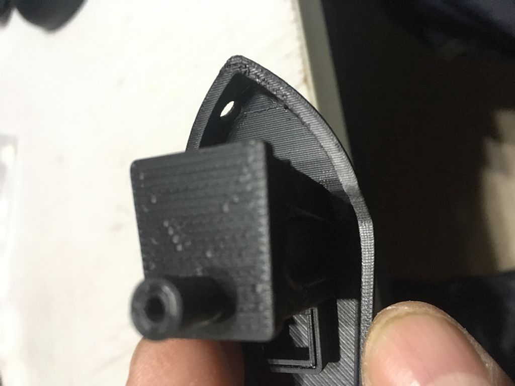

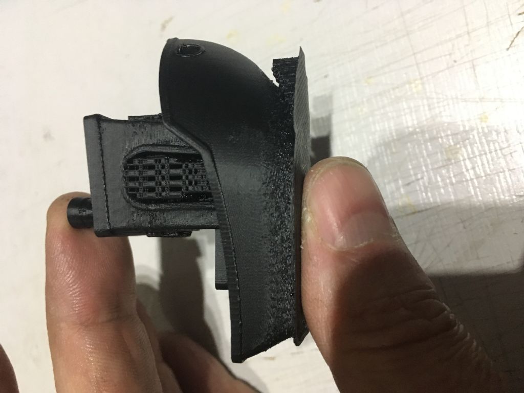

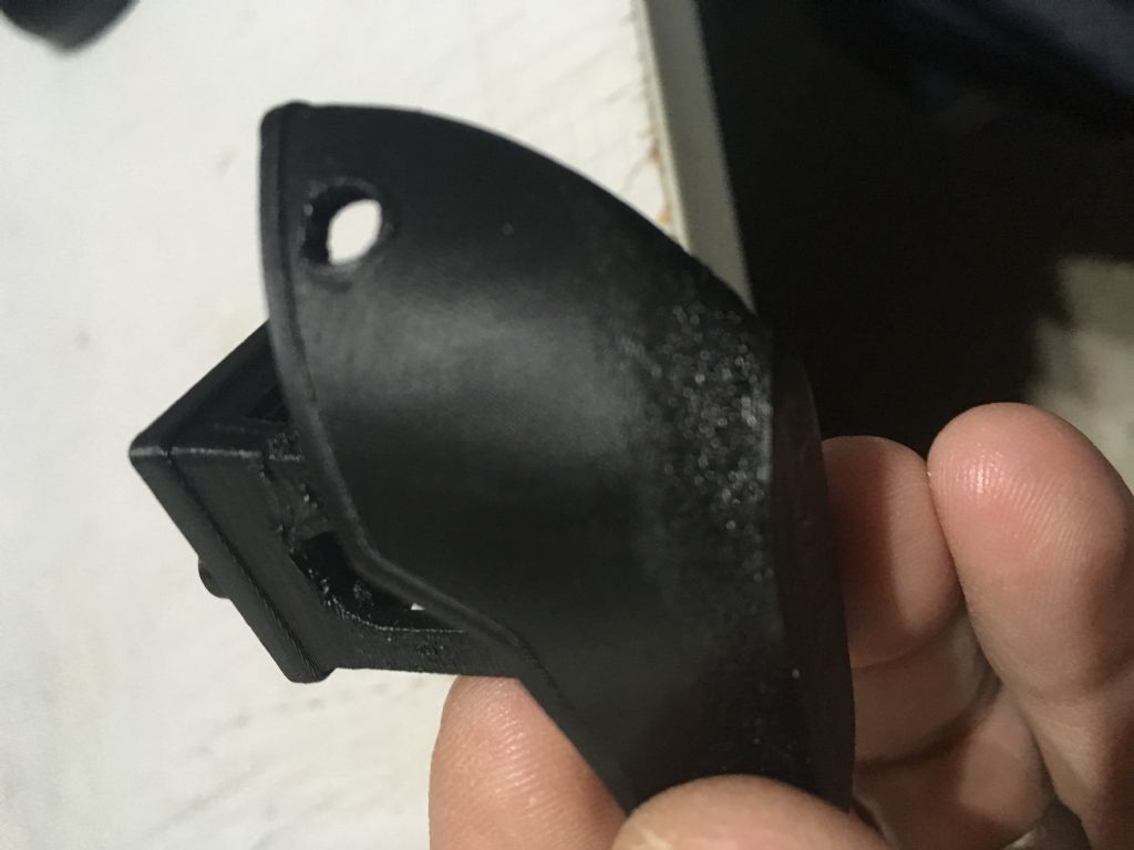

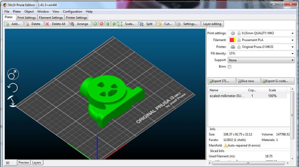

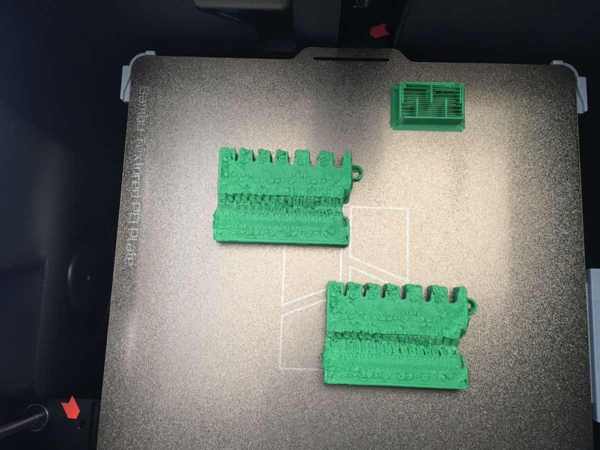

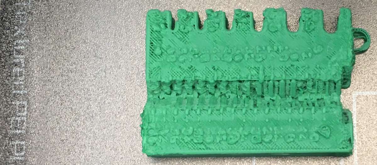

              #796003
                Oh dear, what a mess !
                After a successful self-test, followed by a firmware update, followed by a 26 minute calibration run … I finally got to choose a test file to print; and selected ‘Screw Gauge from the list.
                I think it took 1 hour 44 minutes to produce this worthless heap of scrap plastic.
                Any advice would be gratefully received.
                Posture
                #796006
                Matt Harrington
                  @mattharrington87221
                  Oh dear. Is the nozzle temp too high?  (not that I have much experience yet!!)
                  I’m surprised it took 26 mins to calibrate.
                  Not sure what slicer you are using but assume you have it matched to the filament you are using….
                  Matt
                  #796015
                    Thanks, Matt … I need to try again, with some smaller files
                    I may have set something wrongly, but I think not.
                    No slicing done by me on this one … it’s ready to go as one of the sample files.
                    Filament was the sample reel provided with the P1S … fresh out of its sealed pack.
                    It all sounds so easy in the little booklet 🙁

                    #796022

                      I have only used pla filament. I think it is recommended for beginners .
                      Only had a problem once when the first layer came unstuck from the bed.
                      Perhaps you need to change the settings. I notice on the screenshot it says suitable for pla, so may need changing for asa.

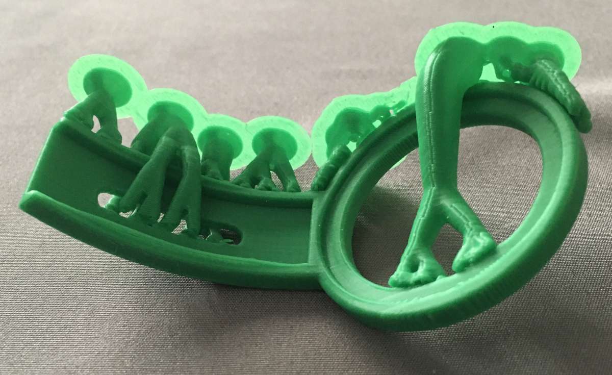

                        #796046
                          Here’s a crop from that snapshot  I posted earlier:
                          IMG_0740
                          #796049
                            … and I believe it’s supposed to look like this:
                            https://www.printables.com/model/482704-original-bambu-lab-screw-gauge
                            #796054
                            Grindstone Cowboy
                              @grindstonecowboy
                              I’d say hot-end too hot, or cooling fan not working.
                              Rob
                              #796072
                              Fulmen
                                @fulmen
                                Looks like a serious case of under-extrusion. Check for clogs, slipping extruder and filament jams.
                                #796084
                                  Thanks for the comments … although I confess to being bewildered by Fulmen’s
                                  … the bad areas look like dripped candle-wax, which suggests to me an excess of material rather than a shortage.
                                  Whatever … I am perfectly willing to accept having made some stupid ‘operator error’ and I will need to proceed more carefully.
                                  It may be a few days before I get back to this.
                                  #796087
                                  Fulmen
                                    @fulmen
                                    It’s hard to diagnose something from a single photo, but look at the cross hatched flat sections. It looks like half the surface is missing, suggesting under extrusion. Should be simple enough to confirm with a scale, the slicer should provide the theoretical weight.
                                    How does the nozzle look?
                                    #796094
                                      I take your point about the about the missing surface layer … the model that I linked is clearly fully skinned !
                                      This was the first run on a brand-new machine … everything [except the result] looks perfect.
                                      Urgent domestic chores to do now, but thanks for the suggestion about weighing … I will do that this evening.

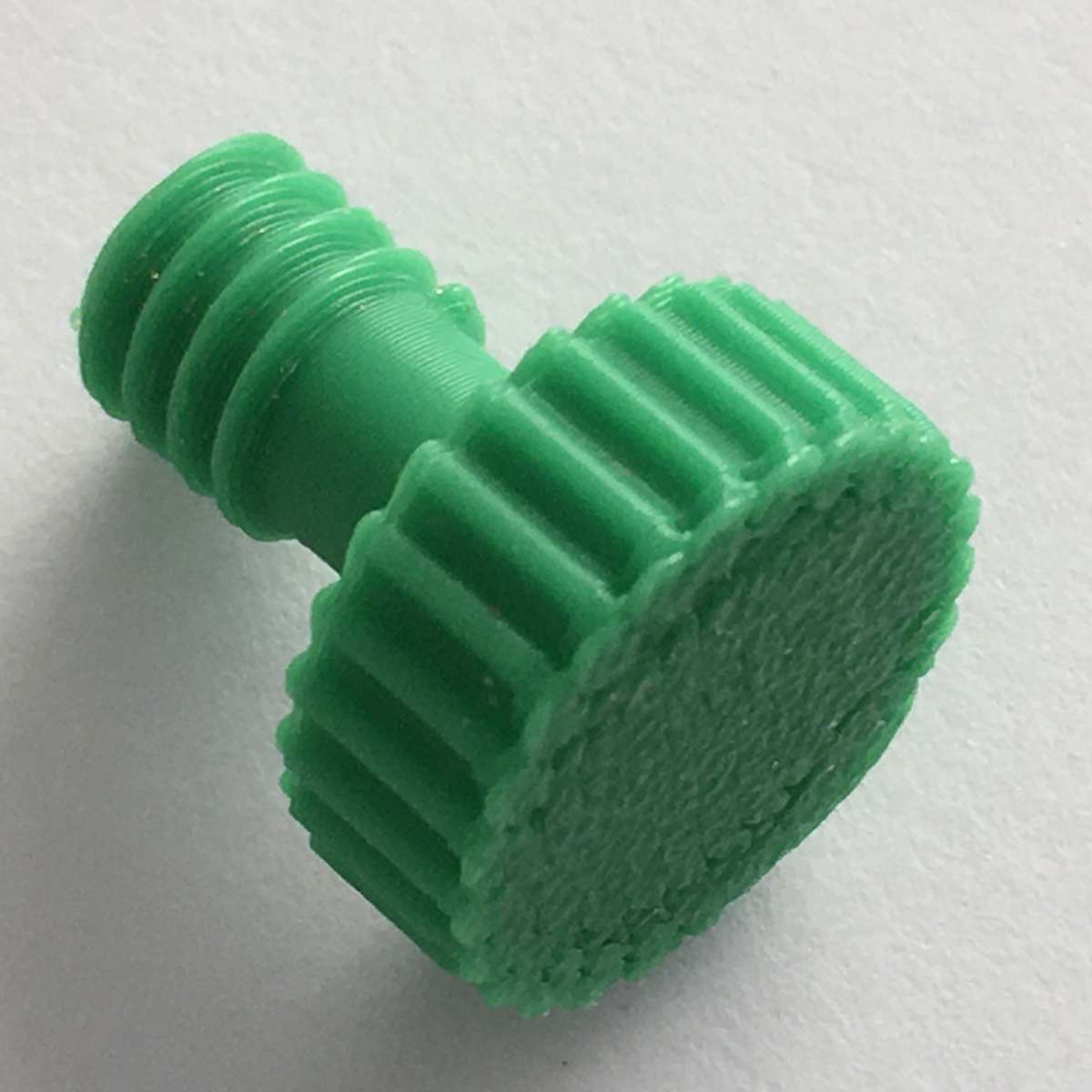

                                      #796169

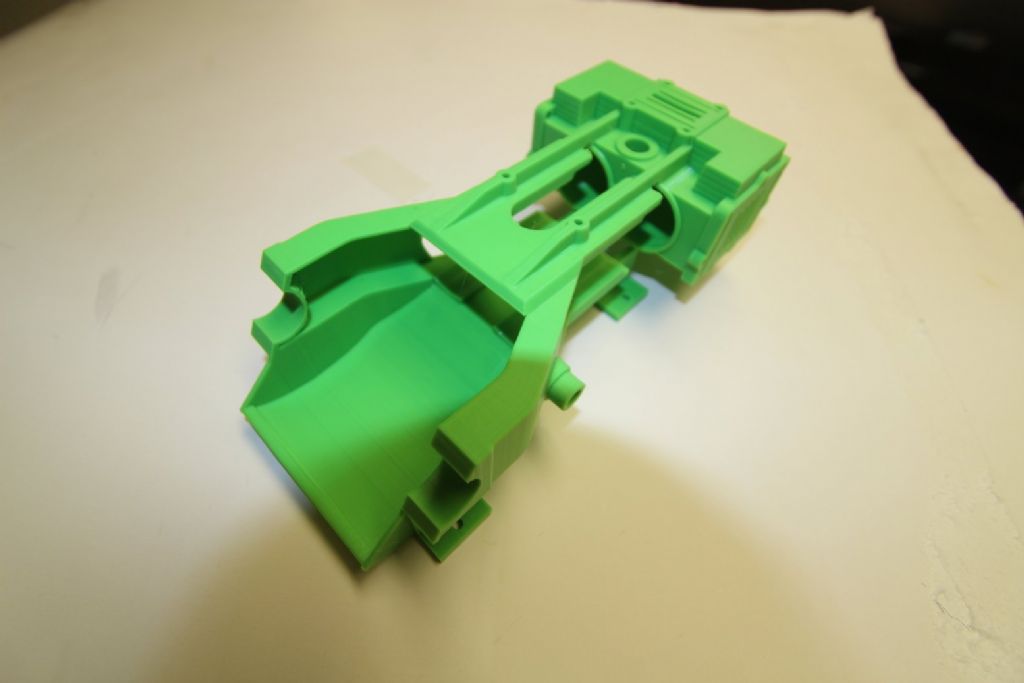

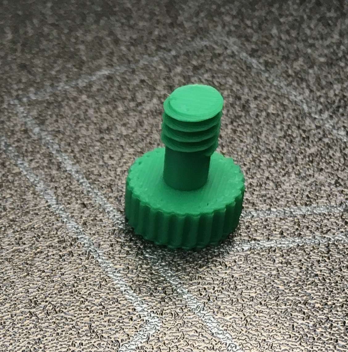

                                        O.K. __ I still don’t know what went wrong yesterday, but I am much happier now, and really rather impressed with the Bambu Handy App
                                        I switched the printer on, adjusted nothing, and retired to another room
                                        Then searched for something reasonably small and familiar to print … and found a 1/4 20 camera screw
                                        Having simply confirmed a few details of the printer, filament, and plate, I then sent it to print [no physical interaction with the printer]
                                        Twenty minutes later I collected this:
                                        IMG_0746
                                        IMG_0747
                                        It’s not perfect, but it’s very useable

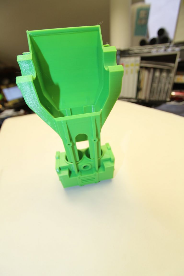

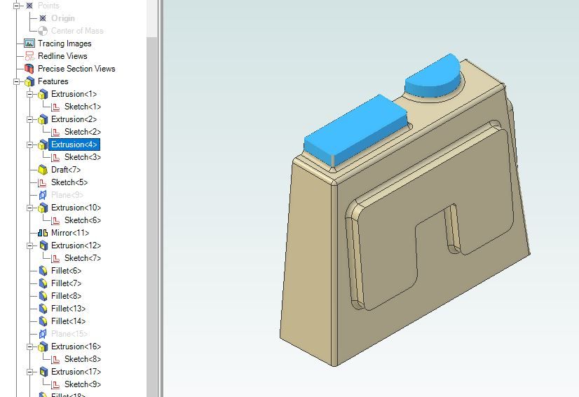

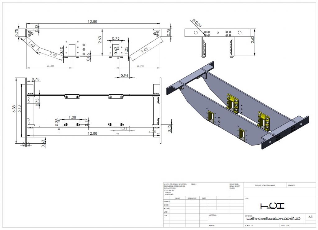

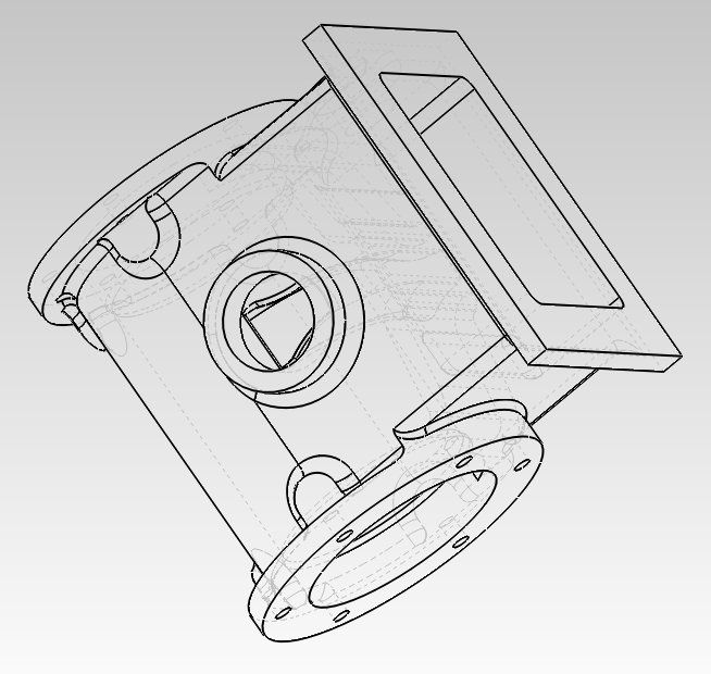

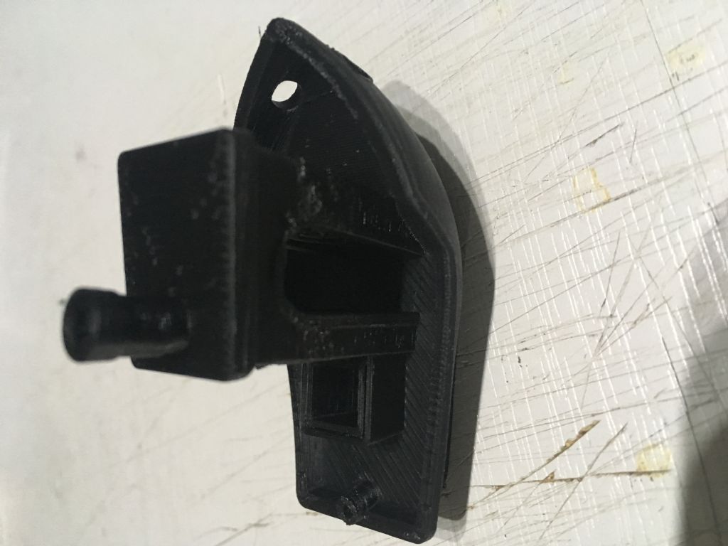

                                              #796669

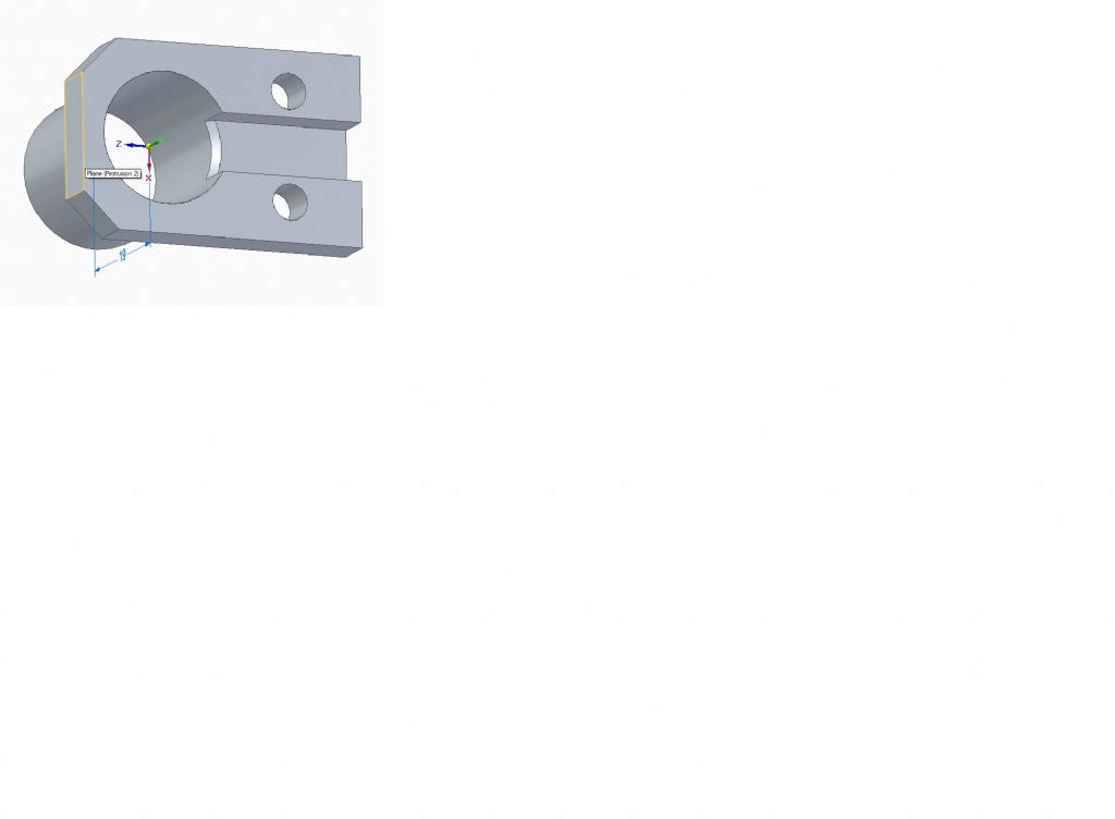

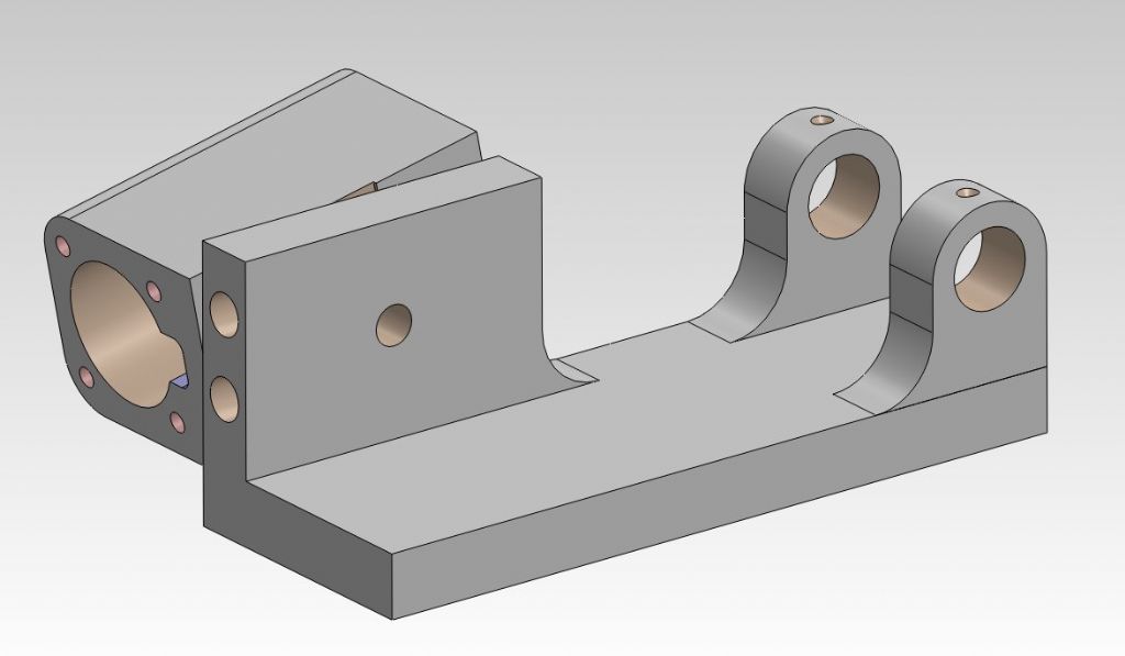

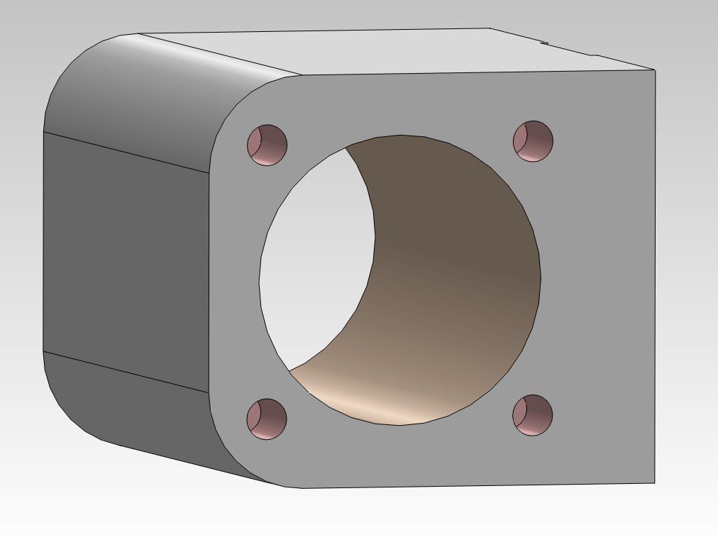

                                                I am still only in the low foothills of this adventure, but I am already astonished by the capability of the Bambu Lab P1S and its software.
                                                With enormous thanks to Jason for preparing an stp file from his fancy drawing package, I imported this into Bambu Studio [accepting its default settings for things I don’t yet comprehend] and then ran its slicer, which gave a warning about the cantilever and promptly created a support tree [again I simply accepted its suggested settings].
                                                Although the result could clearly be improved by changing the orientation, or whatever … this first run demonstrates, without a shadow of doubt, that the printer will do what I want.
                                                Lots of learning to do …
                                                Posture
                                                Observant readers will recognise the shape of the bracket from my Avatar [which is taken from a Zeiss patent]
                                                #796680
                                                Journeyman
                                                  @journeyman
                                                  The learning curve is indeed steep. Have been using 3D printers (now on my 3rd) for years and still learning the the finer points in the myriad of settings. Have just started using Orca Slicer (well AnyCubic’s version of it) having spent a couple of years using Prusa Slicer.
                                                  As to orientation that part would probably print if the larger diameter section was laid flat on the bed with the curved section pointing up. The software may suggest support or a brim but would likely print without.
                                                  Worth considering when orienting parts on the plate that, depending upon what the object is, it will be stronger in one direction than the other. The filament being in layers is prone to breakage along the ‘grain’ like wood but much stronger across the grain. Always worth  thinking about the intended use before deciding which side should go on the plate. This is particularly so with small parts where there is not much plastic.
                                                  It can often be beneficial to design things in two or more sections to take advantage of the ‘grain’ direction and create a mechanical joint, mortice & tenon or dovetail, between the parts.
                                                  To quote Prusa ‘Happy Printing’.
