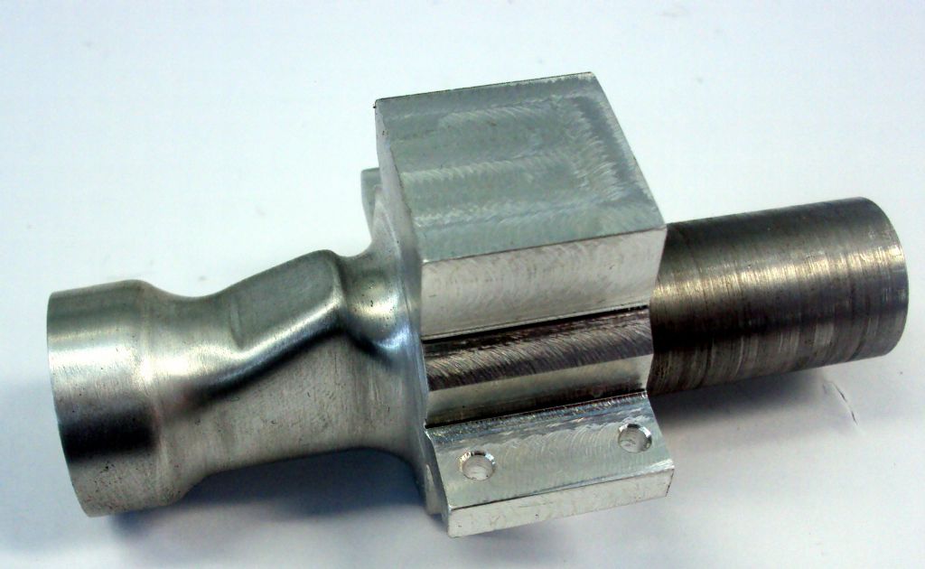

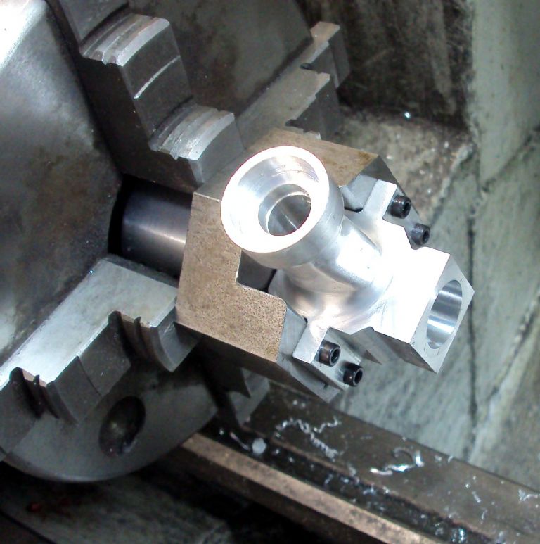

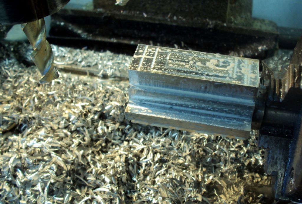

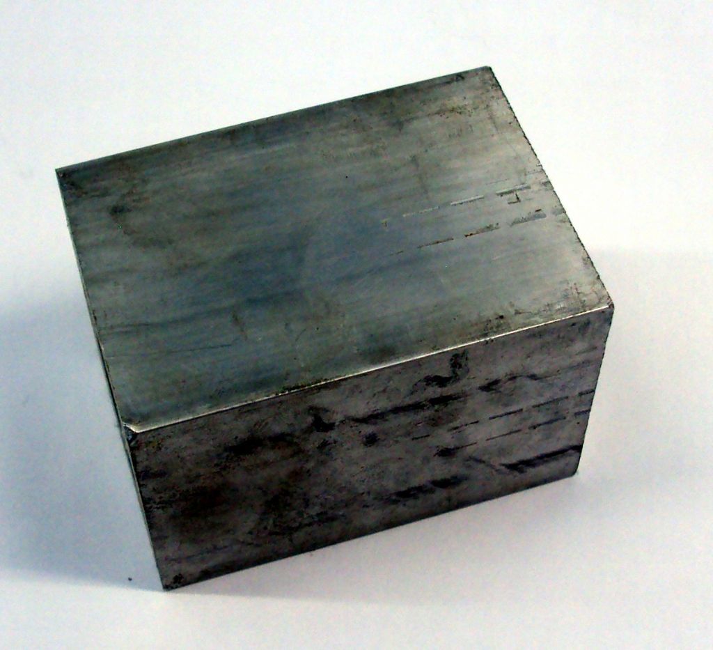

      So with the v12 project in the last stages and not wanting to start anything new until I have finished off all the other half started projects I thought I might share my first foray into diesel engine building. A while ago I was looking in the gallery of Ron Chernics modelenginenews website and found some photos of the Naylon Viper 2.5cc diesel engine that some clever sod had built which looked really nice. Being a rather fanaticle control line flyer from the days of my earliest childhood ( thanks Dad ) I have always had a strong love of diesel engines, especially 2.5cc engines. Having owned and flown most types I just had to have a go at building one ( Ok or two or more) so I decided that this was the engine to build…… not having any drawings to speak of I managed to find a couple of GA drawings for the motor a mk1 and a mk2 as it turned out, ok so I'll build them both then………having seen ramons moverly hogging from solid with the eta's etc I decided I'll do a front rotary induction version as well and of course the set wouldn't be complete without an inline twin so ok I'll build that to. After having found so lumps of alloy things got put on the backburner so to speak when the v12 started to take shape but now I think it's time to carry on with the show… below shows whats been done so far..
      So lets start the machining yay
      Thats a lot of swarf LOL

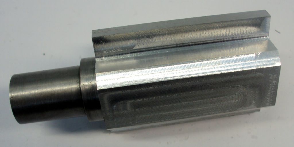

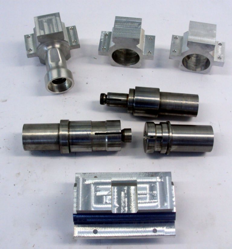

      Below shows the crankcases all done to the end of the first stage of machining.
      Cheers for now
      Dean

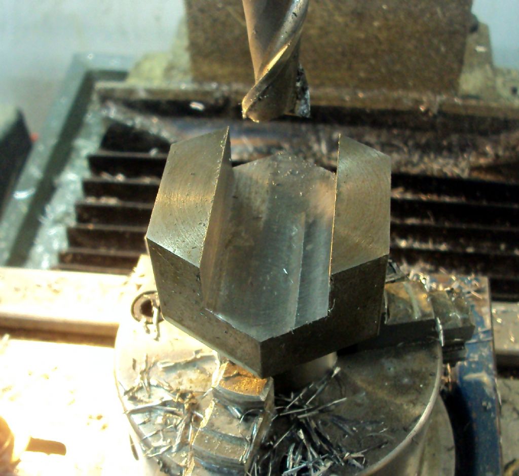

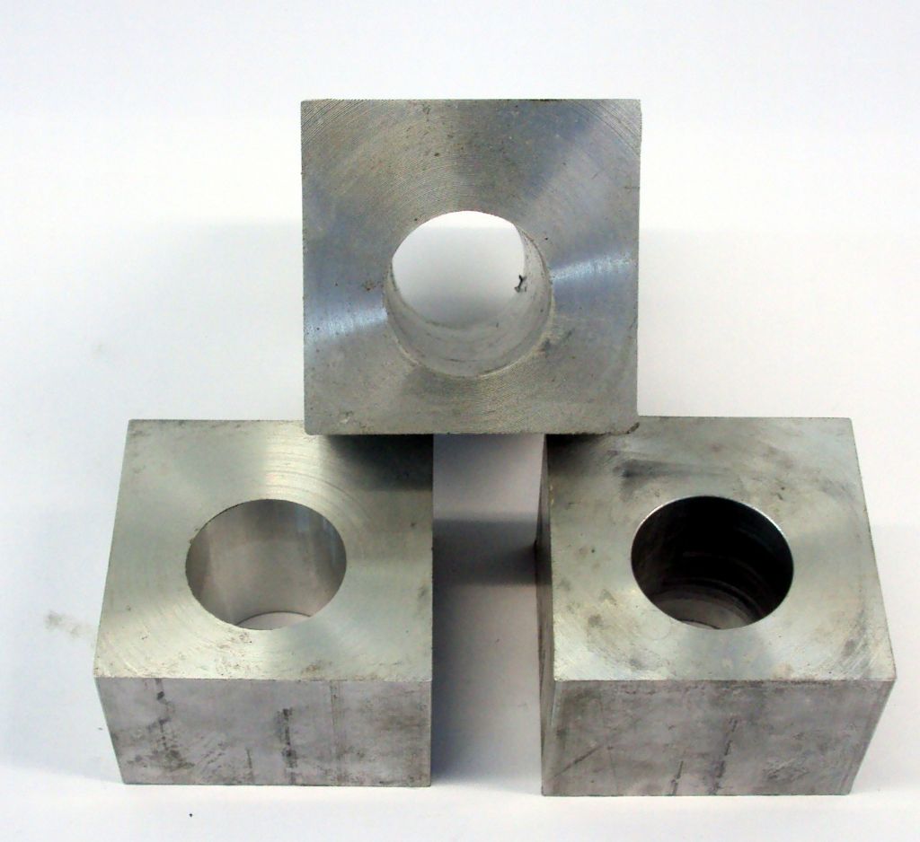

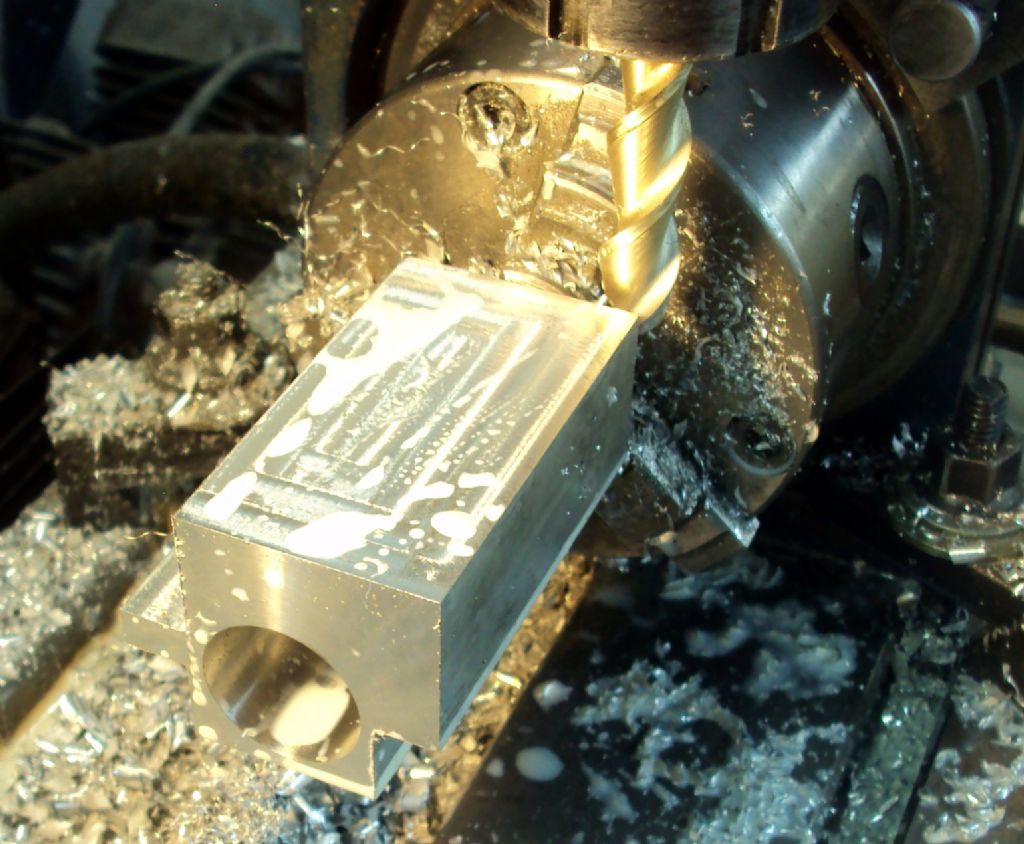

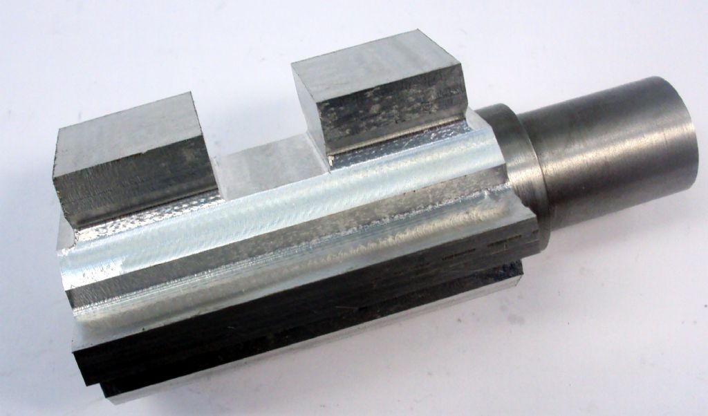

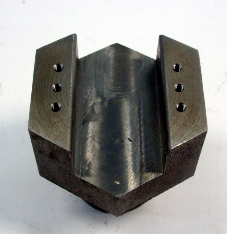

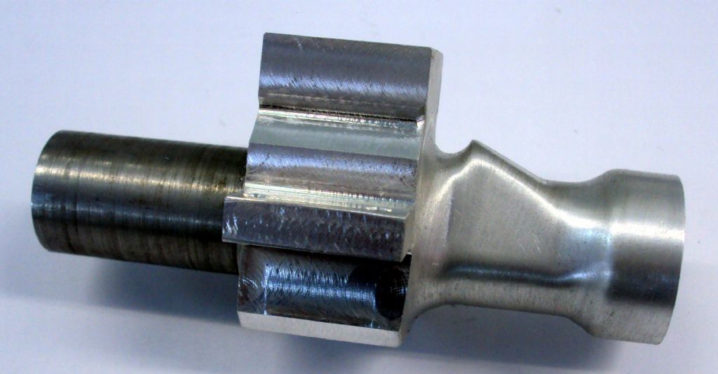

            Well managed to make the fixture to turn the cylinder bore last weekend and will hopefully have the cases finished this weekend. photos below
            starting the cylinder hole machining in the frv version
            cheers
            Dean

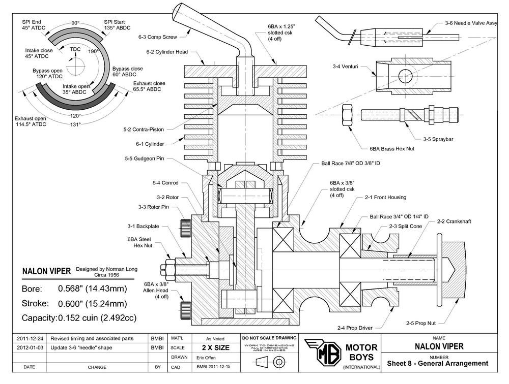

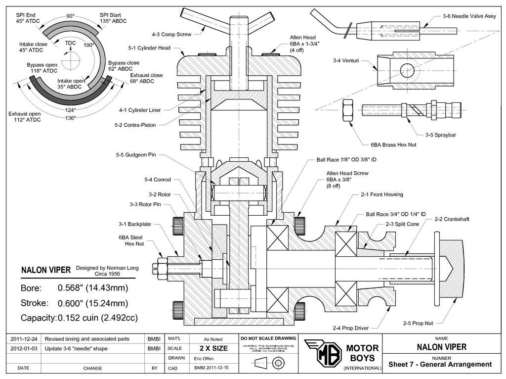

            #222913
            Muzzer
              @muzzer
              Wow, work is proceeding at a blistering pace! Looking forward eagerly to progress updates.
              I was wondering how the mixture was fed in and also what the "3-2 Rotor" did. Seems this machine has a rotary (disk) valve at the rear of the engine (rather than on the crank in the second version) which answers both questions.
              Interesting overview of the Viper here for ignorami like myself.

              #222996
              dean clarke 2
                @deanclarke2
                Hey there, the original naylon vipers (mk1 and mk2) were both rear disc valve induction, I am also doing my own design front rotary valve induction version, will keep the update coming as much as I can. Oh and of course the inline twin is center rotary valve induction and I will post a pic of the crank arrangement for any of you that is interested in the way this works.
                Cheers
                Dean

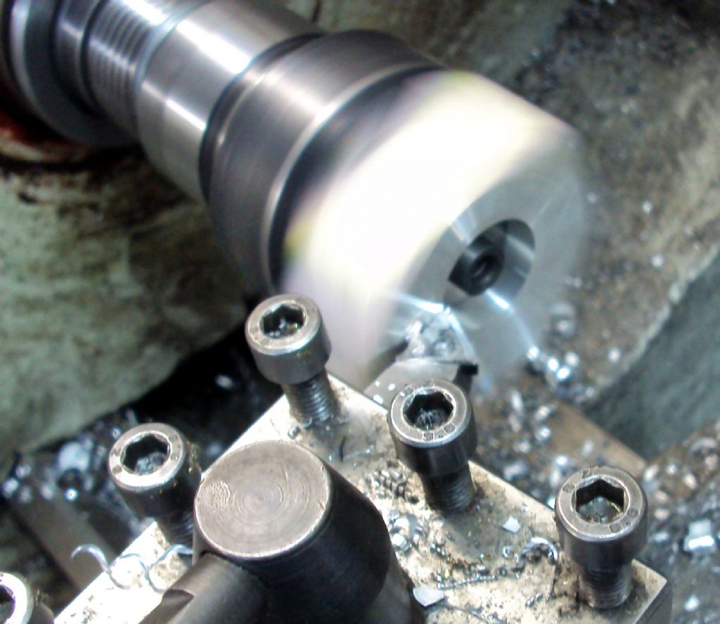

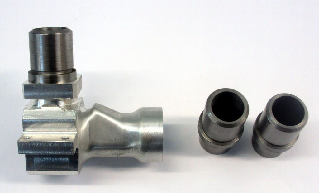

                  Here's the next little bit on this project, cylinder liners are under way…..YAY
                  Cheers
                  Dean

                    #226848
                      Posted by Neil Wyatt on 25/02/2016 10:10:50:
                      Ah! I thought you must be doping something like that.- can't figure out the disk induction at all from the GA.
                      That bit at the rear of the crank on the GA called a Rotor is the induction disc. Must try harderwink 2
                      The hole for the venturi is in one corner of the backplate so you can't see that in the section, have a look here for enlightenment
                      Looking good Dean
