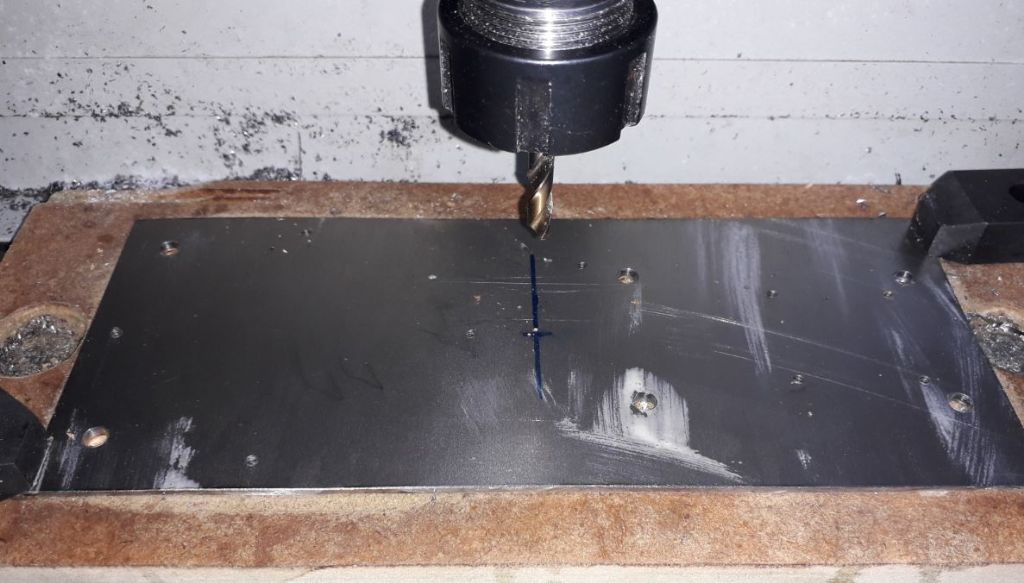

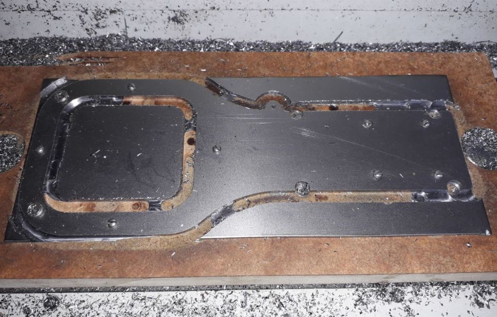

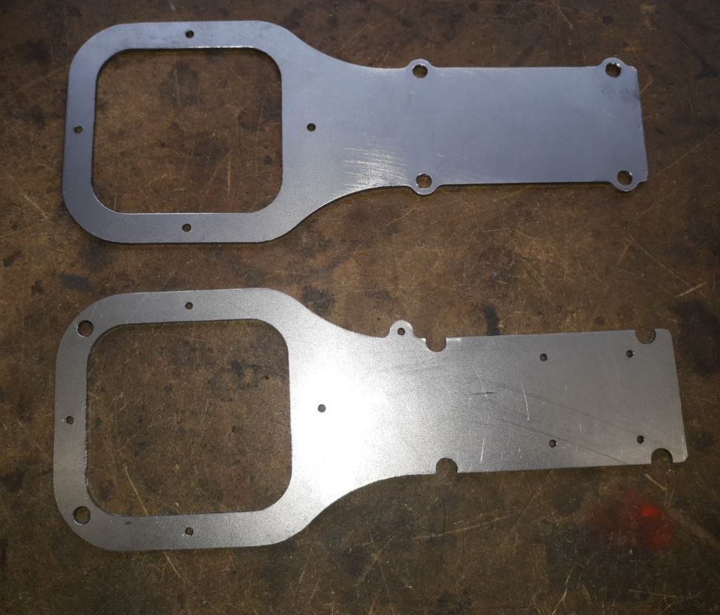

          Well while most of the membership seem to have spent the last few days in the armchair working out what size knurl is needed to go around a propane tank to ensure that it gets a CE stamp I have been playing with the KX3. smile p
          It is all well and good cutting random shapes into bits of scrap to get the feel of things but nothing beats making more productive swarf. To this end I have been drawing up the next stationary steam engine for a while and was possibly going to get a couple of the parts laser cut but now that I have the CNC what better way to learn and be productive at the same time. The base "casting" of the engine will be a sandwich of 3 layers so I started with the bottom one, the upper is similar but has some different holes and bosses.
          A Step file of the required part was exported out of Alibre and into a CAM program where I generated the G-code for the holes and the actual shape as separate sets of code to make it easier for me rather than have to incorporate tool changes. I air ran the code first of all and then again into some PVC which showed up a slight error in heights which was corrected before cutting metal.
          I started by clamping the stock onto some MDF and first ran code for eight 3mm holes, then after changing bits ran another code to enlarge four holes to 6mm. After that these holes were used to screw the 2.5mm thick plate to the MDF so that the clamps could be removed. After changing to a 6mm 3-flute HSS FC-3 cutter the button was pressed. I'm more than happy with what came out for my first proper part using CAM and the first time cutting steel and this plate is a bit gummy.
          A couple of areas did not quite cut all the way through which was probably due to the scrap MDF that had been sitting around for a while but that just tore away. You can also see that I left some 1mm thick tabs to stop the larger pieces of waste moving about.
          Final item after a quick clean up of the burrs

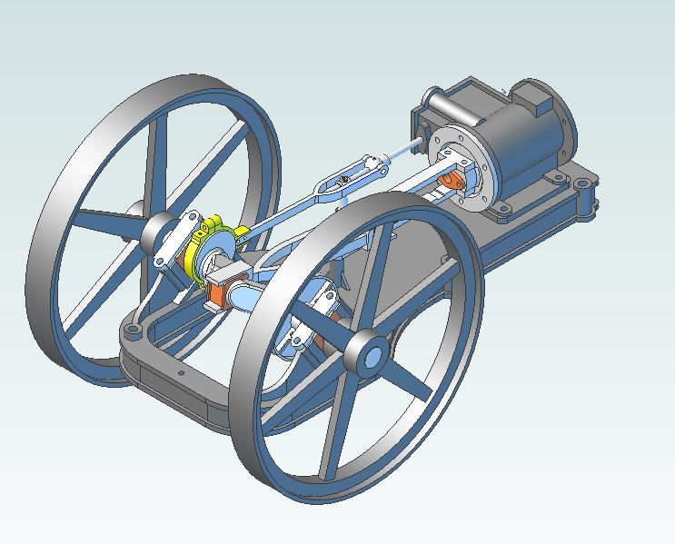

                          Looking good Jason, are you going to tackle the pair of flywheels from solid, I would have thought the CNC ideal for that type of work.
                          Ron
                          Edited By JasonB on 27/04/2019 14:21:47
                          #404141
                            Ron, I'm still deciding which way to go as they have more detail than the rough sketched ones shown, the spokes are a soft + cross section. May go for slices of CI, separate spoke "disk" with a rim & hub or could even modify a casting to get the spoke profile right.

                                  The conrod and eccentric rod are bot "wishbone" shaped with the crosshead being on a single guide that fits between the fork rather than the more usual pair of crosshead guides that the conrod runs between. It uses split bearings with cotters and wedges which should keep me quiet for a while, similar to the Benson engine I did some time ago.
                                  The two photos that I am working on are here and here, don't have much detail but it is most likely French and carries the makers initials "FD"  or could be Fives Lille. The teardrop shaped hoop will contain a governor that has gone walk about over time.

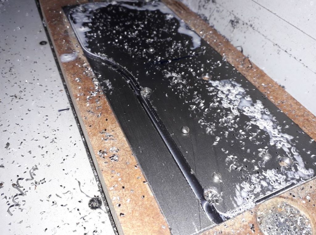

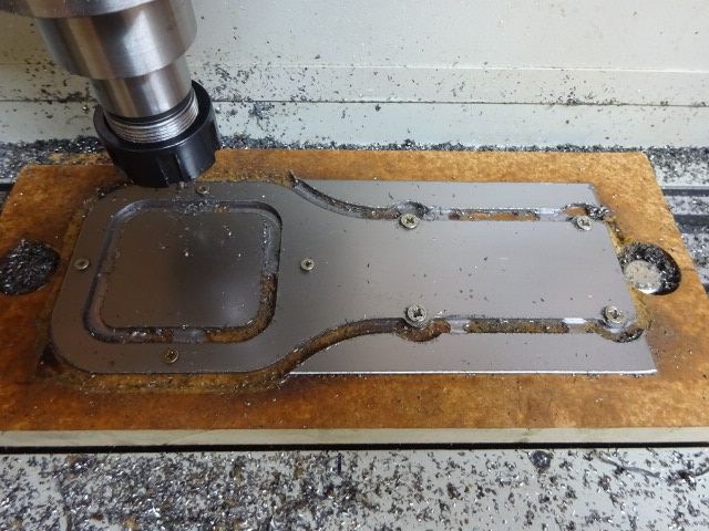

                                    I had a bit of time this afternoon so thought I would do the top plate, I did not air cut this time but did practice on some PVC before cutting metal.
                                    First was to drill 15No 2.5mm holes with a split point stub drill which meant I could get away without spot drilling first
                                    Then a change to a 6mm stub drill to open up six of the holes
                                    Using these holes the plate was screwed down to the MDF below and clamps removed. Using a 6mm dia 3-flute cutter but carbide this time the profile was cut, not a bad finish on the bottom of the first pass.
                                    All complete, the 6mm piloted holes that open out to the edge were enlarged to 8mm as part of the contour cut and I left tabs again to stop the waste flying about.
                                    After a clean up with the bottom plate that I cut at the weekend.
                                    I've stitched two videos together here, the beginning shows the first pass with the cutter at full width but 1mm away from the finished edge, second half shows the final full depth finishing cut, you can see the tool rise and fall where the tabs are located. the Upload to Youtube seems to have added some high pitch noise which was not there at the time.
                                    I could quite get to like this CNC lark, next part has been through the CAM and will let me try some adaptive clearing cuts!

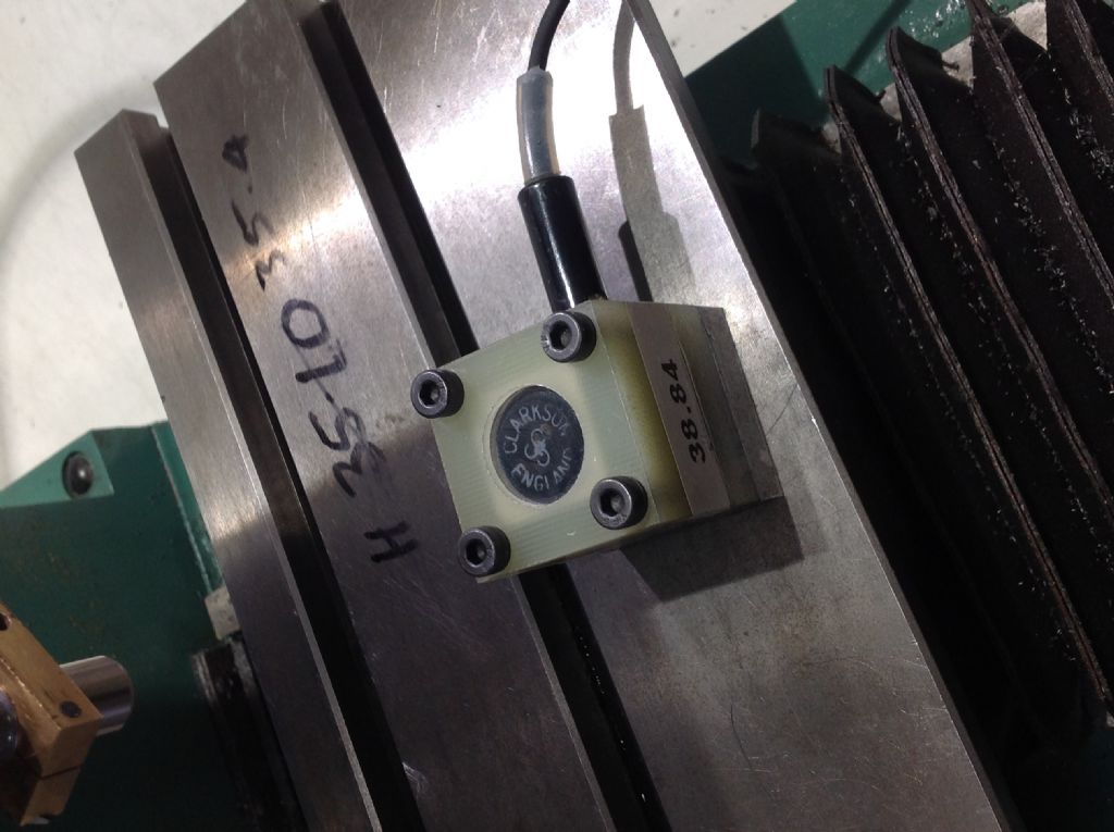

                                      I have very little understanding of CNC but I do find it fascinating. A question: obviously depth of cut is written into the programme but how do you set up the tool depth position in the first place once the tool is fitted into the collet (if that makes sense)
                                      #404421
                                      John Haine
                                        @johnhaine32865
                                        Ron, one way is to use a tool height setter that automatically sets the height to a known value.
                                        "Here's one I made earlier". This is a simple gadget with a TC button springloaded to be exactly 38.84 mm above the table, that fixes down with a magnet. The button is electrically isolated and connects to the probe input on the controller – when the tool touches the button "Z" is set to 38.84 and the tool retracts to 50 mm. You can also see in the chuck an edge finder that works in a similar way which can set the controller X and Y zero to the work edges, or find the centre of a hole, with high precision. Sorry the photo is on its side.

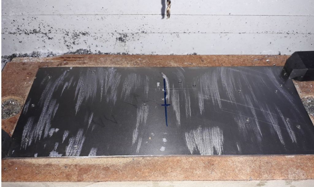

                                          Nothing quite so fancy here yet. I have just been using the 20mm edge of an ARC 10-20-40 block to touch off onto and entering the height at +20.

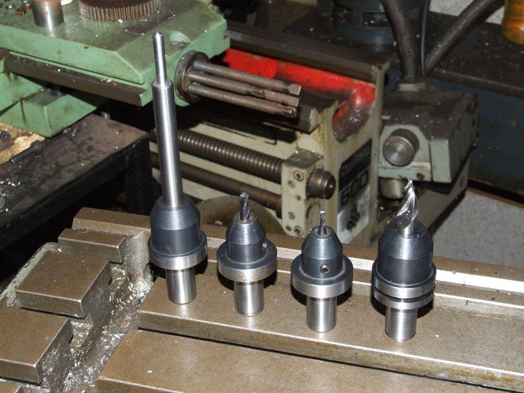

                                                In my early days of CNC I started off by touching off each tool and noting the offset. However, that got tedious rather quickly, especially when I forgot to type in the offset when changing tools.
                                                I now use a master tool and an electronic tool height setter. The master tool (tool 0) is simply a length of silver steel with a rounded end, on the left in this picture:
                                                The sequence is:
                                                • Touch off the master tool on the table and zero Z
                                                • Use the electronic tool height gauge to measure each tool against the master tool and automatically fill the tool table. Measuring each tool is a one button push on the screen
                                                • Touch off the master tool on the fixture or work, depending upon where the zero height reference was set in CAM
                                                • Set X & Y zeros
                                                • Start machining!
                                                Andrew
